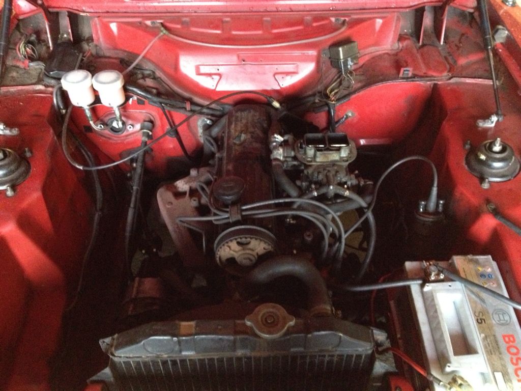

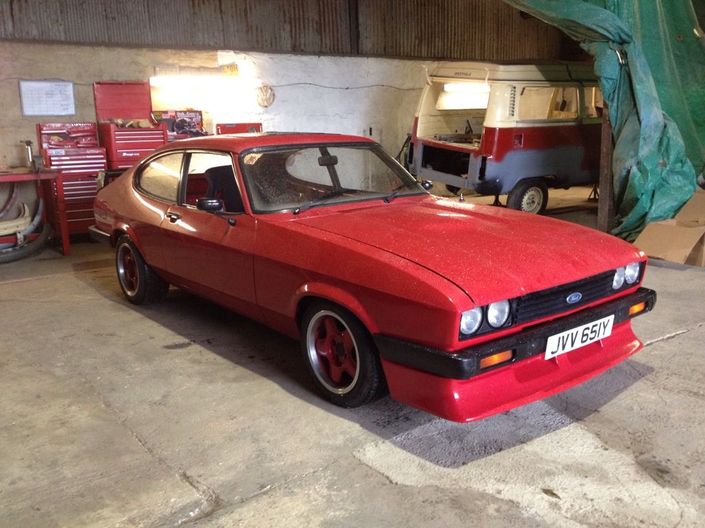

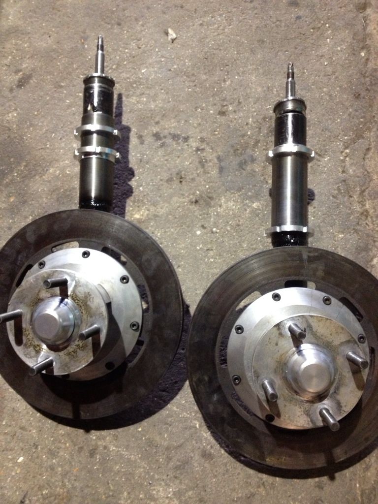

Thought id share this with you guys as its kind of race inspired.So this week I've been working on something a bit different to the usual rusty vws I seem to get in. My friend always had capris when we were younger and used to go cruising round local towns. He took a break for a while but got another Capri last year which I did some metal work on. Well he came down this week with a but of a crazy plan. 5 link rear suspension, convert the front struts to coilovers and fit a great big 4.8L Chevy v8 (LR4) with a 6speed manual dodge viper gearbox.
Wheezy pinto

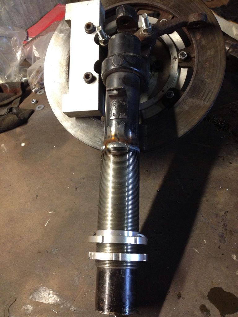

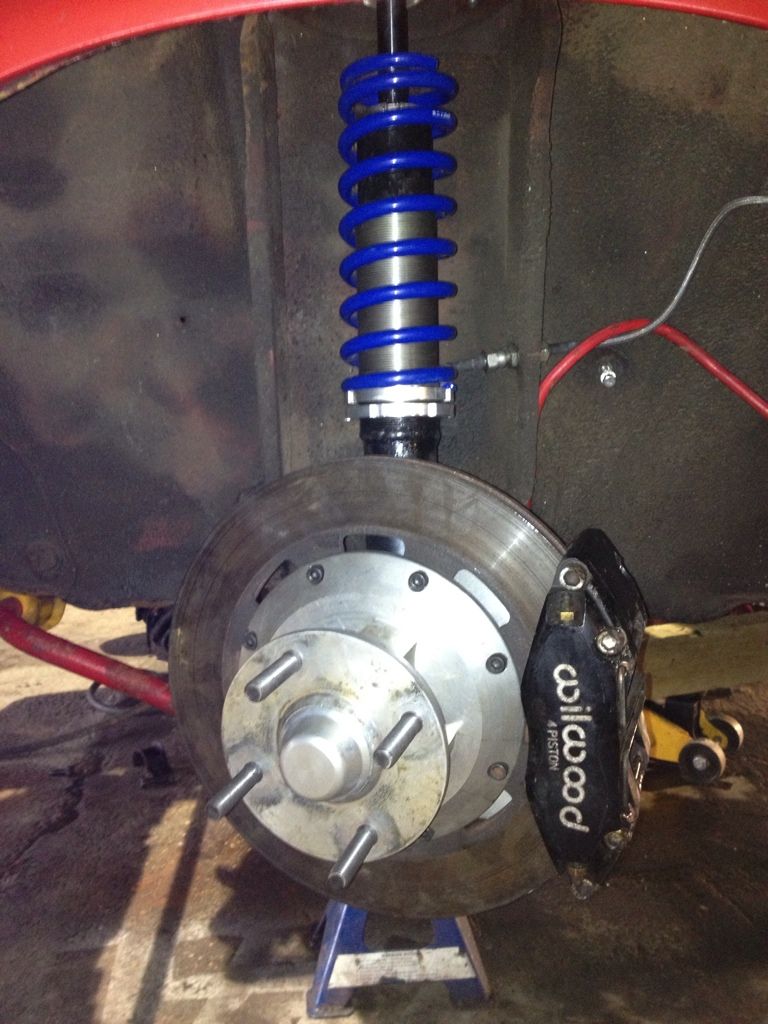

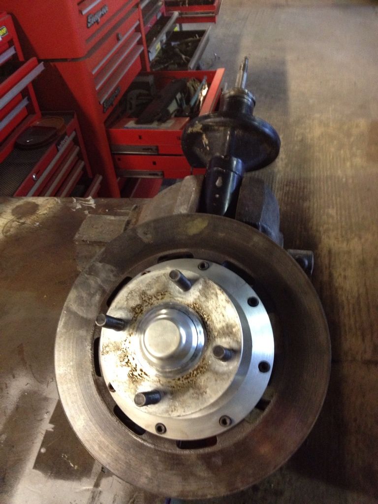

Strut off, bottom cup needs to be removed

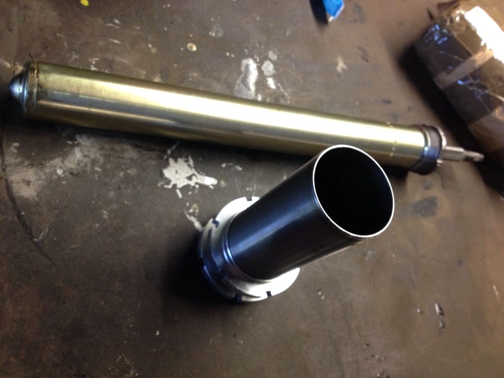

Conversion tube and gaz insert
Conversion tube welded in
Both done
Fitted back up

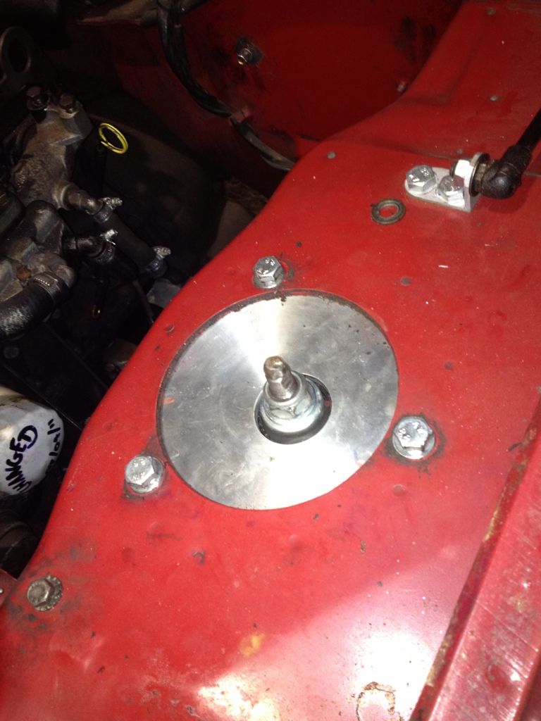

Adjustable top mount

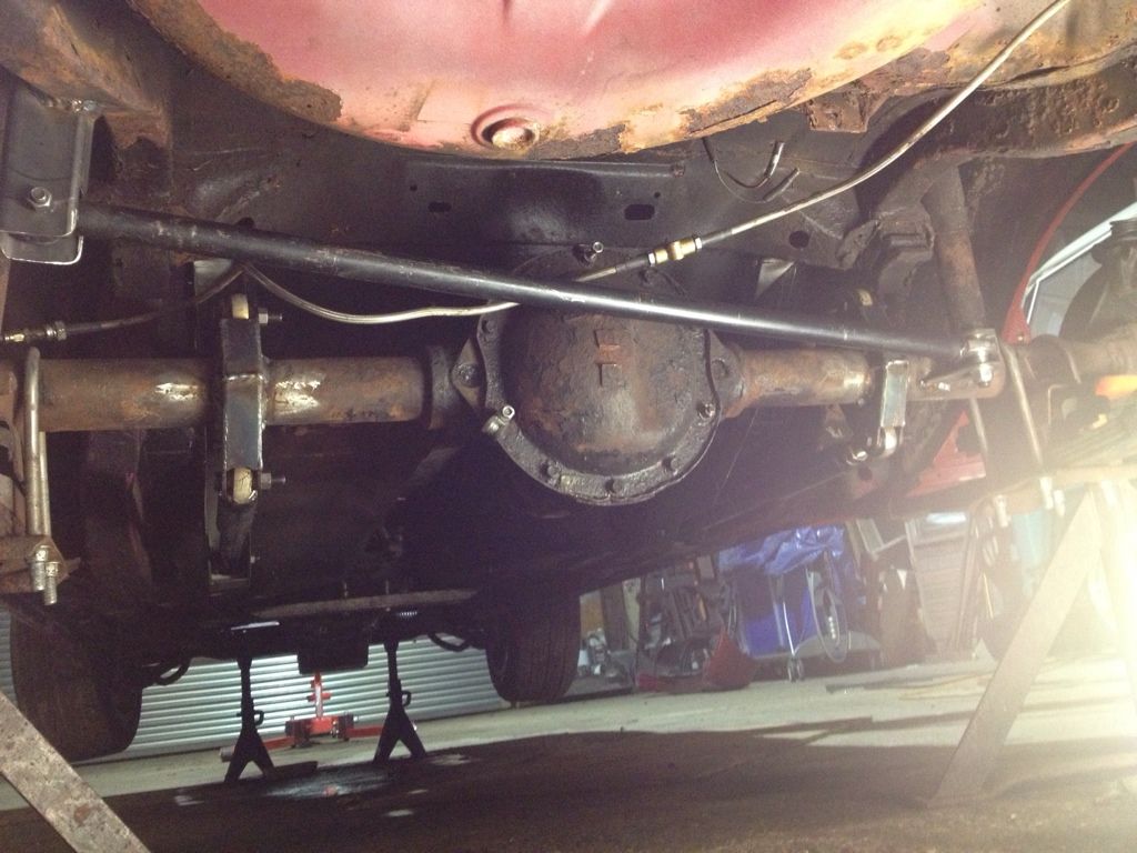

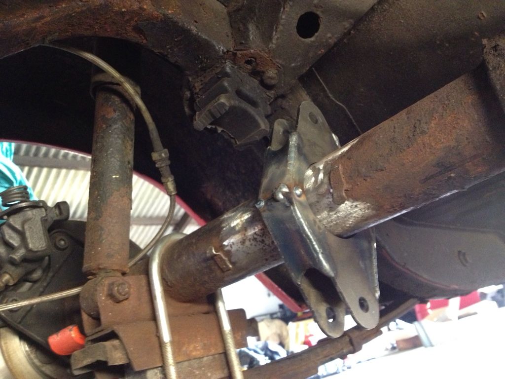

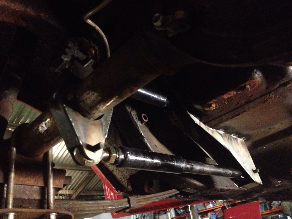

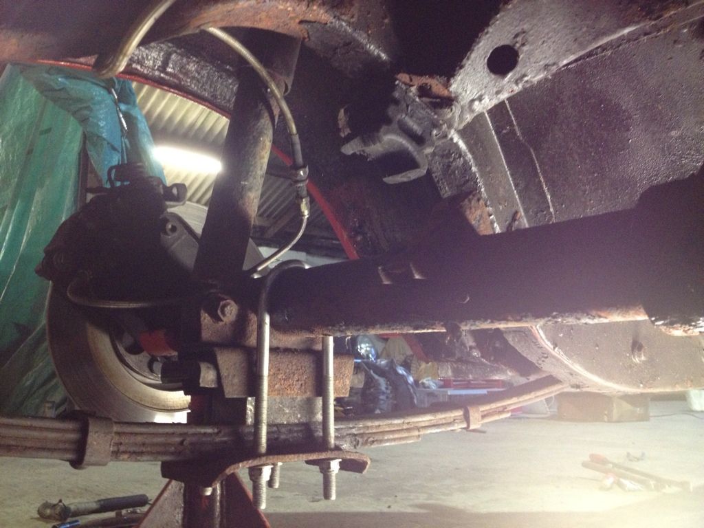

Onto the rear then. These anti roll bar mounts need to come off
4 link brackets tacked in

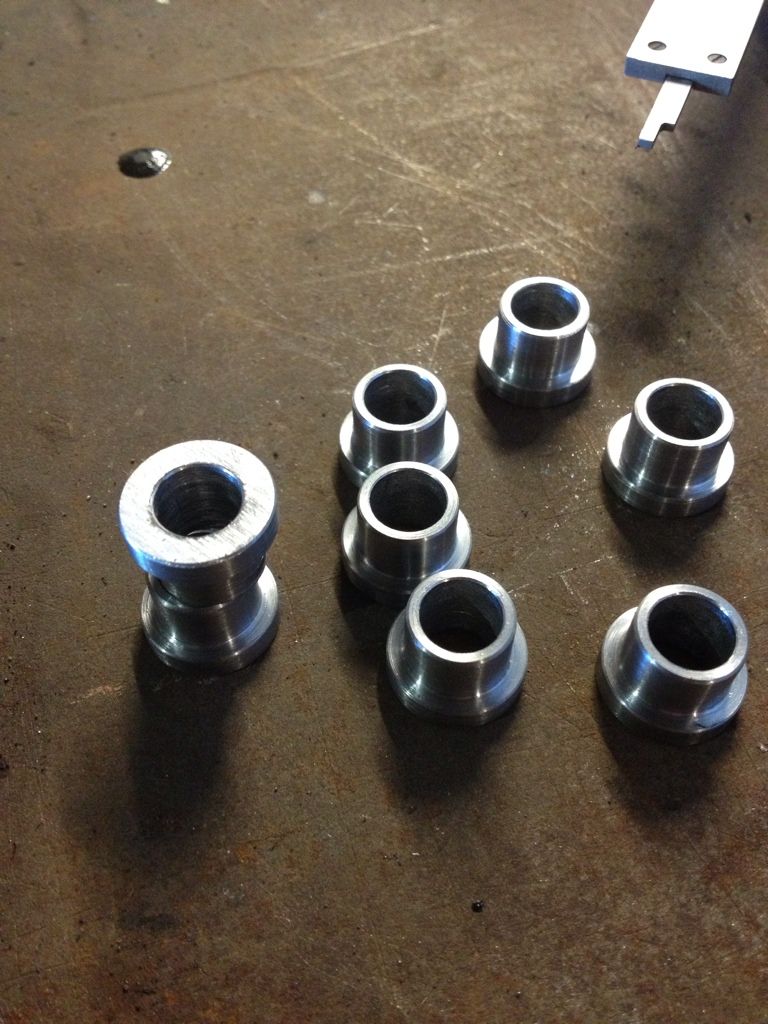

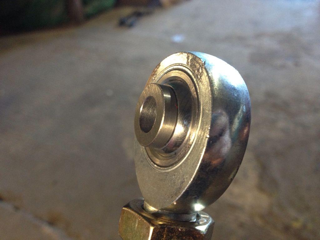

Had to get these bushes made for the rose joints

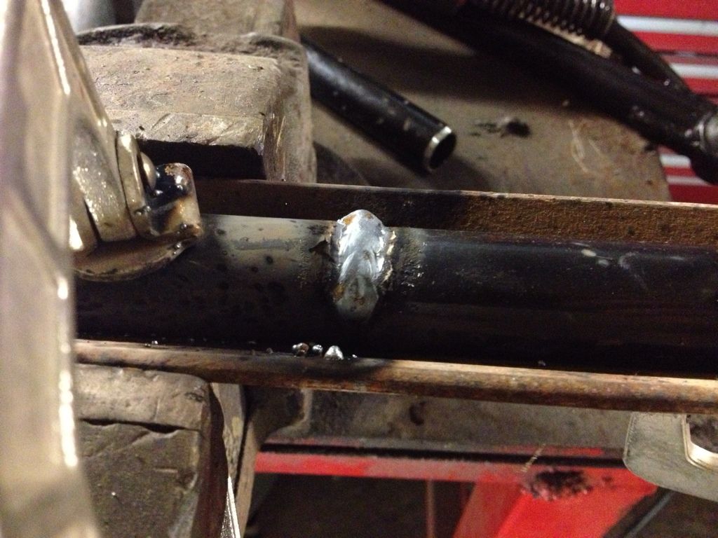

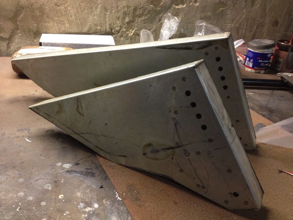

The kit is for an escort so the rear boxes need a lot of trimming

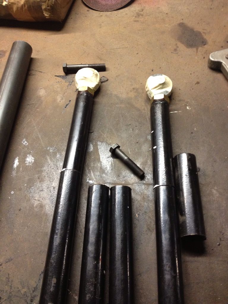

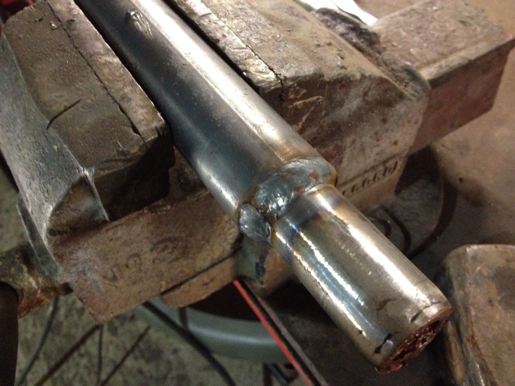

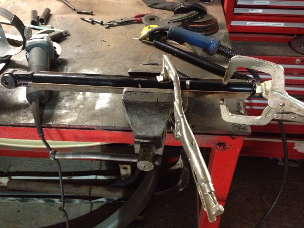

Rods need shortening too
Sleeved for strength

Boxes welded in

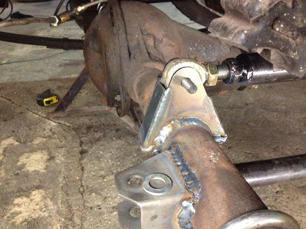

Rods bolted in
m
Brackets fully welded including panard bracket
Panard rod fitted
Coilovers fitted

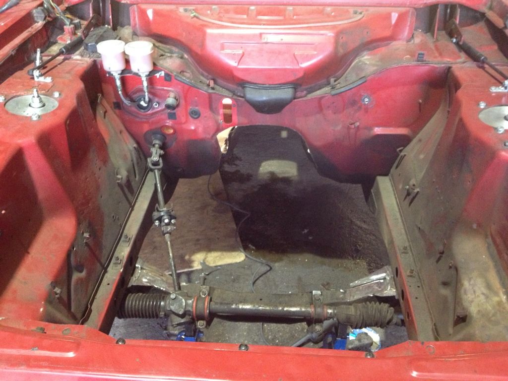

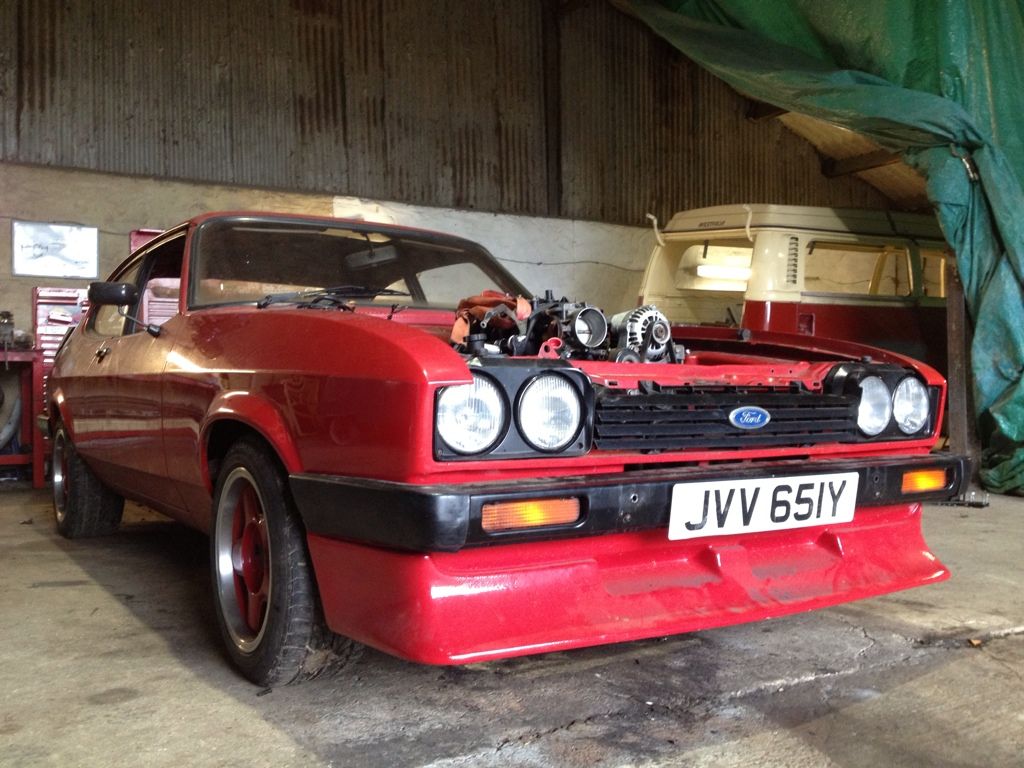

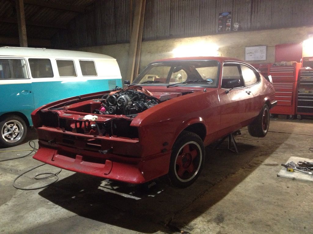

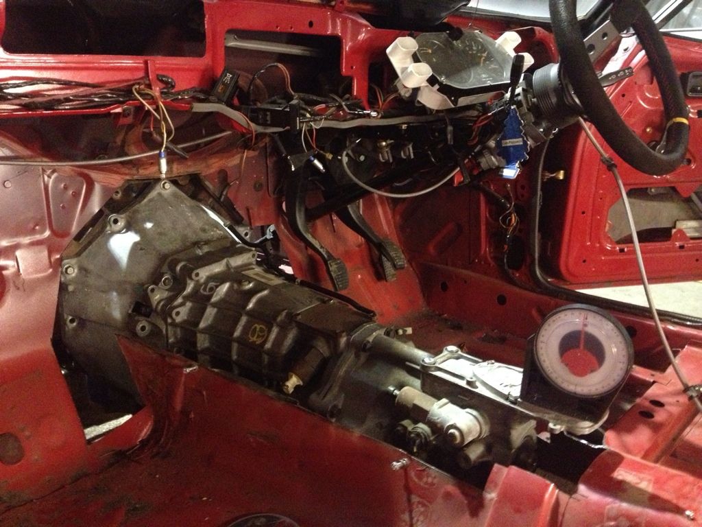

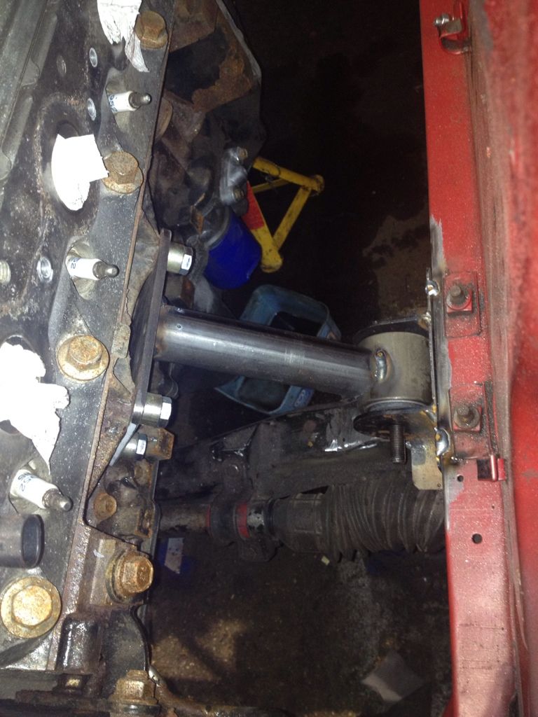

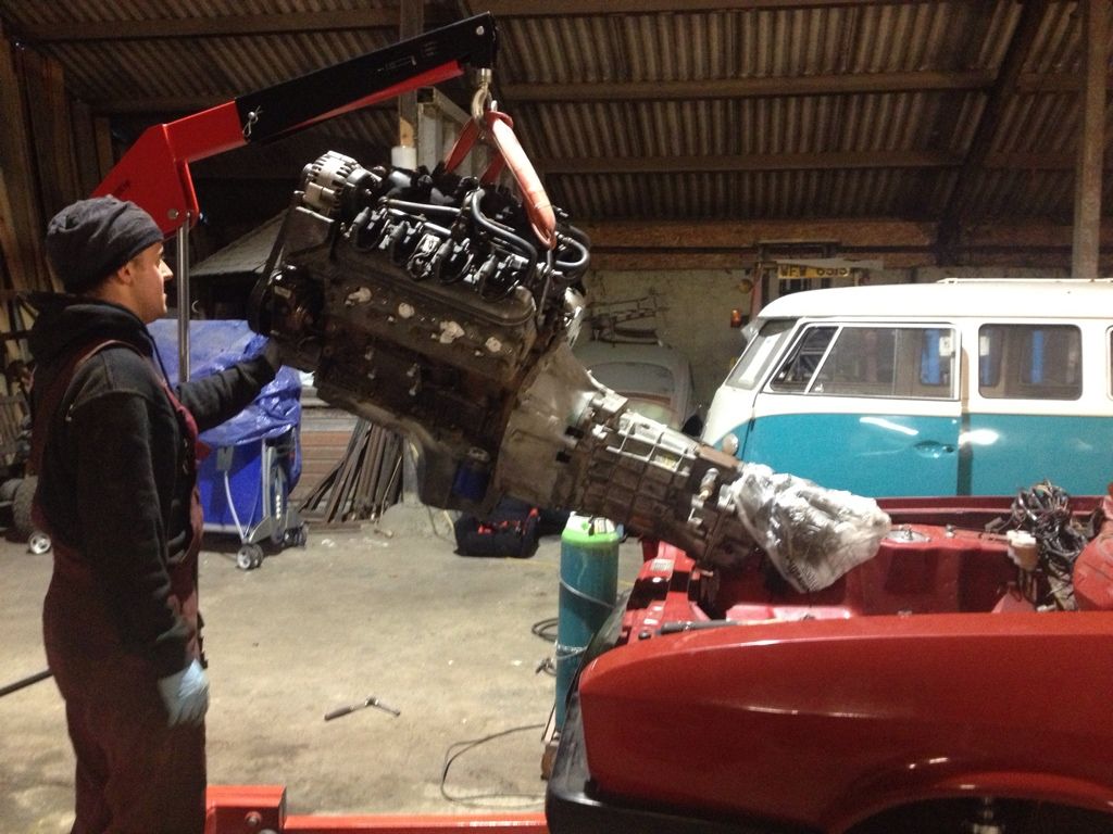

And on to the engine. The 1.6 pinto was removed and engine mounts removed from cross member
Battery tray and radiator mounting panels were removed for space

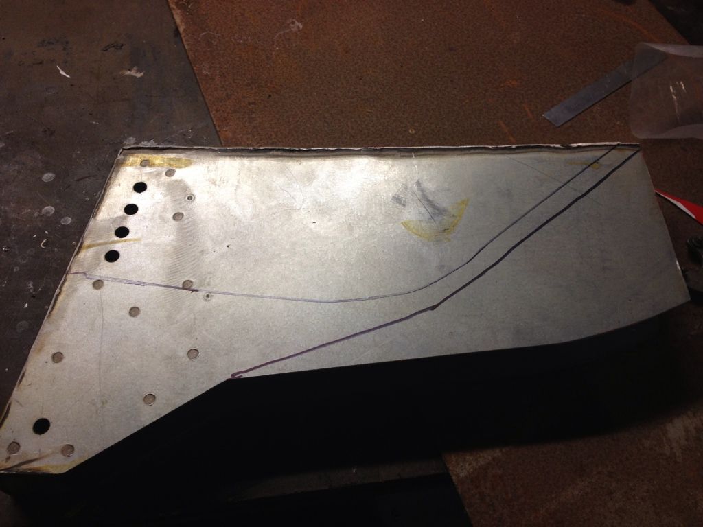

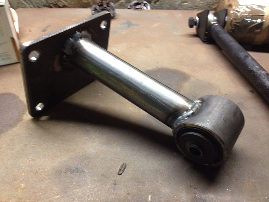

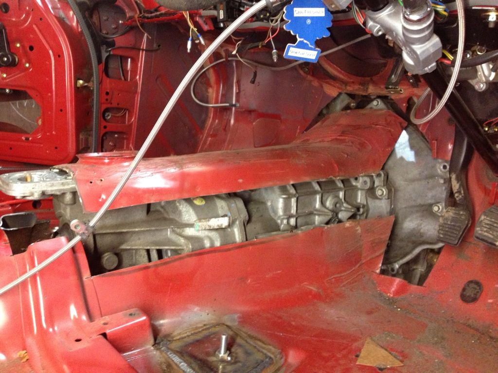

Started chopping the tunnel and bulkhead out.....this hole got bigger

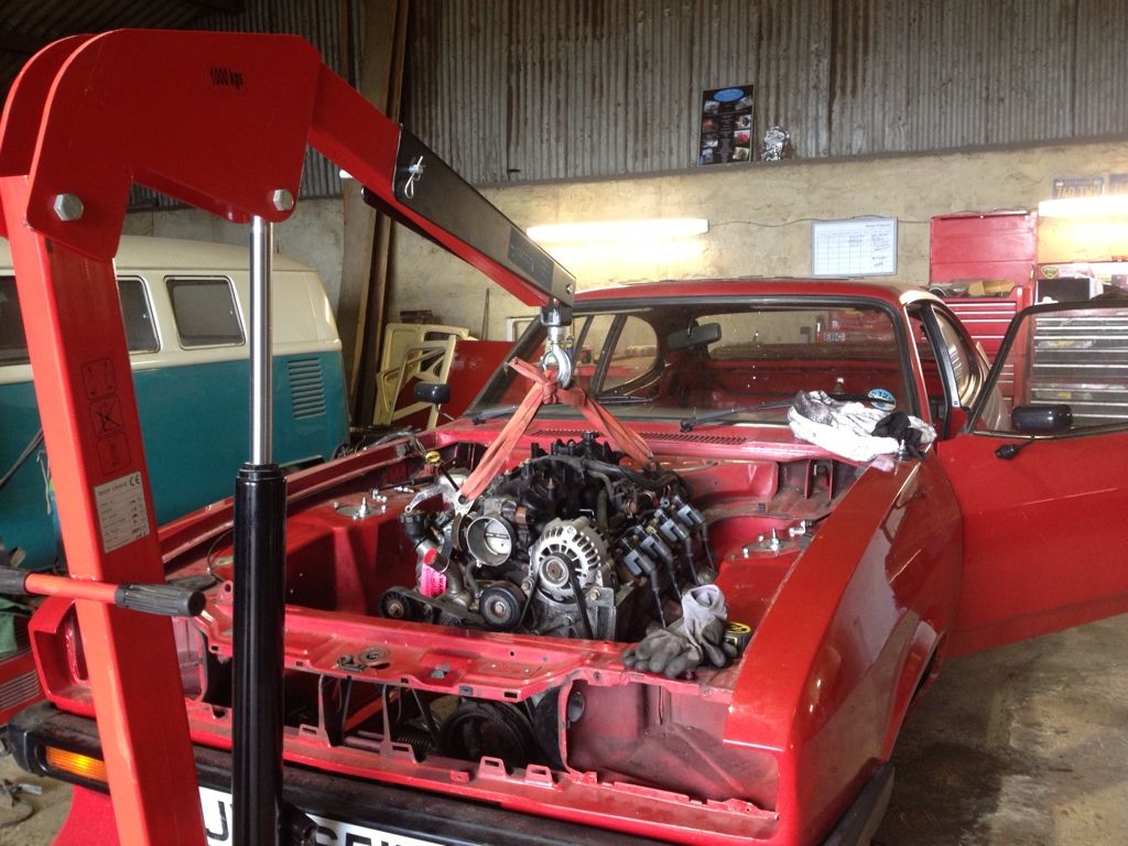

Trail fit with bell housing fitted

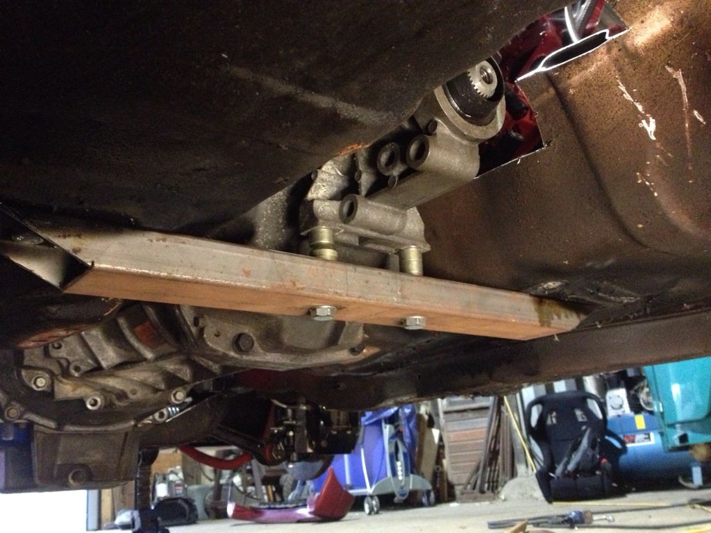

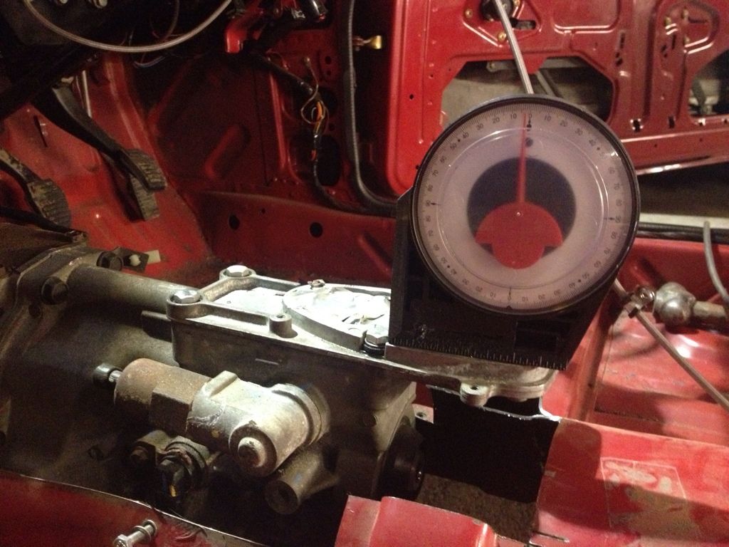

Next we attached the gearbox and levelled the engine/box combo up
Huuuuge
Tacking the engine mounts together

All welded up
Mocking up the gearbox mount with spacers. A proper mount will replace this now we've worked out the height it needs to be
Love that huge throttle body
Still have to stitch the tunnel back together!!

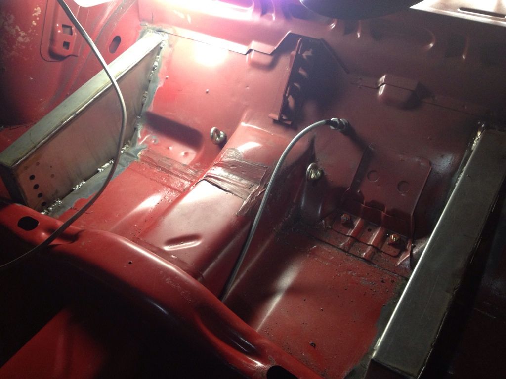

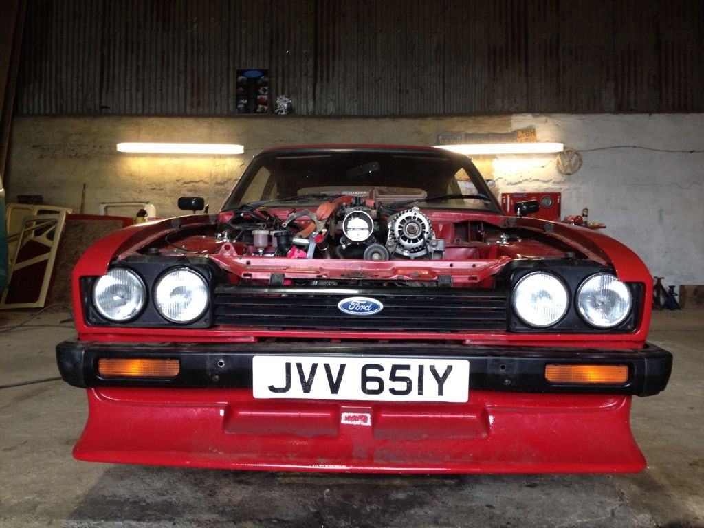

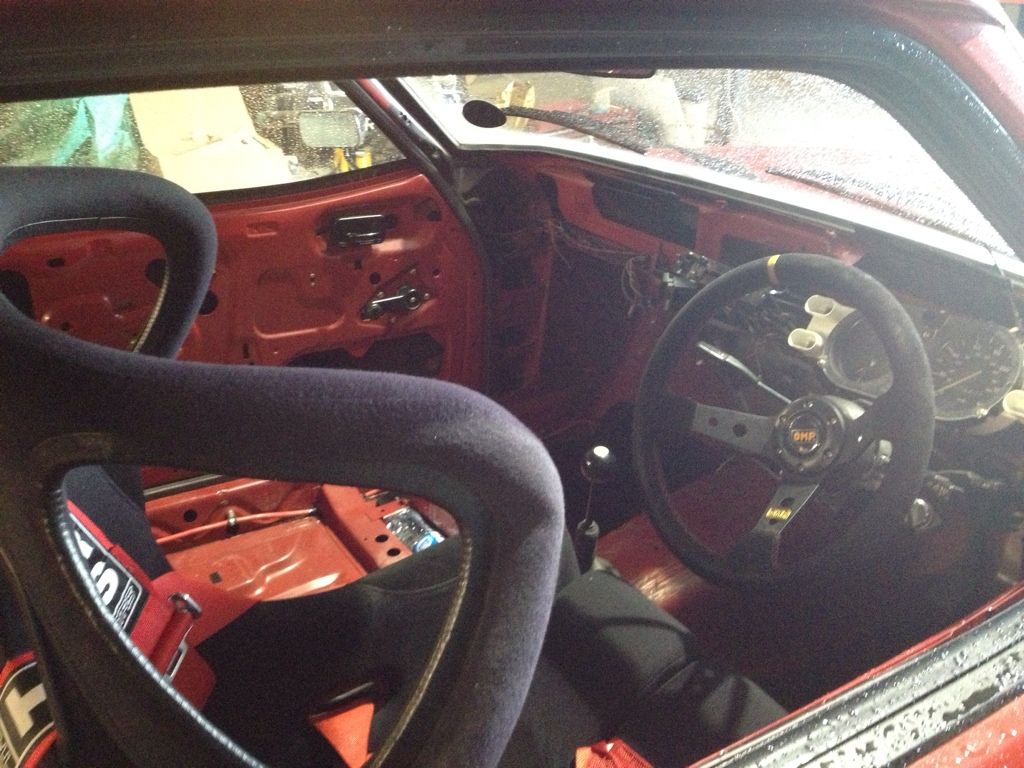

My work is now done. I welded in a brace for the panard rod mount, welded in a rear strut brace/harness mount. Welded in some seat bars. Fitted flywheel/clutch and custom prop. Raised the tunnel by 4 inches and finished off the bulkhead. Also, rob decided to go with an LS1 inlet manifold, alternator and waterpump.....which drops the throttle body by 4 inches. unfortunately he decided this AFTER we cut a ****ing huuge hole in the bonnet to make a bulge!!!
il get some pics up when ive uploaded them!!
the car is now heading back to Rob's for him to install the hydro clutch, cooling and fueling system. Then it's time to rock

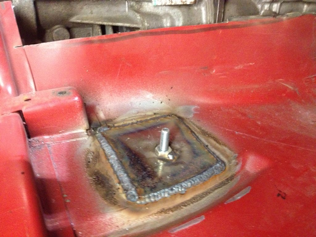

brace for the panard rod bracket

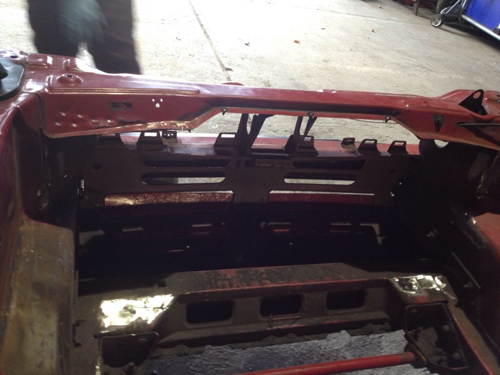

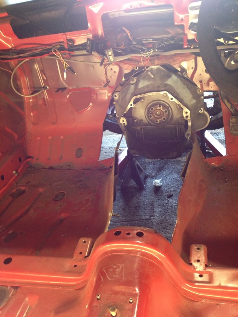

raising the tunnel by nearly 4 inches! Didn't just want to box it in - wanted to try and make it look as factory as possible
seat bars going in
rear strut bar/harness mounting bar also welded in
water pump/housing/alternator mount and bottom pulley all changed to allow the shorter inlet manifold. everything will now sit under a stock bonnet - this thing is going to be a real sleeper
so thats me done on it...the car is now back with rob....cooling/fueling systen and wiring left....cant wait to see it on the road!

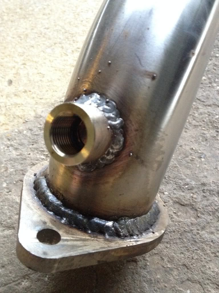

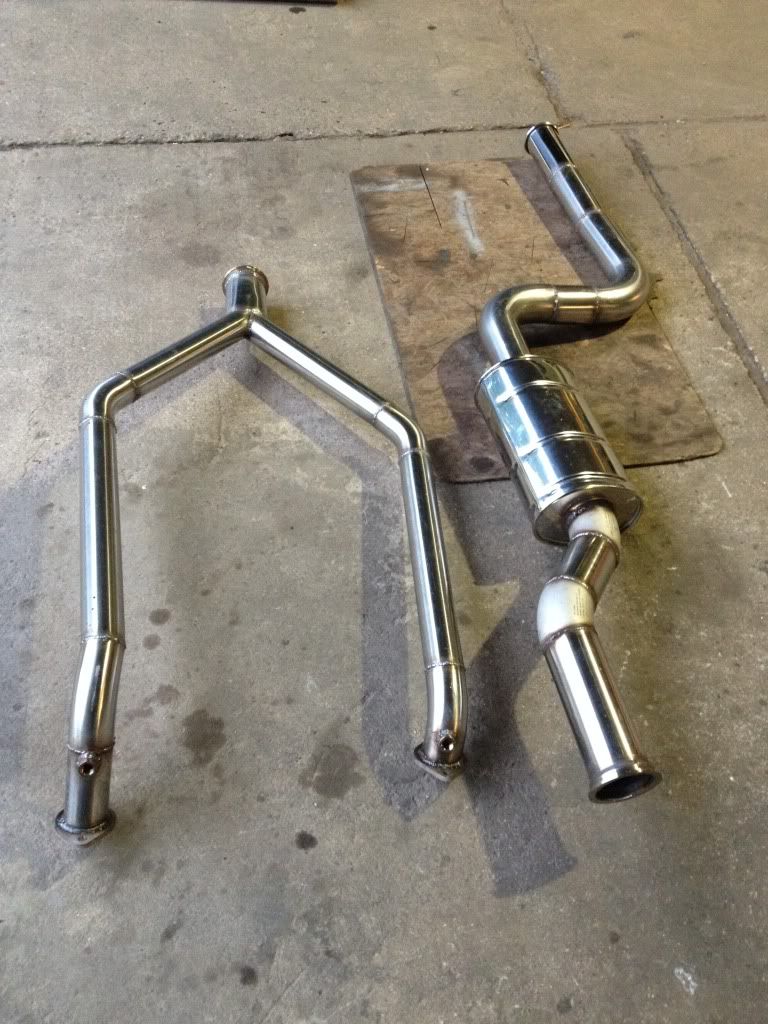

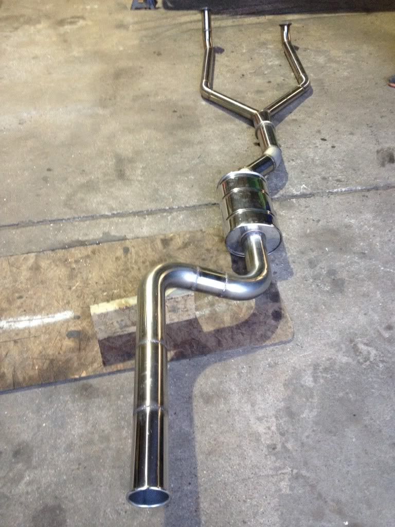

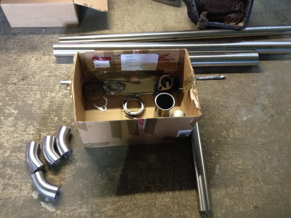

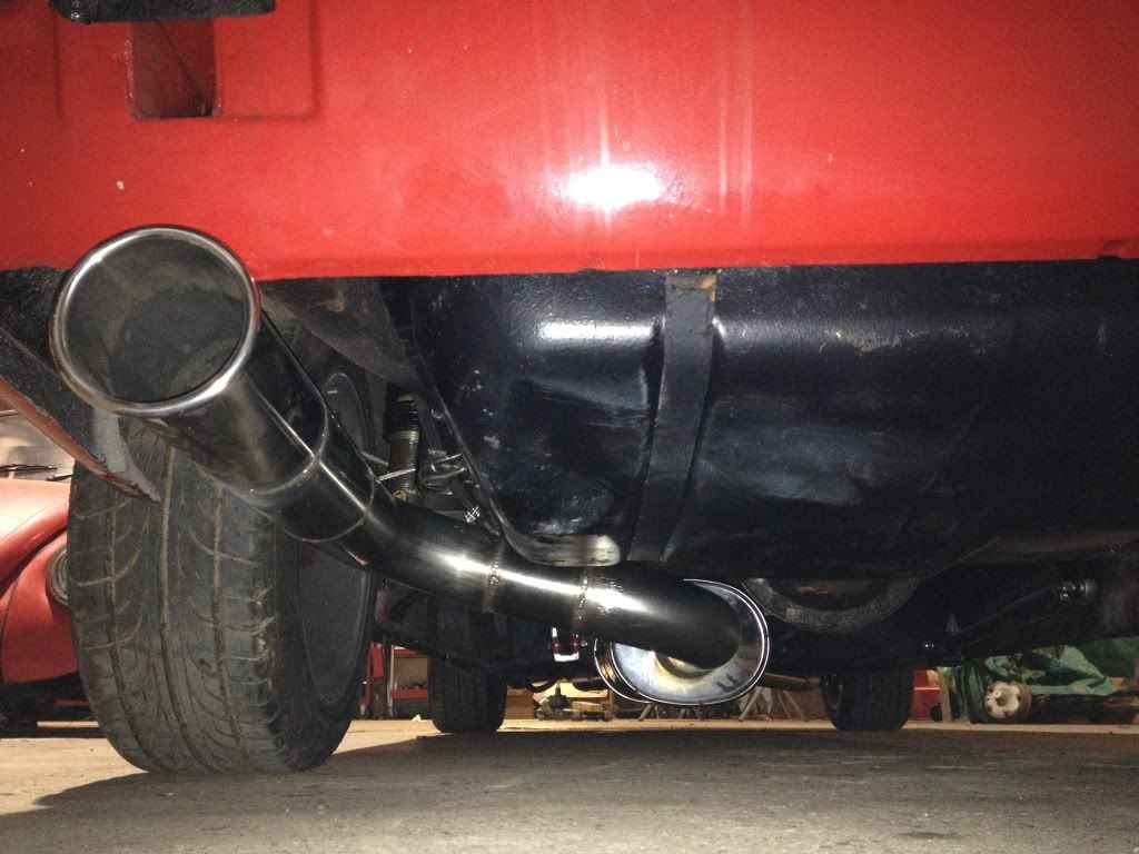

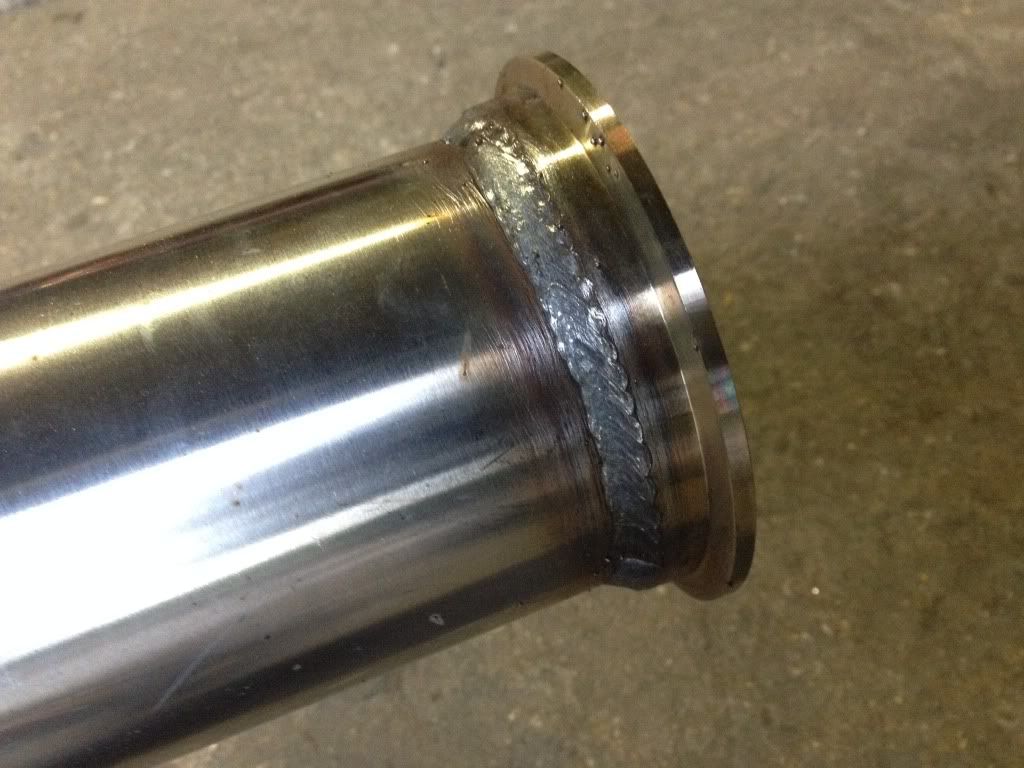

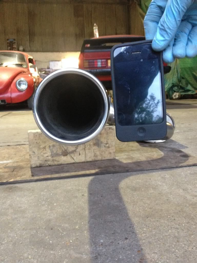

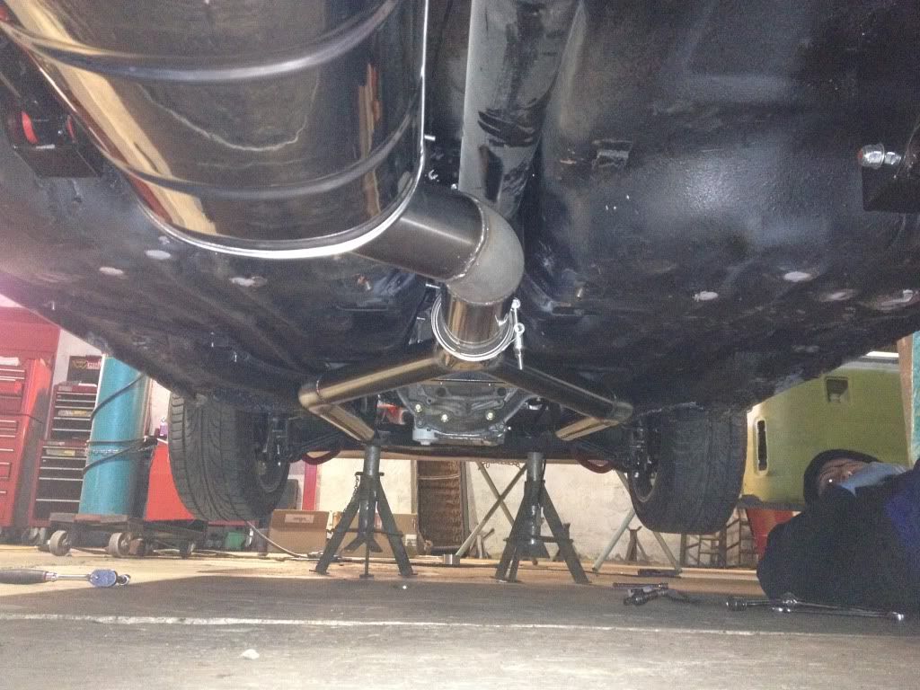

So time for another Ford update. Rob was having difficulty finding a reasonably prices exhaust fab company....he was looking around the £2,500 mark for a set up....so i suggest we fab'd up a system for him. Next thing i know he's turned up with the car on a trailer and a load of stainless tube
One box and some tube

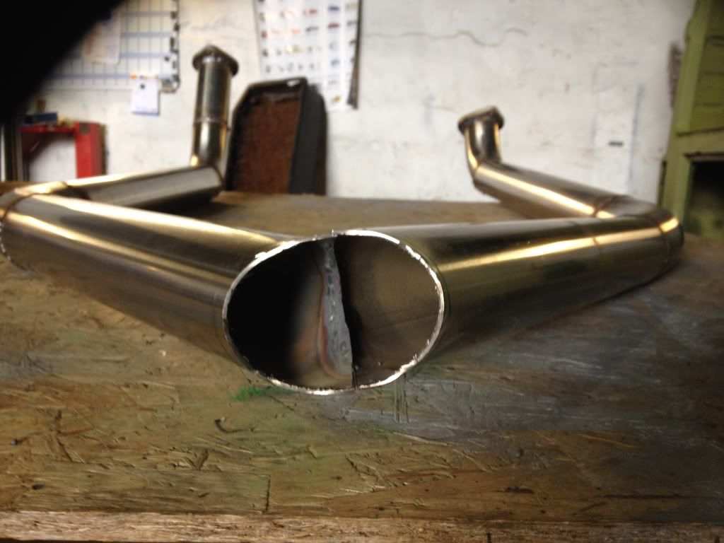

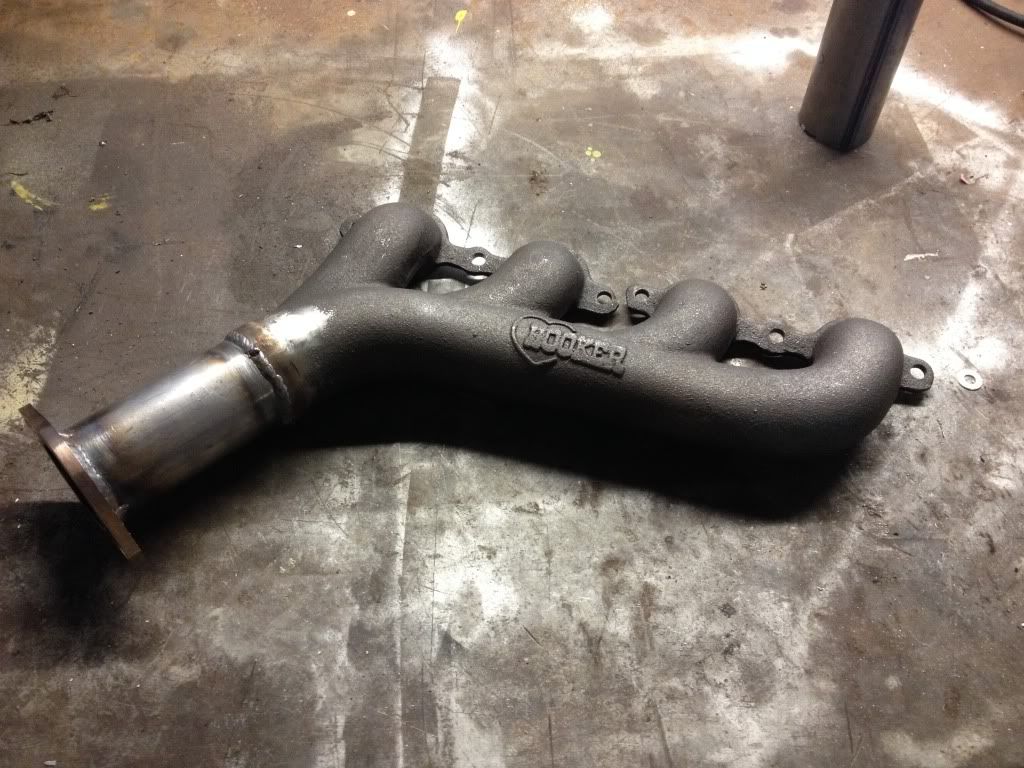

Had to modify one of the lovely new manifolds to clear the steering column/starter motor
After making the full system, we cut it in half and welded on these awesome clamp ends. i've not used them before but i'm well impressed!
That's 3 1/2 inches!

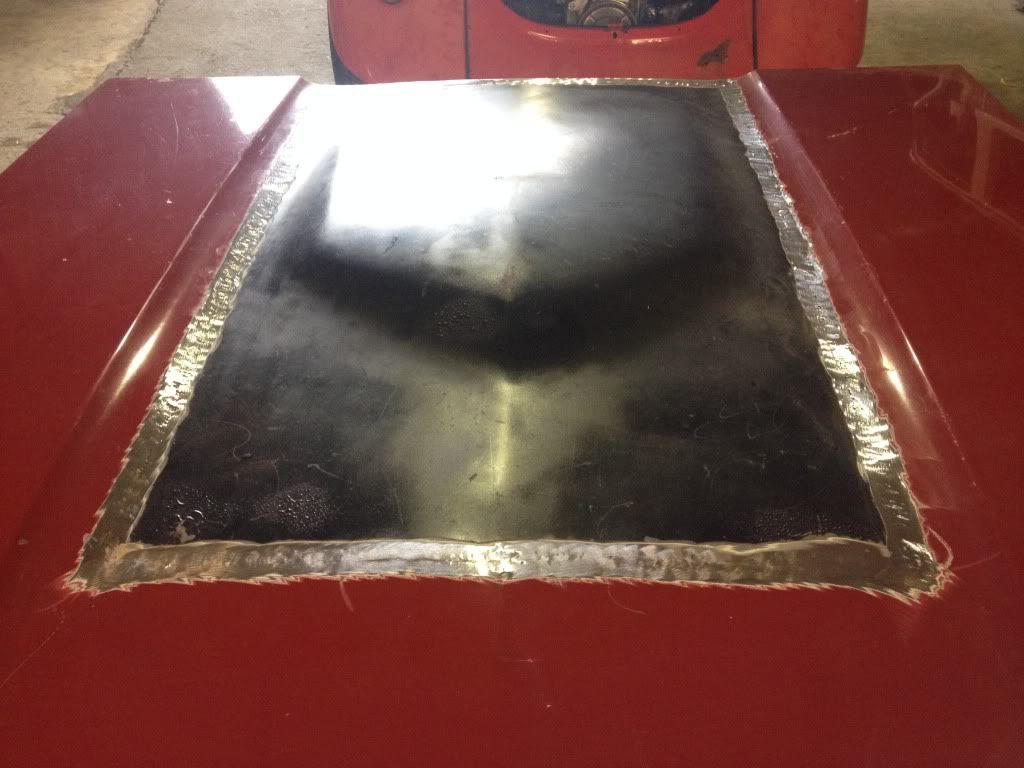

also welded up the hole in the bonnet!
Hoping the new fuel reg will turn up in the morning, need to prep and paint the bonnet and set the tracking - then MOT time
just uploading a short video of the engine running
