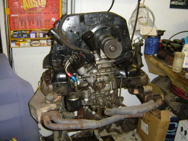

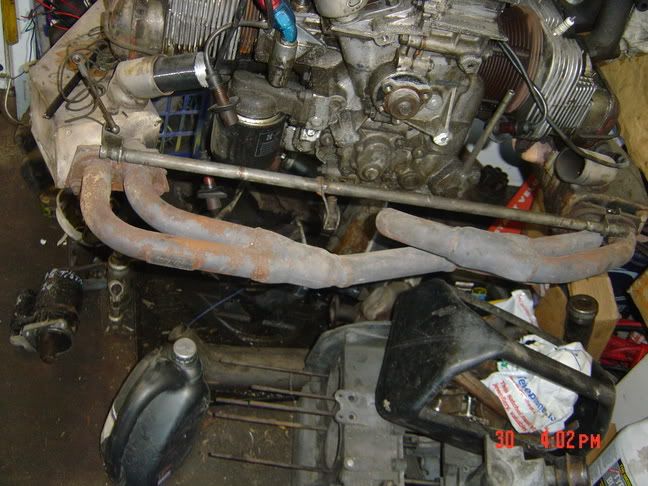

heres mine on my 2L t4 thats in my sbug. i started with shortened kombi heater boxes which attaches to a modified kombi extractor which has been adjusted to fit and finishes in a tuck away exhaust. the whole system is 1 5/8".
