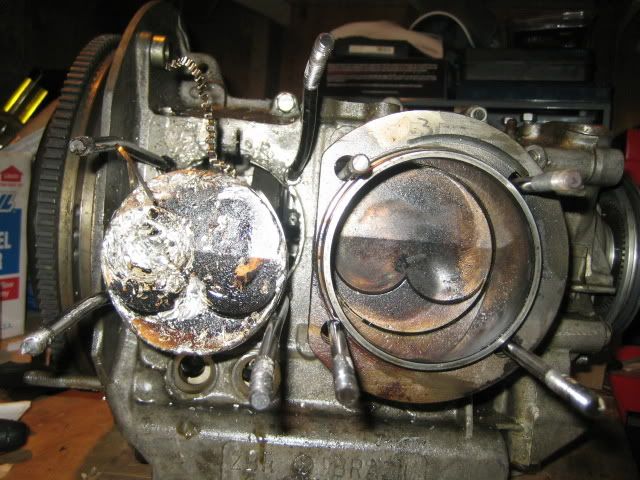

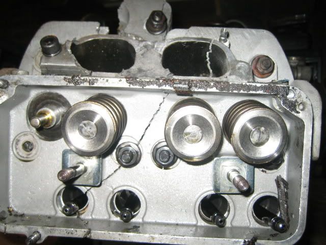

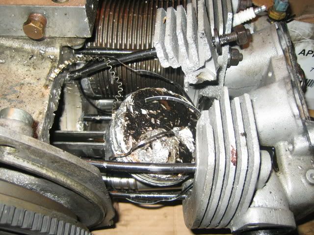

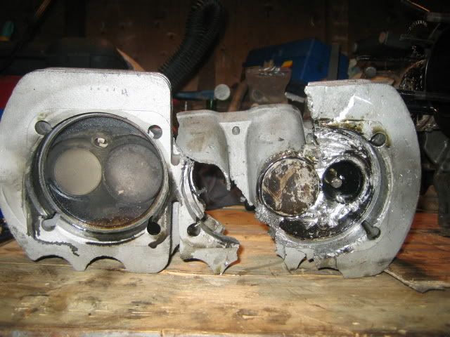

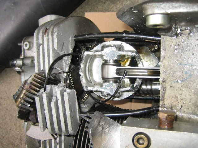

Took it work on Monday (night shift), planning for it to be the last run before putting it away for the winter. Had fun taking the country roads out of the city, taking some incar video running the HID's. Well, in the morning on the way home, took the scenic route once again. Just as I was near my house, figured what the hell; take it for another blast down just around the corner. So I make the right turn, open it up, break her loose, feather the gas around 6-7500rpm. Feel for traction, shift 2nd, and then it happens, a hollow exhaust note coming from my oil tank on the rear shelf. I let off, and just as i dump the clutch, the motor lets go. What a terrible noise! High pitched metal on metal. Shut it down; look in my side mirror see some sparks on the pavement. Roll it into a parking lot, reach under with the camera and take a pic. Lots of oil dripping down, and can see the #3 rod and piston facing down. Argh.... completely destroyed a cylinder.
So I walk home, what an empty/lonely feeling. Pick up pieces of barrel, spacer, and a spark plug off the road. Grab the towbar and pull it home with my Golf TDI. Pushed it into the garage and went to sleep. Left it alone for a couple days. Woke up today thinking, i could salvage it. Have collected a few spares over the past years, so with a new Wiseco, barrel, some studs, tubes, probably use the AL Pauter rods sitting in the closet, repair the chamber; could get this back together over the winter. So back into the garage to take a closer look. Looks pretty bad, the head is split, and so is the intake manifold. So now i'm bummed. Now after 6yrs, the stock motor/tranny will be going back in.
