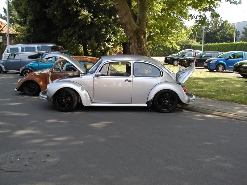

you will also want to lower it a lot, here's a pic of my project with 18x8.5 in the front and 18x10 in the rear on stock suspension at the moment and with widened fenders.

I've seen some bugs with 18s and they just don't look right, thats only my opinion other may love that look. Tyres and ride height too tall, the cars end up looking like a kids Hotwheels toy. Wallys car looks right with 18s.
I think that you will need wider fenders.

it is possible under stock fenders but you need to install the coilovers with small springs... I have the 18 x 8 Porsche Rims under the stock fenders..
