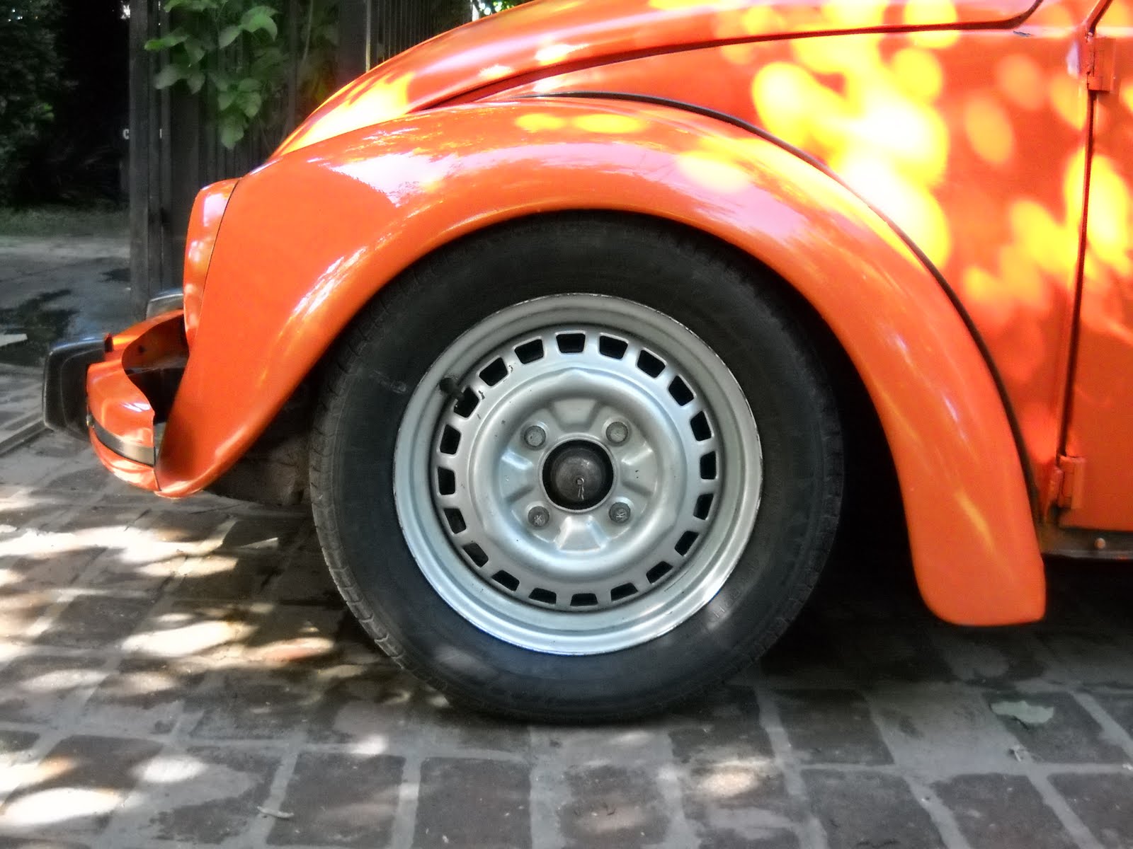

15x7 Cookies have a ET 23, they will work fine the rear, 7s on the front will be an issue as they stick out more. 15x6s with ET 36 are better choice for the front.
This is an old 1300 bug I used to own with 6s & 7s, they fitted nice.
