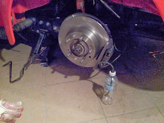

November
Fitted the missing brake lines, hand brake parts, rotors, drive shafts, finished the berg style mid mount and the whole oil system with all the fittings and consoles

leaving the workshop
in the garage
next day
fitting the rear calipers
merry xmas
