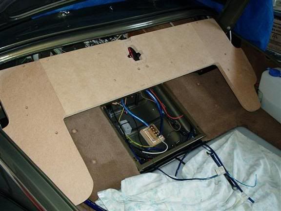

Anyway, now a few of the shows are over for a little while (picked up a number of awards which was great), got to get back to installing the Audio System F4-500 amp. The amp rack had to be redesigned for the new amp - mdf platforms will be used as a base for cover pieces to hide wiring etc.
Steel frame will be used to mount mdf skeleton over which fibreglass will be laid for some nice curves. Power distribution block and crossovers will also be integrated (still to finalise that part of the design!).

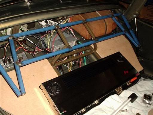

A little more progress on the amp rack - steel frame is tacked together (welds will be finished later) which will provide the base for mdf skeleton (over which f/g will be laid).
The piano hinge will allow access to amp controls and wiring (additional mdf will be used along with more f/g to tidy up the hinged cover piece).

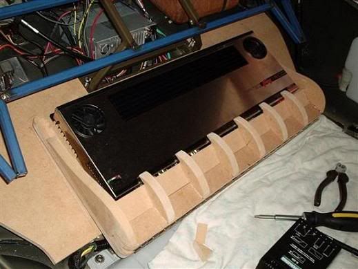

As is usually the case, plans have changed as I have progressed with the construction. Originally the little rounded skeleton pieces were going to be used as the frame over which fibreglass would be laid - however as I trial fitted them up I kinda liked the exposed look.
So I decided to use them as a highlight and add thin mdf to the inside to cover the amp controls and power/ground wires etc. The piano hinge allows easy access to the controls/fuses. The MDF will be painted in body colour with some carpet underneath.

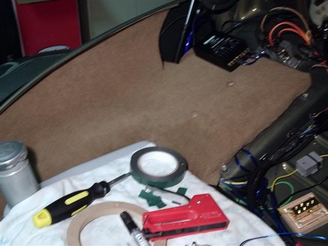

Started sorting out the carpet surrounding the amp rack etc - photo is pretty blurry but you get the idea. It will be all tidied up once the rack goes back in place (which will cover the dynaudio crossovers as well).

Managed to finish up the carpet around the amp rack - not perfect but tidies it up quite nicely. Windscreen washer is finally hooked up and working.
Wiring from crossovers to splits is done (just have to wire amp to crossovers) - 1/0 gauge power cable will be routed to stinger distro block (to be mounted at top tier of rack in centre). 4 gauge will be routed to amp, and second run to small unfused distro block to provide power for the HU, and neon/s.

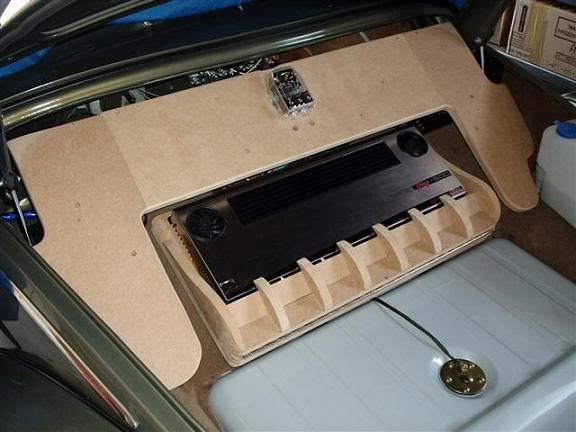

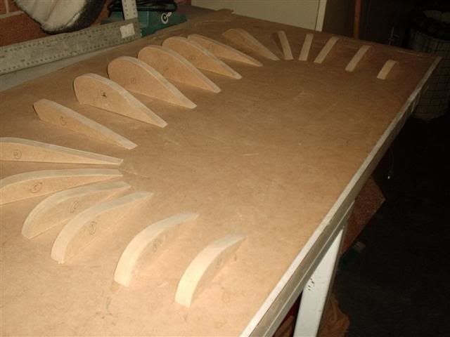

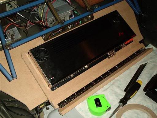

Hey Troy - cheers mate. The amp is an Audio System F4-600 Twister series. It can supply 2 x 460W RMS @ 4ohm - here is a link to some details:
http://service.winnet.it/Gttrading4/easysite/scheda3.asp?livello=3&Marchio=Audiosystem&Gamma=Tw ister&Modello=F4>600&pg=1
Well, as if you hadn't figured already, this sort of thing takes a lot of time!
First the base for the top tier was cut from mdf and edges routed. The hole up the top is just to provide some back lit illumination through the plastic Stinger distribution block (from underneath the base).
Second pic shows the amp and its ridged cover plate (hinged for access to amp controls), along with distro block in place.
Last pic shows the 'bones' which will form the shape of the upper tier - these will be secured in place via hot glue then fabric stretched over them to which the fibreglass can be applied. Hopefully more to come soon.
