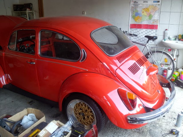

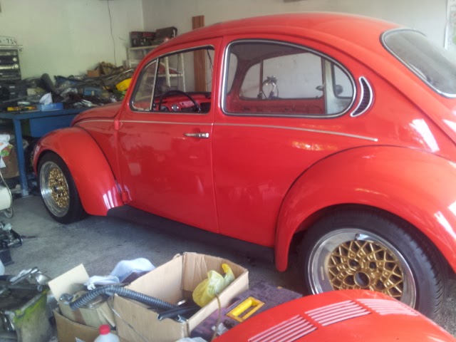

leaving the workshop
in the garage
next day
fitting the rear calipers
merry xmas

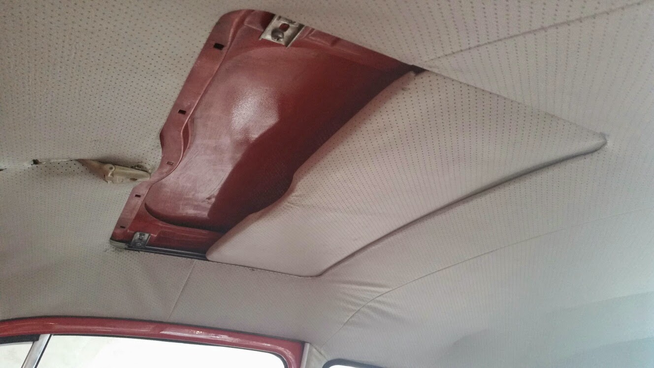

Sunroof is installed, works great.

Sunroof seals glued in:
Put together:
And adjusted:
  #90
