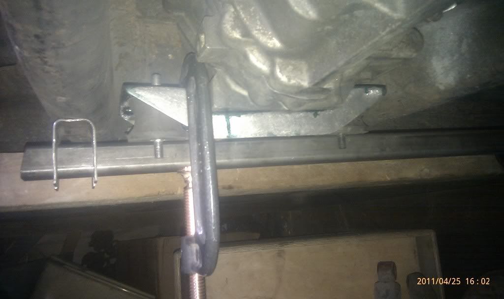

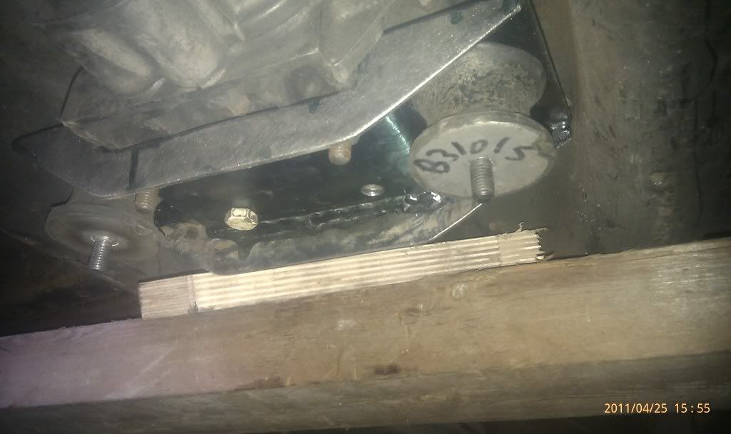

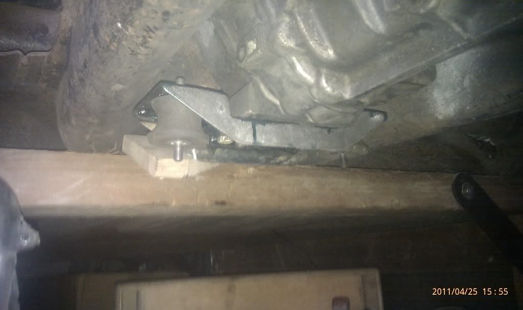

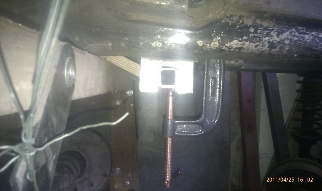

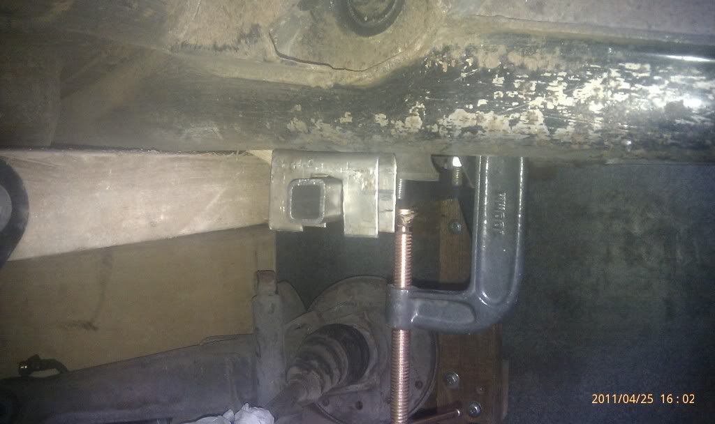

New gearbox mount in early days of construction...
Here is my weekend's weldings....
now awaiting some more box section to make the end brackets - replacing my mocked up bit on the end of the 25x25 box.

I know it's a bit late, but the torque reaction on the trans at the front has a lifting force which is considerably greater than the static weight of the assembly which is why they are normally done the other way around...

Hi Ricola,
I did read that the nose cone lifts on dropping the clutch, but rarely trust all the internet stuff i see.
Thanks for the comments, I did over think this a bit and was trying to avoid putting the bushes in tension, which with lift i guess i will see on my bracket / bobbins. I have always planned on running the T2 engine brace bar to eliminate this affect - always seems odd that VW never fitted one, but i guess on 50hp not necessary - hence why i opted for the design I have.
In your experience, would you be overly concerned with the set up including the rear brace bar? I would expect this to reduce the moment on the trans, but the force at those mountings would be pretty high too i imagine.
I do note that the Bug@5speed chaps and porsche seem to use a doghnut type mount with a steel sleeve in the centre meaning they must have shear in the rubber, I see this is the type you are using on your bar.
Any feedback welcome on experiences
Jon
