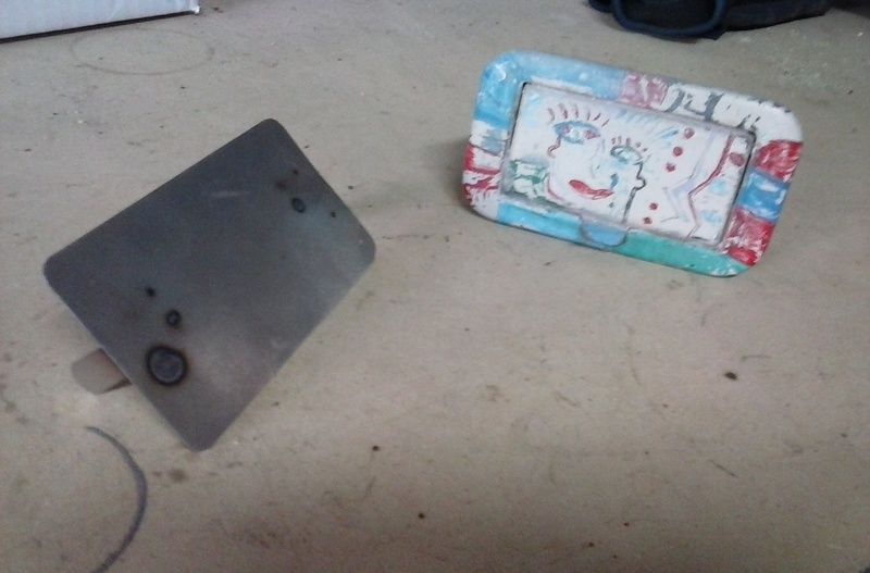

Yeah, I know what you mean. I do a lot thinner metals and I hate how hand shears distort the piece along the edge. I was able to do most of this weird piece on the machine. Weird angles to weld at and a shot of the piece in place before I grind the welds down smooth.
I really like straight lines, bends, and cuts when I can do them. A glove box delete panel I made for my truck.

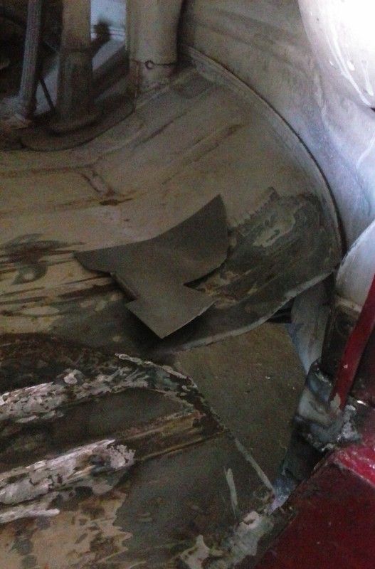

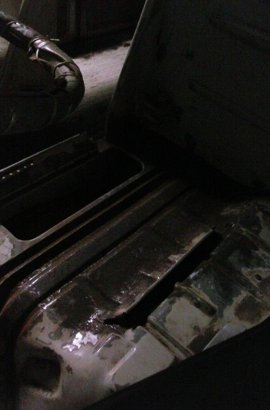

Doing a lot of grinding and sanding prep. in the inside cab. area getting ready to paint it. Some water was collecting under the drivers' seat and made some surface rust.

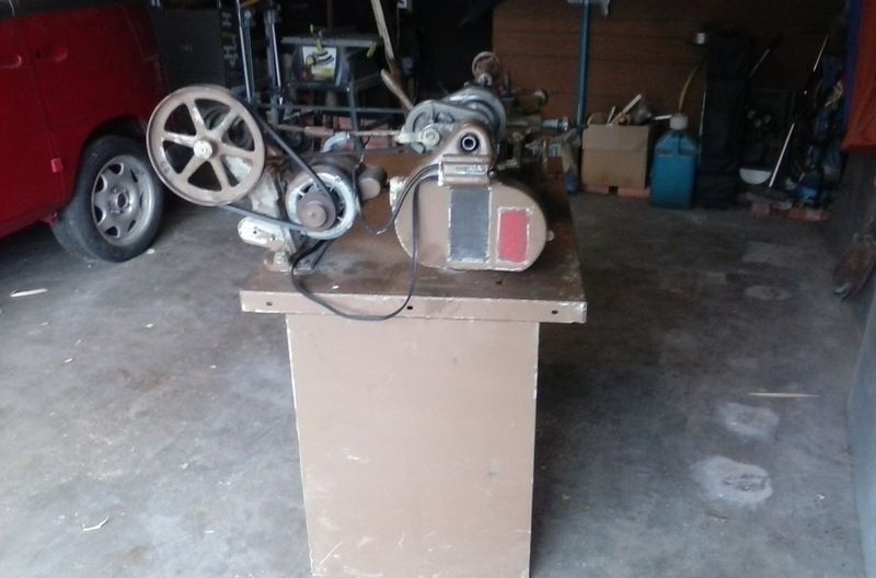

I also bought an old used South Bend lathe today so I can make (among other things) some spike center caps for the CLK rims.

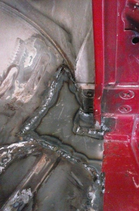

Not much to update, but I keep finding out how deep the rabbit hole goes. I was finding pinholes here and here that I went back and plug welded them and then uncovered a lot of weak metal spots on the underside of the cab I'll have to get back to later after I get the right paint to coat the inside of the frame.

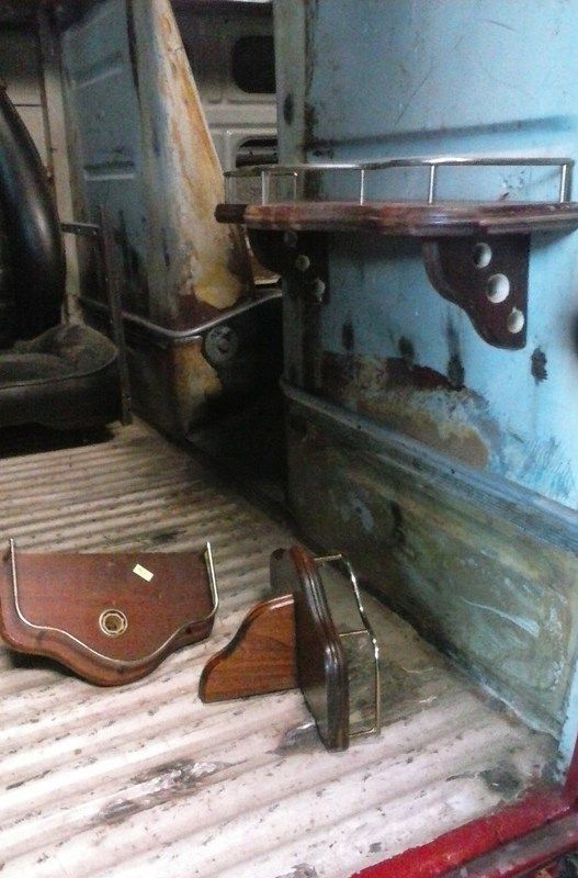

Did a test fit of a shelf yesterday for setting beer on at car shows, etc. The bigger one mounted here I bought maybe 4-5 years ago because I liked the steampunk feel to it. I don't plan on making the interior of the bus completely steampunk, just a few things here and there. So fast forward about a month ago, and I bought the two smaller shelves in a secondhand store here in Houston. They match! I'll mount those in the back on either side of the bench seat.

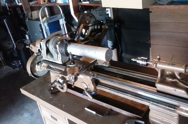

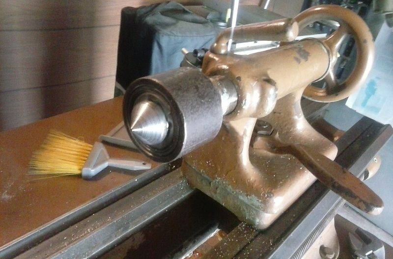

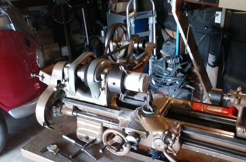

I'm cutting my teeth learning the new (to me) lathe. I started by cleaning up the centering piece on the tail stock. I then cut down the round rod for the spike center caps into a more manageable piece to work with.

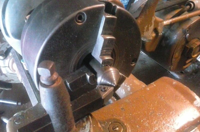

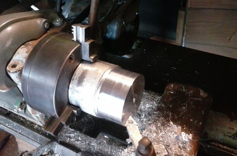

Turning the center caps is a lot of time, but pretty fun and I'm learning quite a bit about machining. It's 3" aluminum round rod and the rims are of course metric, but easy enough to work with. I need to hollow out the area facing the tailstock here, then test fit on the rim hub before turning it down to a pointy section.

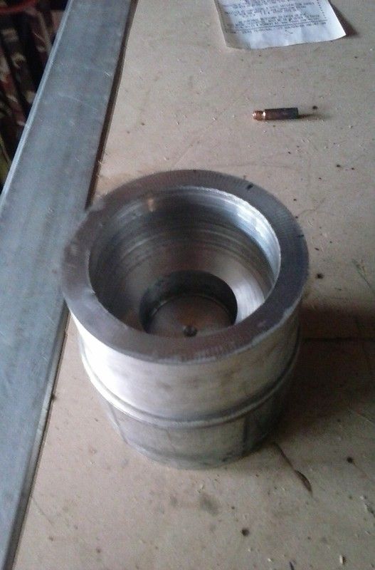

Hollowing out the inside of the cap takes a long time. I'm using a 2 1/8" (54mm) forstener bit which I know wasn't made for cutting aluminum, but I don't really care. It works and would take almost infinitely longer if I tried to just hog out the center with the carbide cutter.
Pulled the cap off and checked it for fit on the rim. Looking good and the dog approves. Just have to remove a little more to clear the axle nut, then open up the inside bore 1mm to clear the front rotor dust caps.

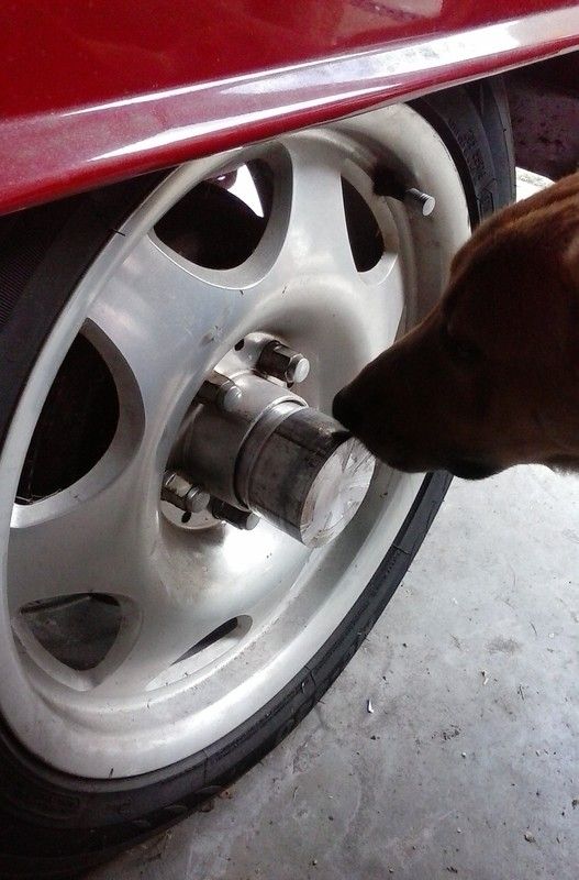

Thanks Man, I'm glad a 53 year-old lathe can produce stuff like this that fits so well with an amateur machinist like myself. It fits on the rear good, just need to open it up some for the front hubs then cut it down to a pointy section.

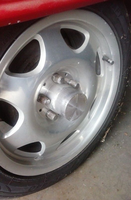

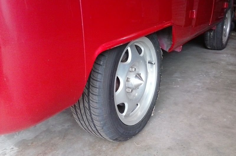

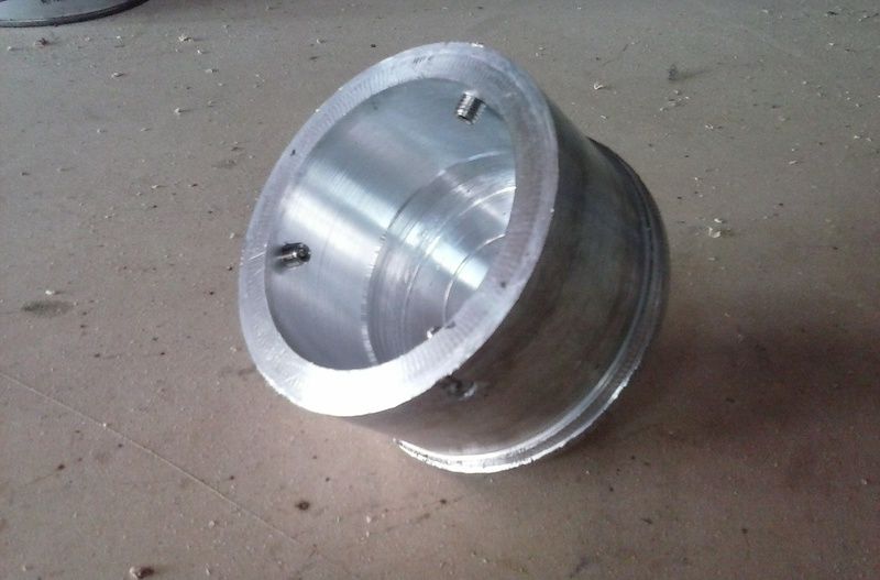

I got one center cap done and it looks great on the bus. It took me just short of 10 hours labor here and there, but now that I have the measurements and a feel for the machine making the other 3 caps should go a lot quicker.
It weighs 0.7lb (or about 330 grams). I just need to drill and tap the holes for three allen screws to secure the cap to the inside of the rim hub.

5mm blind allen screws drilled and tapped to hold it inside the hub.

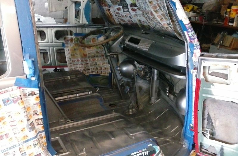

Got some paint laid down today in the cab area. The picture doesn't do it justice. It's a very even coat, but the lighting and camera are crap. Just need to wetsand and clear coat it.

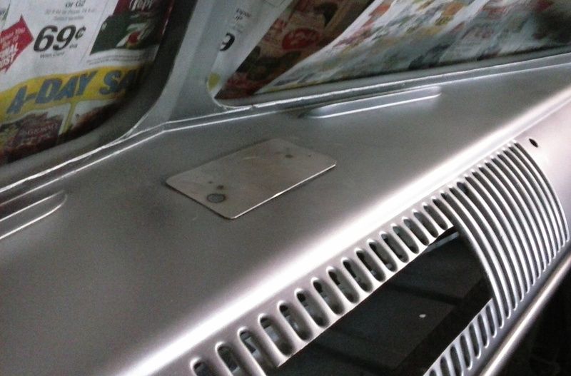

I fabbed up an ashtray and radio delete. Again, some PO cut a bigger hole in the dash to accommodate their Pep Boys radio blasting through some cheap 6 by 9s I'm sure. The ashtray was decorated by the hippy chick and not going back in. Even if I cleaned it up, I don't smoke and one of the clips is busted on it. It's easier to just make a smooth panel the same size than trying to fix it.
Got everything wetsanded and ready to put some clear coat on it.
