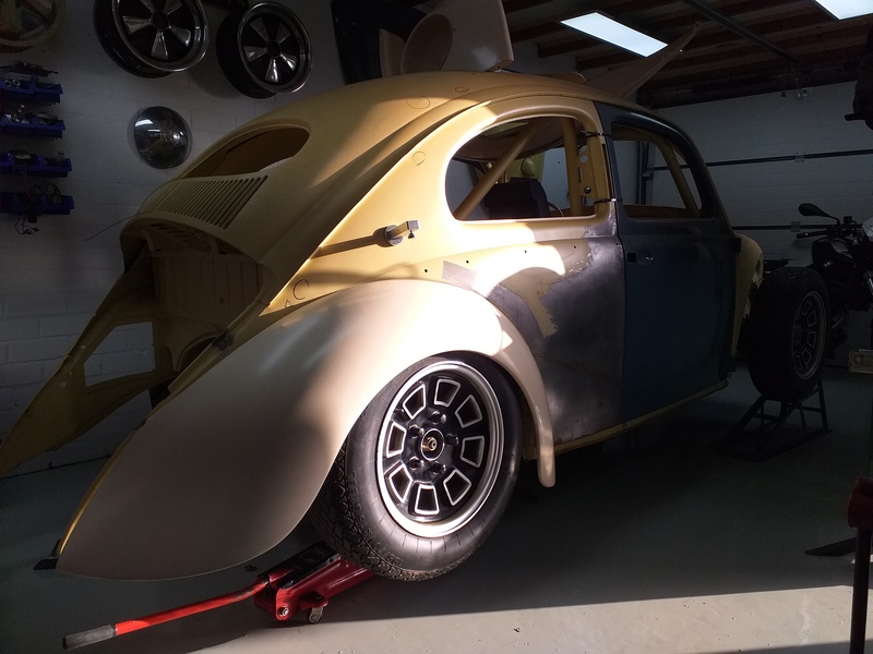

slow progress.
home again
new spare wheel.
made new a-arms with camber adjustment.
New (test) tyres
The test tyres fir perfectly.

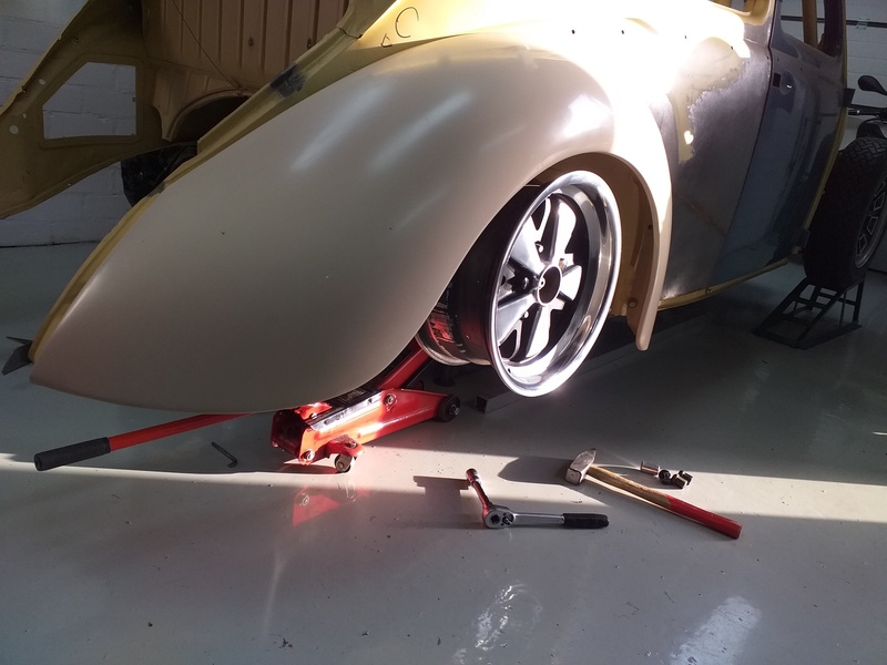

Still not happy with the rearwheel alignment. time to order some monoball bushes and fix the problem. I always thought the driveshafts where a bit to long. today I checked and they are indeed to long, have to fix that too.
