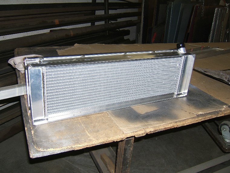

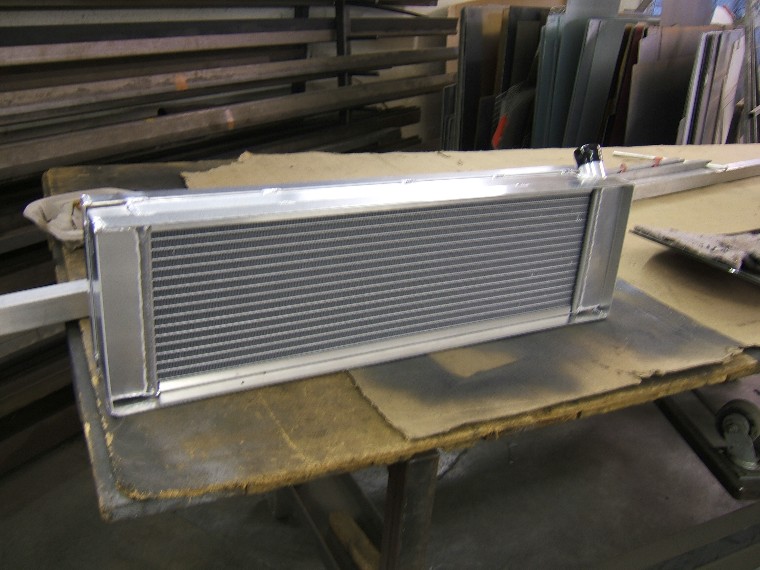

These are my main and chargecooler radiators.
Unless you have a seriously good reason or a very small engine I woldn't even consider a rear mount radiator. There is NO substitute for natural air flow.
Rich
