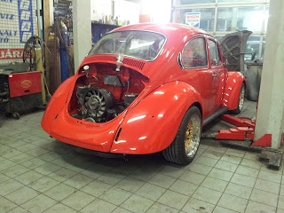

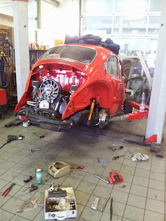

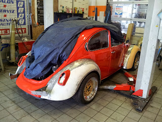

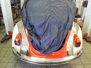

To make it as strong as possible the extra piece was hammered to a "hat shape" so it attaches under the fender's edge on both side. The outer side of the rear fender had to be shorten to keep the original shape and to line up with the running board.
Btw the +5 cm should be over on the limit where stock running boards can be used, at least mine looked awful (no pictures). The front section of the fender was sliced up again and got a "V" shape so the bottom edge is near to stock now and it looks ok to me.
After the second test fit it was good enough to go ahead, time to extend the bumper brackets (30mm) to clear the fenders.
This is it for now, I hope I get them back from the painter in a few days/weeks.
I will have to relocate the rear lights once the fenders are ready

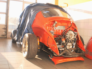

November

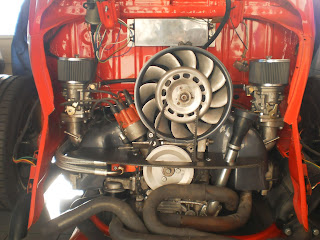

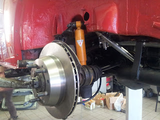

Fitted the missing brake lines, hand brake parts, rotors, drive shafts, finished the berg style mid mount and the whole oil system with all the fittings and consoles

leaving the workshop
in the garage
next day
fitting the rear calipers
merry xmas

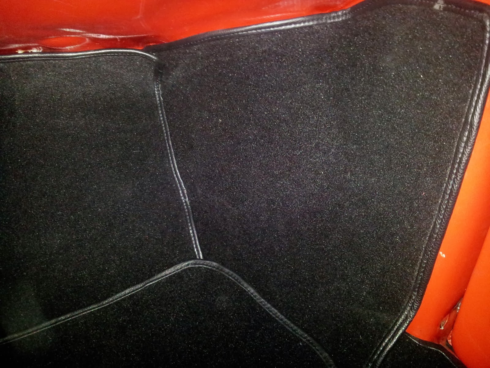

It's been a while since my last post here, but i do have things to share (sorry for the huge pictures but my new blog stores them this way..)

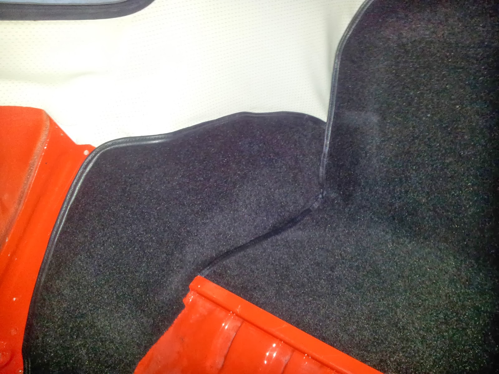

So, new carpets for february:

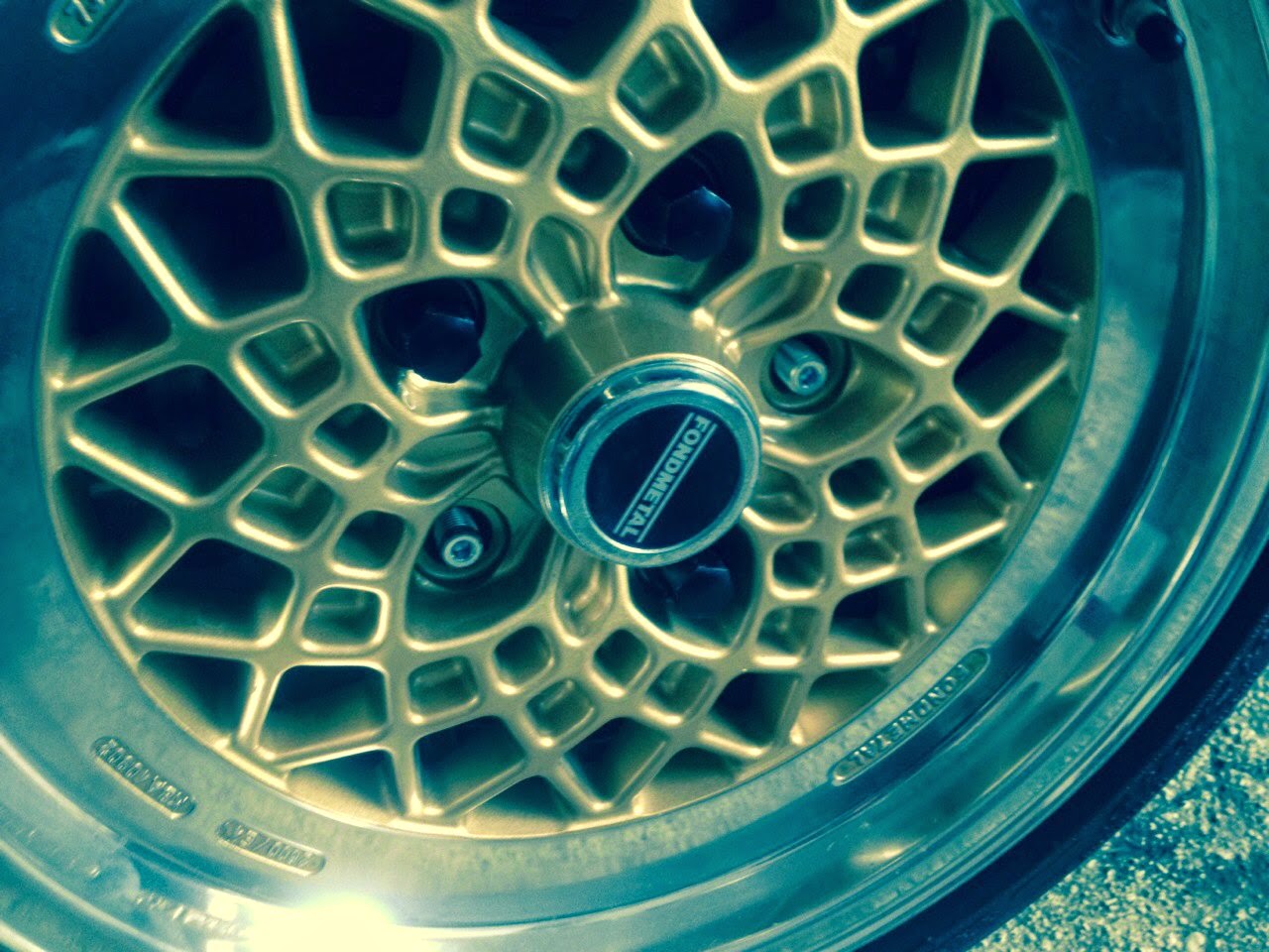

I changed my rear tyres from 215/45 to 205/45 as I needed more space for fender clearence.
Sidenote: Originally I was planning 205/45 as well but the PZero I put on the 8" had too much strech for my taste so I upgraded to 215. As PZeros are not available in 215 I bought a pair of new Conti Premium2s that seemed to be at least 225s or so when monted! Long story short I found that Contis are more robust, while Pirellis are more narrow than any other tyres in the same size. Finally I choose Michelin PilotSport3, it is said to be a very good street tyre on low weight cars (MX-5, Clio Sport etc.) and the 205/45 fits perfectly for the 8 wide rims, exactly what I wanted at the beginning.

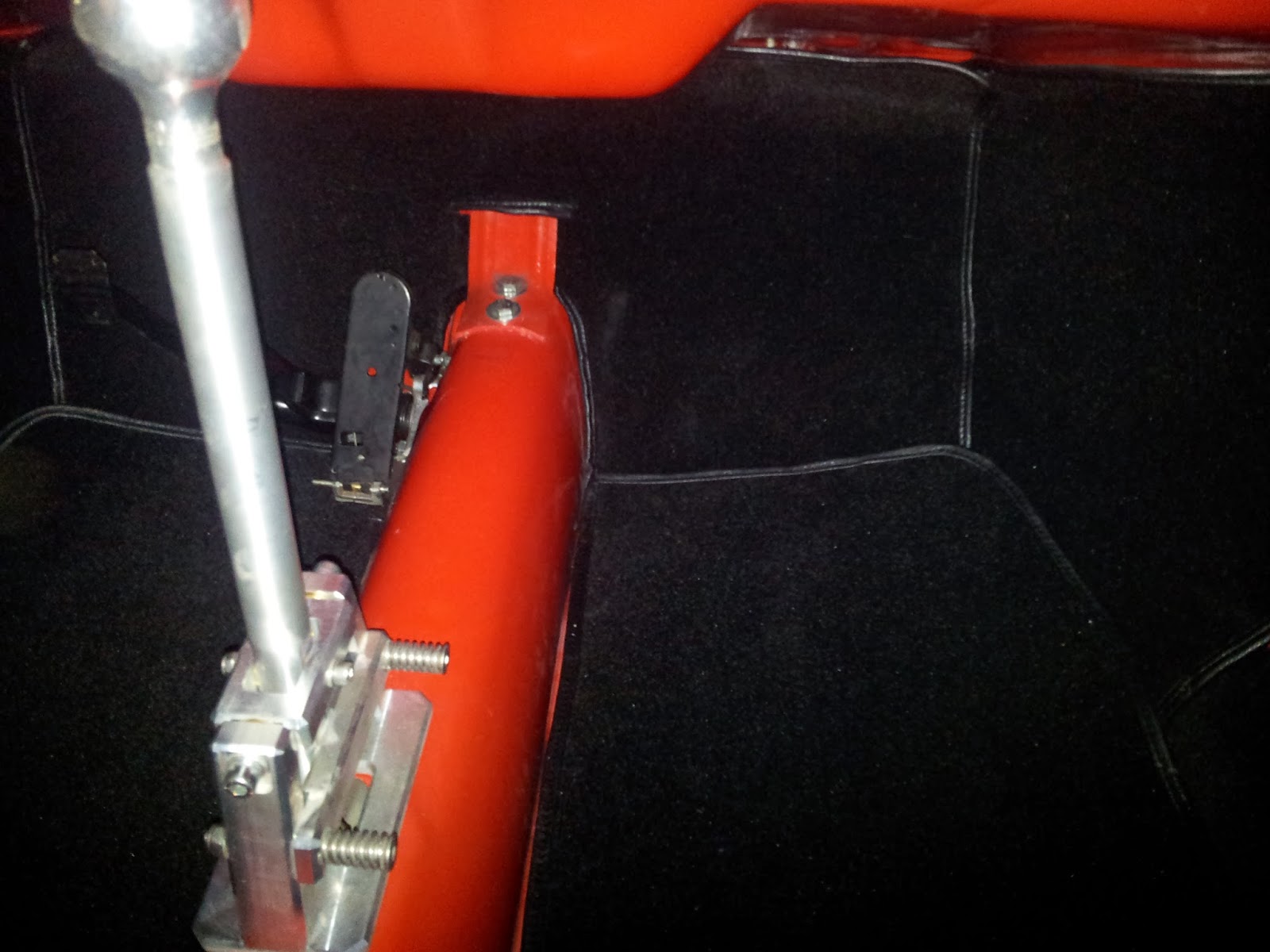

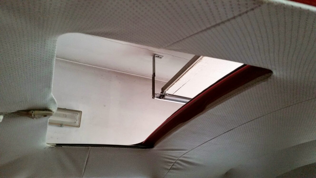

July - back on working

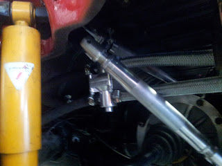

Brakes are ready, the pedal is firm and both of brake and clutch operates well. Front is converted to studs so I can use same bolt on all wheels.

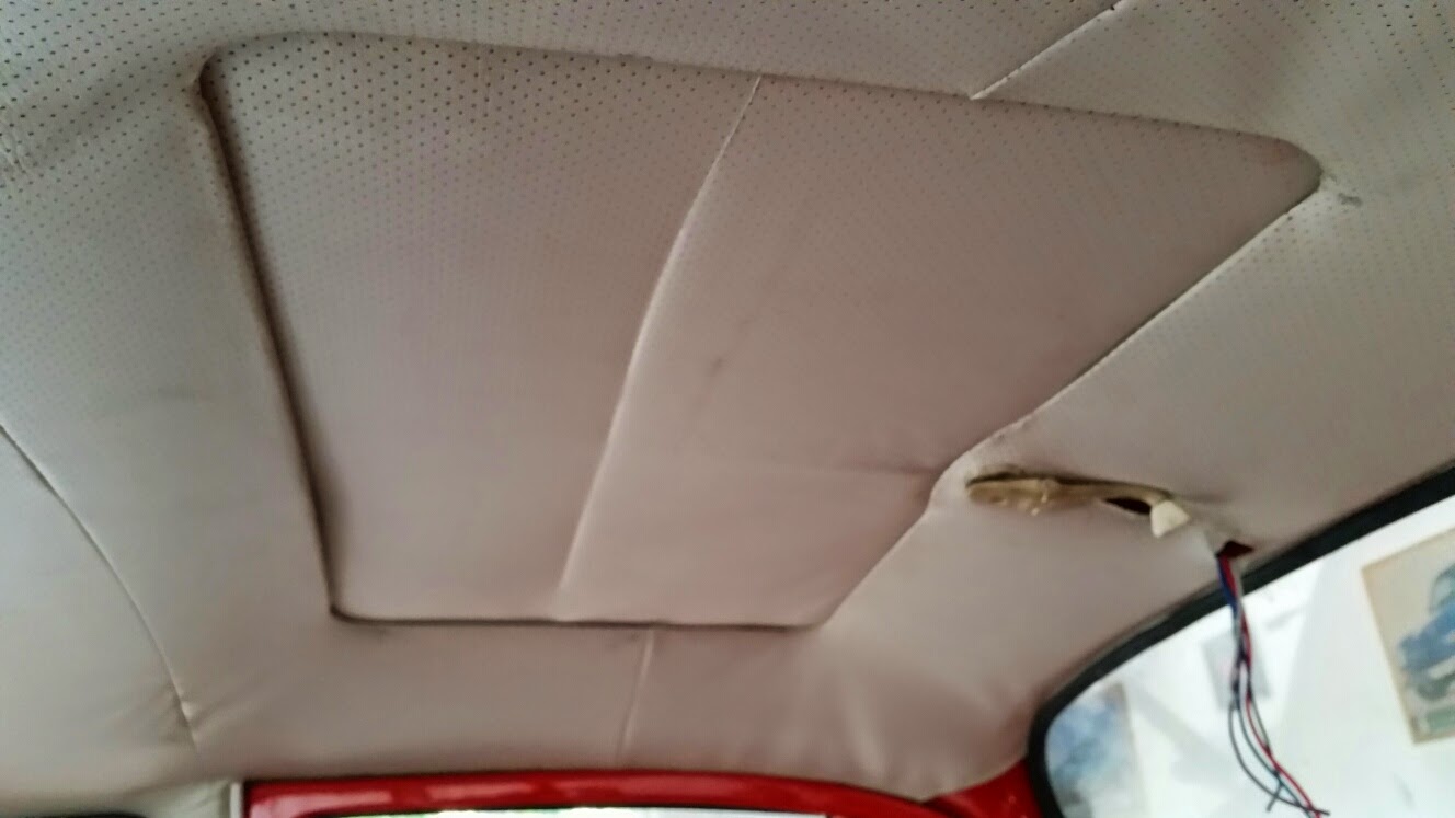

Sunroof is installed, works great.
https://www.youtube.com/watch?featur...&v=_i0qpD1hhXk

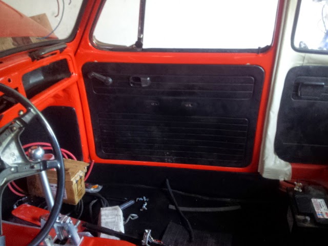

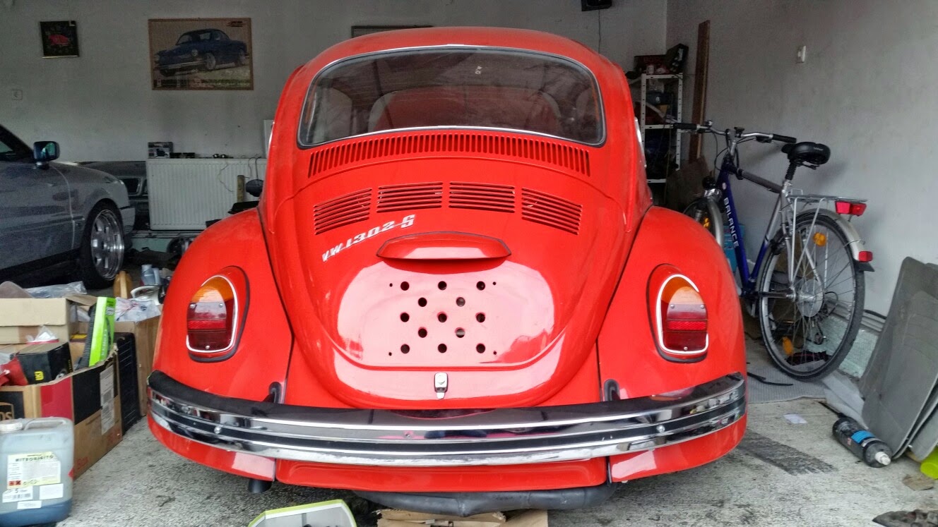

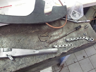

Handbrake is working, door seals and trims mounted:
Door cards, tail lights, hood, rear bumper:

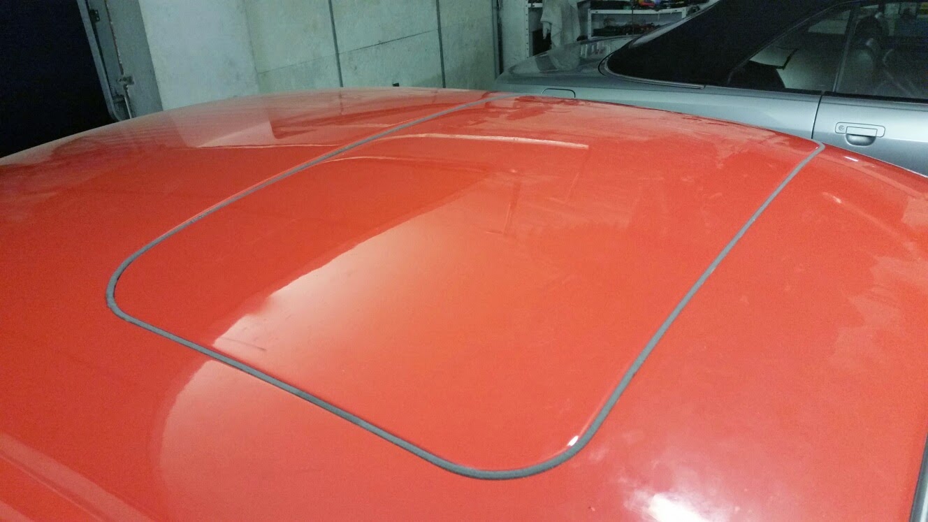

Sunroof seals glued in:
Put together:
And adjusted:
  #90

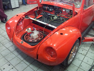

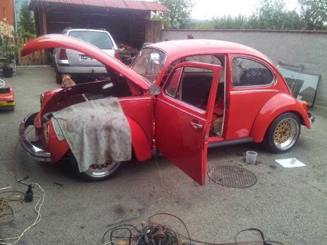

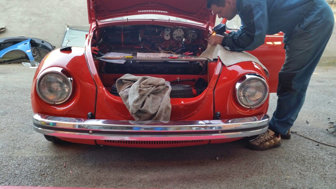

Working on wiring

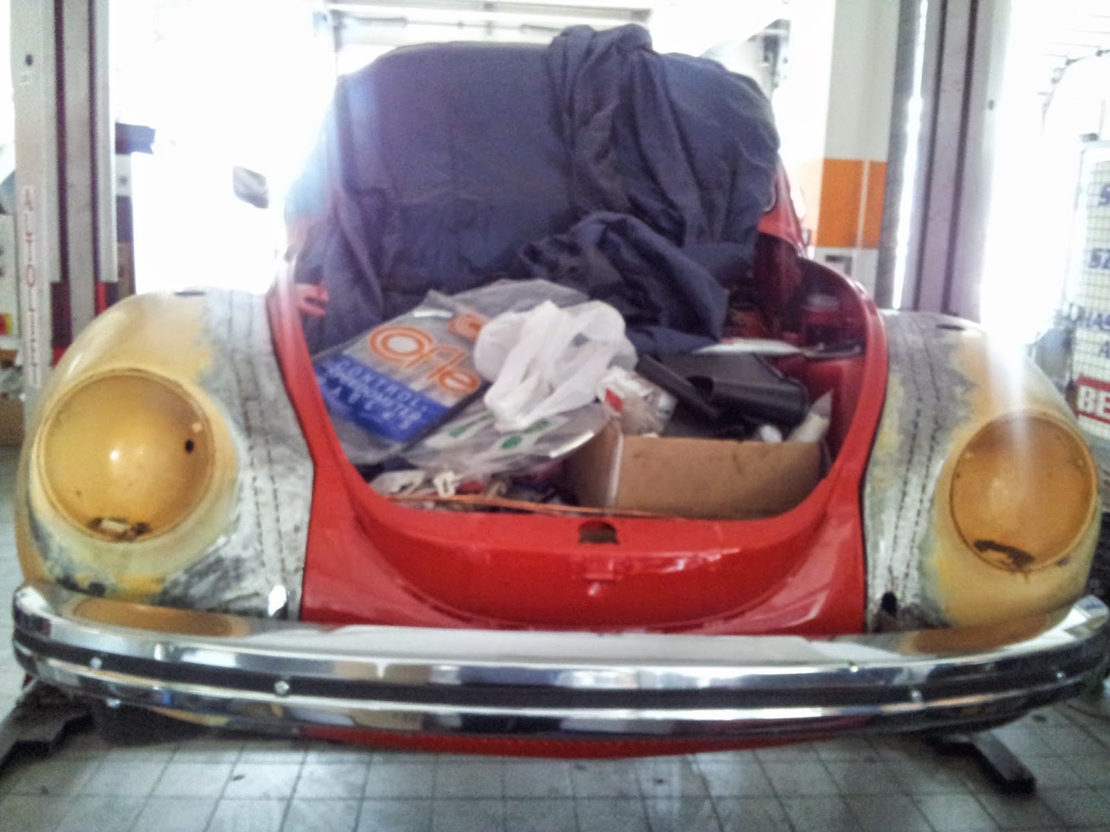

Front lights and bumper installed (to be adjusted)
Rear is completed (except the bumper bolts), lights are working:

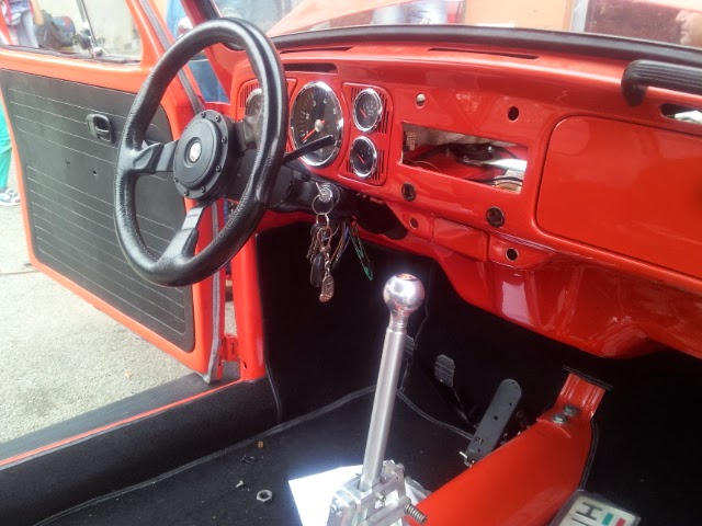

Steering wheel mounted, interior is coming along nicely
