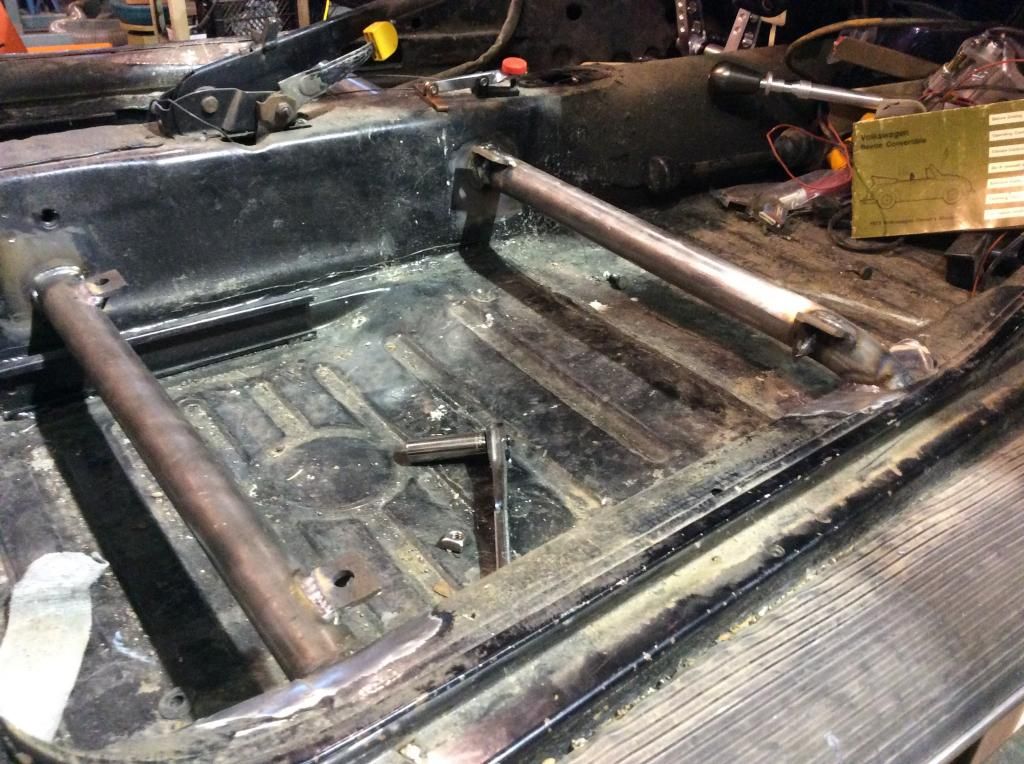

I have had to put the engine build on hold until I sell my old engine. In the mean time I have been working on seat mounts for the factory GT3 seats. Tubes are 1.5 inch .120 DOM steel.

Looking good,Randy! Maybe I can give you a call this week?

Looks good but the body won't be coming off the chassis again any time soon!

Nope no more body off anymore, even less the roll bar, door bars and such are tied in. Mark call me. We work days slowly shifting to night as the week progresses. Usually 15 on 9 off.

Sawzall will make short work of tubing if necessary. But roll cage will be the bigger worry.

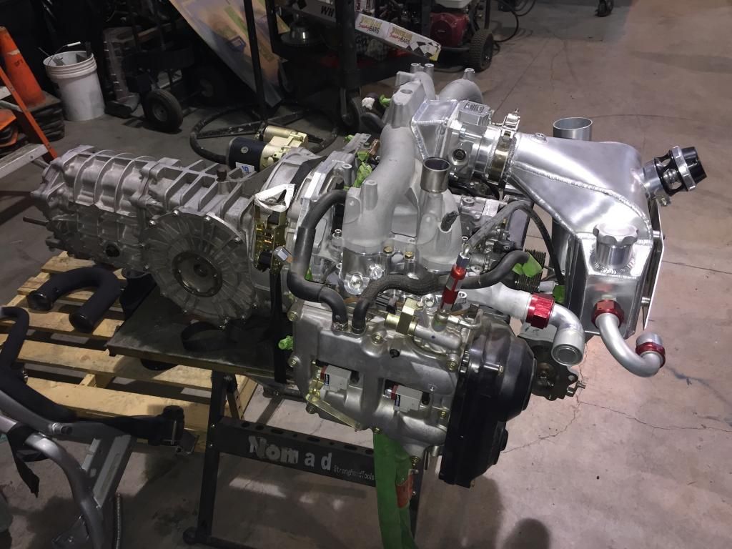

This is the engine and trans I am about to stuff into the back of the Beetle. It was being built for Pikes Peak in a Manx so it will stick out of the back of the Beetle. Should make an interesting ride. And yes I am trying to fit an air-conditioning compressor, alternator and a dry sump pump on there.
