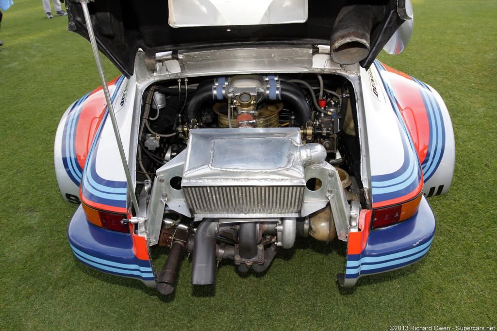

This is the Porsche version of what I will end up with. My build of headers to turbo to intercooler to intake is based on this design.

That would be the ideal solution, but thatīs going to be a tight fit under the apron and to be honest,I donīt believe there will be enough room. Thatīs basically the same idea I had,but after measuring and comparing on another bug in my shop....thereīs no way to do it and keep it under the apron and decklid. You may have to relocate your intercooler from itīs present position also if it is going to fit under the decklid. The cam wheel cover on the DOHC suby takes up quite bit and makes it longer than a type 4. You could move the trans/motor package forward a couple of inches requiring you to cut the torsion tube and the frame horn. Even then it will be real tight.

Apron and deck Lid? I don't need no apron and the deck lid will be short like the RSR. I am thinking of making it Matt black with Martini stripes. Widow maker paint job, maybe appropriate when the boost is up...
For sure the engine exhaust and turbo placement rule out an apron. Just like the RSR lost the center of the bumper and it didn't have a muffler to put ther either.

Ah ok,didnīt know what your plan was There was Porsche 918 during itīs developement stages that had a matt black paint job with the Martini stripes and logos...looked pretty bad ass!

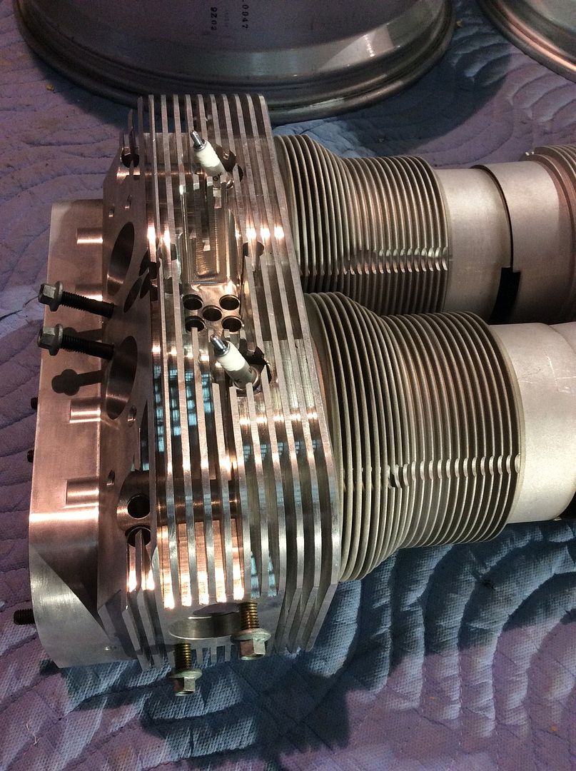

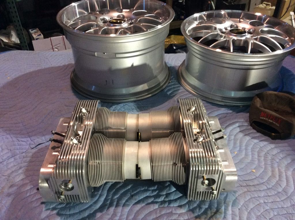

Well the longer it takes the more changes happen. I have received some Remmele parts for my Billet engine so at the request of the spousal unit to keep the convert a street car, the 2.8L Billet is going in. Here are a few photos of the Billet Remmele Motorsport heads with the LN Engineering Nickies I purchased here almost 10 years ago...

come closer...

More Remmele parts are on the way and will be posted as they arrive. None of this would have been possible without the help of 70TurboBug Mark. Thanks to Mark for being the intermediary on all the ordering, taking delivery of the parts in Germany and then shipping them to me in New Mexico. The plans for the engine are 102 Nickie cylinders, JE FSR billet pistons, and 80mm SCAT billet crankshaft. I am talking with Pauter about some rods. The build will be slow as it absorbs lots of money and then has to wait while I earn more! I am hoping to get an early G50 transmission and cram it into the chassis. More to come...
