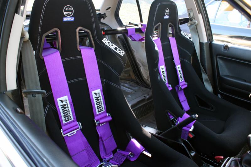

I am pretty sure I will get these seats, Sparco Sprint 5. They are narrow enough to fit in the bug without looking awkward in my opinion. FIA approved and have the submarine hole for the 5th belt.
What is your opinion. 4 or 5 point seat belts? Any sanctioned race will require 5 point, but is it overkill for me? I will be doing track days, but doubt I will be doing full fledged races. That being said, the safer the better. My worry is if they will be a pain to put on and off, but I have heard 4 point are more of a PITA than 5.

For any track event 5 or 6 point best. Antisubmarine very important feature that 4 point can't provide.
Not that inconvenient to take on and off with practice.

This ^^^^^ and another weight saving opportunity here also with an ultralight pro harness, these and the digi dash and thin wall wiring can save well over 3 kg. the budget steel harness fittings start to nag on you if your in the car for an hour or more, i seem to remember posting one that weighed in at 3.5 kg

As for belts, Alex is right, you want at least a 5-point, and preferably a cam lock. If you've ever put on a 4-point belt and cinched it up wrong, it'll creep up your stomach. Submarining under the belt is the same thing but happens much faster during an accident and the 5th point prevents that. I've also had to spend, probably hours now, explaining to passengers how a latch link belt works and how to put one on. It's worth the extra money for a cam lock to never go through that, coincidentally, I'm also switching to cam locks
As a rule of thumb, you can never be too safe. Consider this, a $600 seat, $300 belt, $900 fire suppression system, $800 fuel cell, $1200 roll cage, $1500 fire suit, $400 helmet, etc., seem like big purchases up front, but they can prevent tens or hundreds of thousands of dollars in hospital bills after an accident. So when you look at safety items, your foremost question should be, "How much am I worth?"

Sparco Sprint - Sparco Sprint seats are a made with a steel tube-frame construction. While FIA certified, and safer then a non-certified seat, you should consider the use of the vehicle before buying them. If there is a significant chance of serious accident in the car (track racing, stage rally, etc.) then I would pass on the Sprints and find a composite construction seat. You want to avoid a situation where the seat frame could distort or break and injure it's occupant. In the case of rally-cross or autocross (where accidents which damage the passenger compartment are far less likely) a Sprint would be a fine choice.
4pt belts - Avoid these like plague. As already stated, it's pretty challenging to do these up properly without the buckle rising up into your abdomen. An accident (even minor) could cause you great internal damage. Go with 5pts or 6pts, and always run the submarine belt...even to the corner store.

Sorry for hijacking, but can you tell me please where the submarine belt should be attached (what is the best angle?)? Slots in the seat are required in this case?
