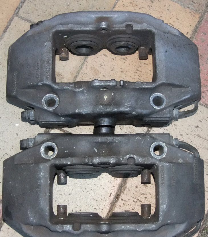

All this go faster stuff is making me think about a brake upgrade.
I have 996 rears on the front with 930 rotors which work really well.
I saw some Boxster fronts on eBay and got them at really good price, just sourcing some rotors now.
Bought some more parts for my brake upgrade, some 944 hubs, thanks to Wayne Penrose for these and I bought some DBA Boxster front rotors from Tyler at 999 Automotive.

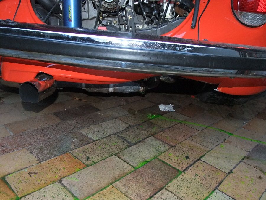

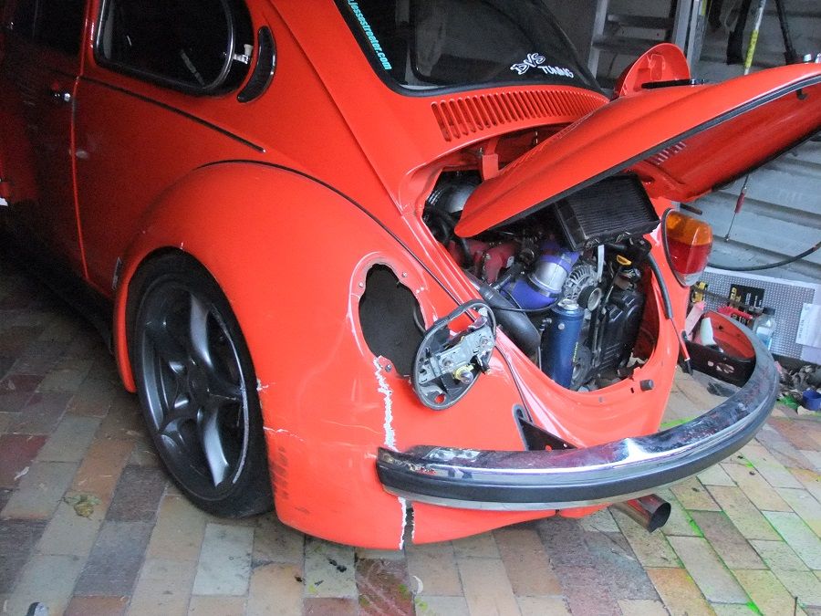

I had a bit of a mishap.
I parked my bug in our driveway, just up the hill from my house, I was on my way out, I musnt have pulled the handbrake on hard enough, it rolled down the driveway and hit my sons car and ran into a huge rock at our front door.
Damage was two rear aero fender, one tailight, one wheel, rear apron, bumper bar, exhaust cross pipe, couple of cam gears and their covers, water pump and thermostat housing,
My sons car needs front and rear bumpers, 1 bumper bracket and a drivers side fender, were going to fit Aero fenders to it now and give it a bit of a freshen up.
Feel like an idiot but at least no one was hurt.
Car is fixed now just waiting on getting the motor back with the damage fixed and the new cams installed.
While waiting for the motor Ive fitted the Boxster front brakes.

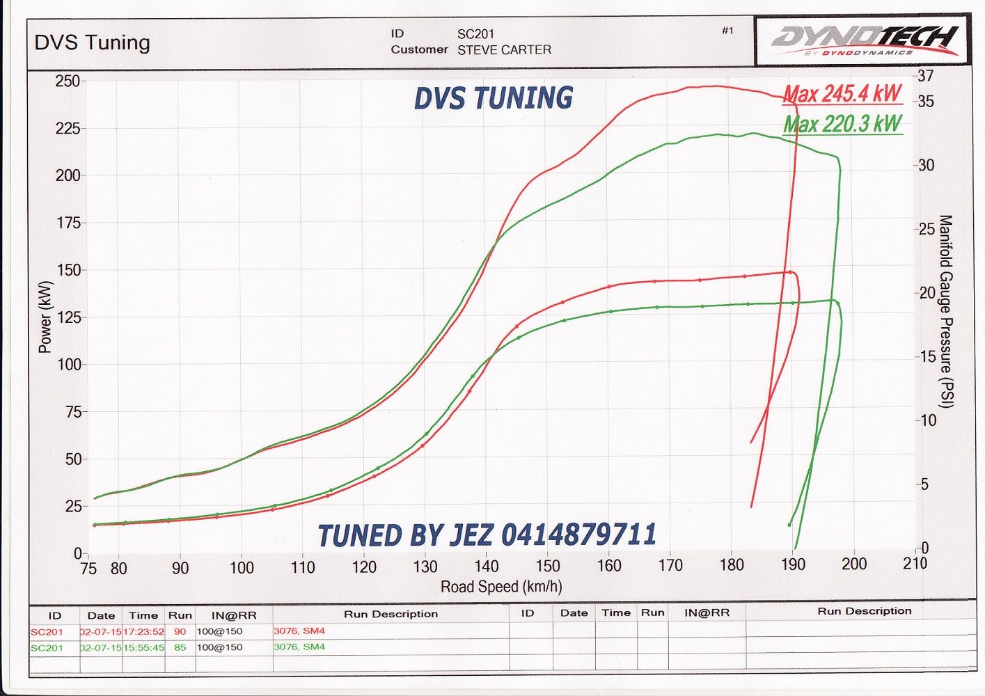

Car is back on the road, it lost power when the Tomei Pon cams were fitted, its a complete mystery, triple checked everything.
So I had the new Adaptronic ECU tuned on 98 RON and E85, its using a GM sensor so the ECU will adjust mixture and timing depending on the mix, boost is either low for 98 or higher for E85 using a Turbosmart eBoost.
The motor wouldn't take any more than 21 psi on E85 and would have an ignition breakdown, its running stock coil on plugs so I might be going to to LS2 truck coils soon.
It making 245 kW on E85 and has picked up a bucket load of torque, it hits very hard.
I setup a launch control through the ECU using the speed sensor in the G50 so at 0KPH its limited to 5000 rpm where it makes about 2 psi boost, as soon as the car moves 1 of the 8 segments in the G50 speed sensor tells the ECU to switch of launch control. It will be hard on the motor but Im only going to use it sparingly.

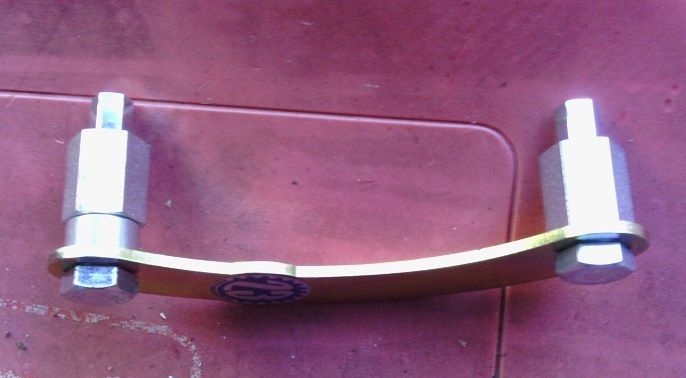

When I was checking my cam timing etc I needed to remove the timing belt, I made a tool to lock the crank pulley and another I bought to lock cam gears on one side as they tend to spin violently when the belt is released which could bend valves.

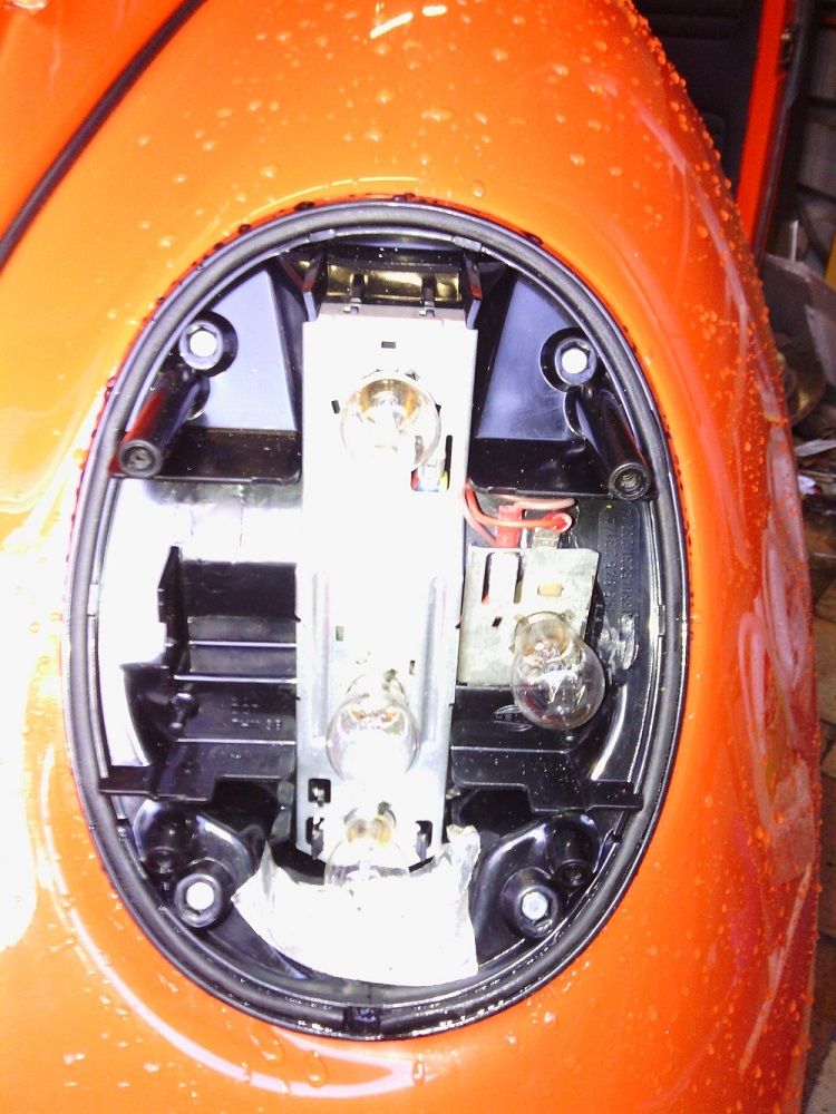

I had to fit new tailights to my car after the crash, I fitted and extra stop light bulb using a section off an old bulb holder.
