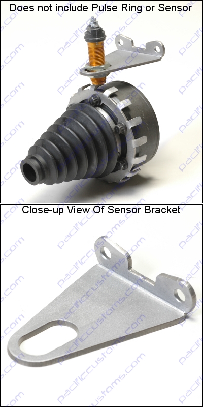

For the speedometer, the 993 is going to use an electronic input, which you can easily duplicate. You will, however, need a second speedometer adjustment unit as the "pulses per mile" off your bug setup is sure to be different from whatever Porsche was using. For a speedometer sensor this mount and hall-sender ring is the hottest setup I've found so far, and will be installing on my own bug:
http://www.pacificcustoms.com/mm5/me..._Code=featured

Looking at the Pacific Customs site I found just what I was talking about...
