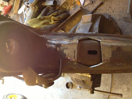

Ok. I see where some guys run the 944 steel trailing arms on thier beetles, but taking a closer look at those arms they are just the same as the beetle IRS arms. Why the change if they look the same. I am also going to assume that they are the same.

The Porsche steel arms have internal strengthening..

Is that confirmed? I've heard that a million times, but no one is ever willing to cut up the 944 arms to prove it.

Ive never been brave enough to find out, seems like a waste of good parts. Maybe one day
But also there is a difference in the hole layout where the TA connects to springplate due to the adjustments available on 944 that are not on bug.

Yes, I've cut mine open as I needed more clearance for a coil-over.
http://www.ricola.co.uk/images/cabri...m_internal.jpg
