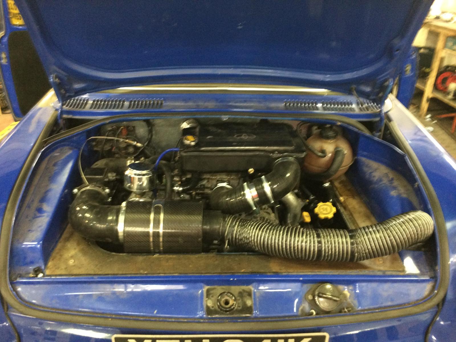

Hello GermanLooker
Wally asked me to write something about my project.
I want to fulfill this command, upps, this request.
As I have already said here https://www.germanlook.net/forums/sh...postcount=1497 and next,
my progress is very, very slow.
Now, only a little Teaser

Haha!
That is extremely cool!
Can you keep it under the decklid? Any pics of the Variant as it is now?
thanks!
'75 Super.
...because race car!

I hope it fits under the lid.
But in any case, I have to cut off the intake manifold.
We will see.

Very cool!
(Psst: I like it so much as I am slowly preparing a rad build with a watercooled (6) unit into an early notch myself)
'75 Super.

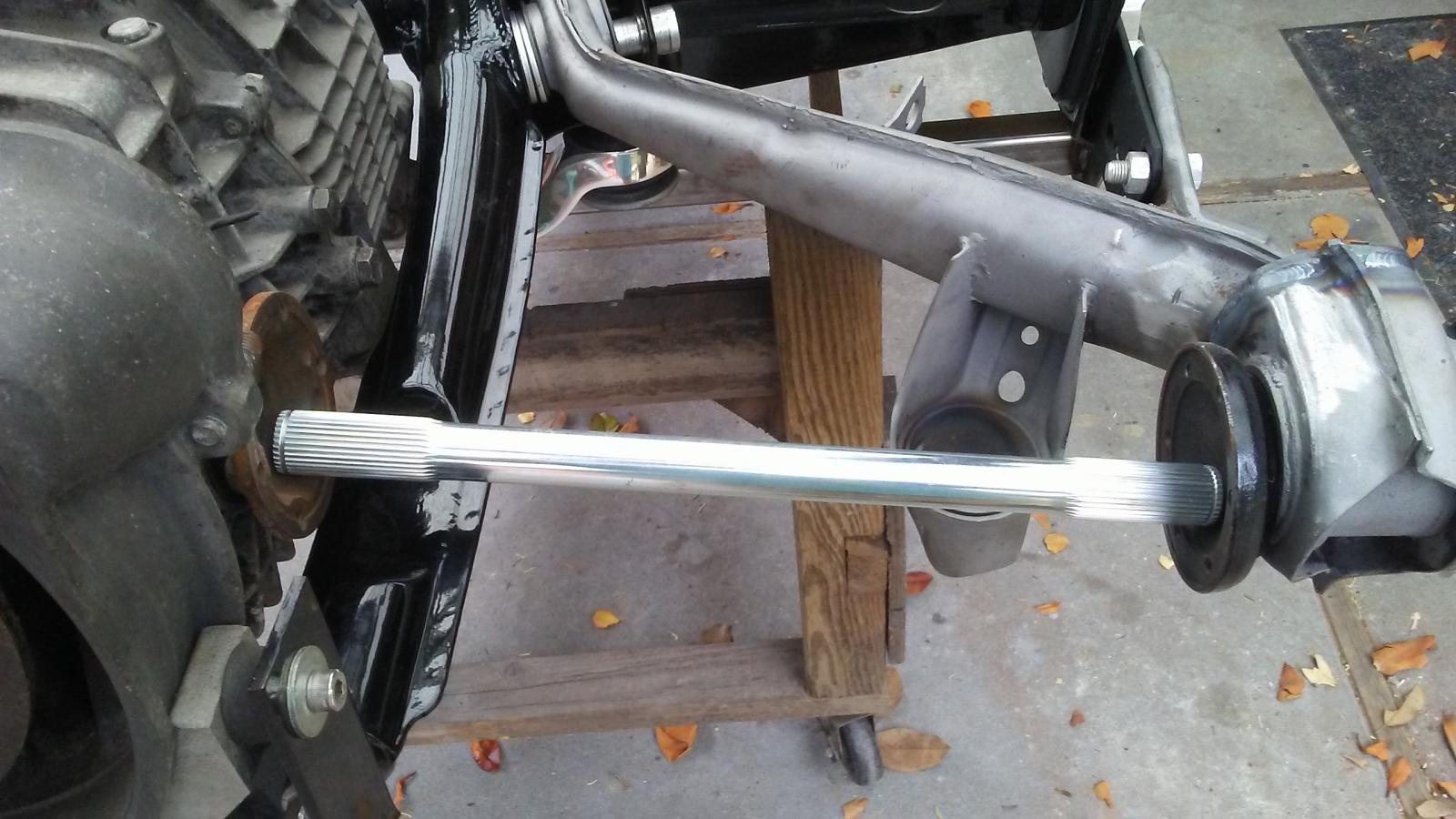

Hello
I could use your help or input.
In my project, I have difficulty finding suitable drive shafts.
Unlike the Beetle or Bulli with Subaru transmission, the installation position is much lower and therefore I need shorter drive shafts.
Even the shortest ones available (Type3 automatic, left shaft) are still a bit too long.
You can cut drive shafts.
The special company that does that, only cuts hollow drive shafts. All VW or Porsche drive shafts I would like to use, are made of full material.
Someone an idea for a suitable solution?

I suppose you really can only go with a custom axle then.
SAW makes those right? Probably only stateside companies do that kinda work...
Or Finnish.

Sway Away still makes axles in any length you could want.
These are Empi, and cost a lot less.
Here with 1" narrowed arms and a 915 trans FWIW.
They have no inside shoulder/stop for the CV, so they are forgiving WRT length..
