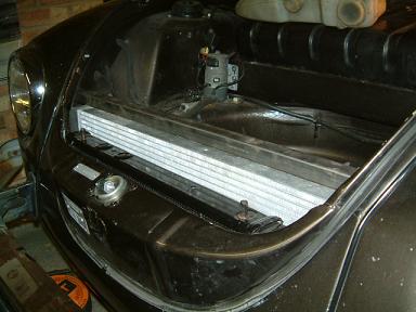

I've ordered the adapter kit from DS tuning now and have the 996 brakes on. Will start to do the cutting soon! My plan is to sort out the front end for the radiator mountings and then turn the car around in the (single) garage so I can sort out the rear.

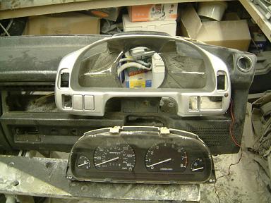

Progress has been kinda slow recently. I've got the G50 gearbox now and the radiator install is just about done, I've also started modifying the dash for the Subaru instrument cluster.
Rich

Got any more pics of the rad setup ?
How are you routing the coolant lines and what are you using for them ?
Rob.

Rob,
More pics are on my website, I just picked a few of the highlights for this thread. That's a chargecooler rad in front of the main one if you were wondering. I'll be using 28mm copper pipe for the main lines run under the chassis, probably along the cabrio chassis strengthening rails.

Rich,
On your site you mention that you will block off the heater outlet.
I read somehwhere that that is a bad idea, since it needs it for the normal flow through the block.
In my setup I will use the small outlet from the coolant manifold to go into a burp tank (pressurized), and then from the burp tank to the heater return at the back of the block.
What are you using for a coolant tank ? I got one from a Golf, but the outlet is too small.
Rob.

Hmm, maybe I didn't explain exactly what I was doing...
I am blanking off the original heater outlet on the coolant manifold and having one in the new outlet position (effectively in a similar position to stock after the manifold is reversed), it is very important to keep it! Your plan sounds good if you don't want a heater (I do!). I'm not sure what tank I'm going to use yet, I'll wait until the engine is in finally before deciding when I know the available space, I want it to be nice and big...
