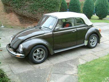

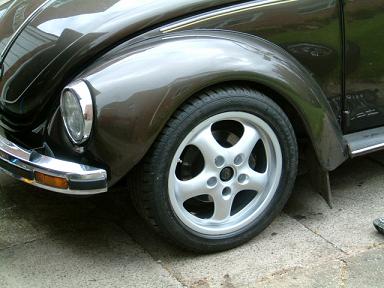

Time for project number 3!
If you haven't seen on my website, I am on to my next project now.
It's a late 1303 cabrio and I am in the parts collecting phase.

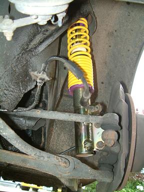

So far I have only fitted the kerscher struts
and test fitted the cup 2s
http://www.ricola.co.uk

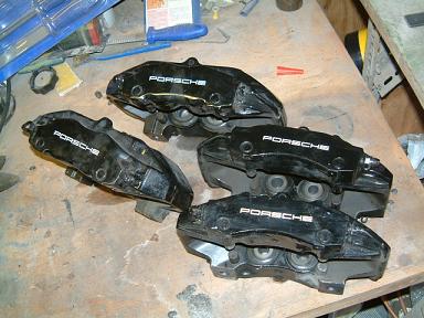

Still to come are these:
and most importantly this!

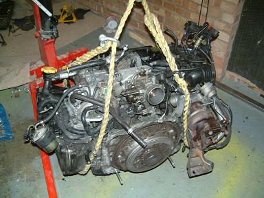

EJ20T ?
Rob.
Old June 17th 2005, 04:21
ricola's Avatar
ricola ricola is offline
Location: Warwick, UK
Posts: 1,137
Yes, it's a WRX RA model that is 260bhp standard should suffice!

What are your plans for a transmission, ECU, engine mounting? I've got an EJ20T too, but I think I'm going to hold off installing it for quite a while.
Have you seen this yet? http://www.customoffroad.com.au/partFull.asp?partid=99

Yeah, I saw that speed sensor, but there is someone in the UK developing a bolt on solution which should be easier for me to get hold of and cheaper...
I'm going to use the stock AT trans for the beginning and maybe uprate to a pro street version a bit later on. I don't really drive that hard in reality!
At the moment my plans are: reverse rear engine cradle and use a 'berg' style mid mount, no front mount. That will get the engine comfortably under the body. I'll make up my own trapeze style bar at the back, I'm concerned a stock one wouldn't accomodate the turbo. Stock ECU, I was going to use Microtech but support is very limited for me in UK. Now my main problem is finding a suitable loom! I'll probably shorten the sump about 30mm
Randy: you seem to go just a bit further than me! I didn't want the hassles of using a newer engine wiht all the immobiliser stuff and variable cam stuff, 260bhp should be enough... I'd love to see some pics of your projects if you have any!
