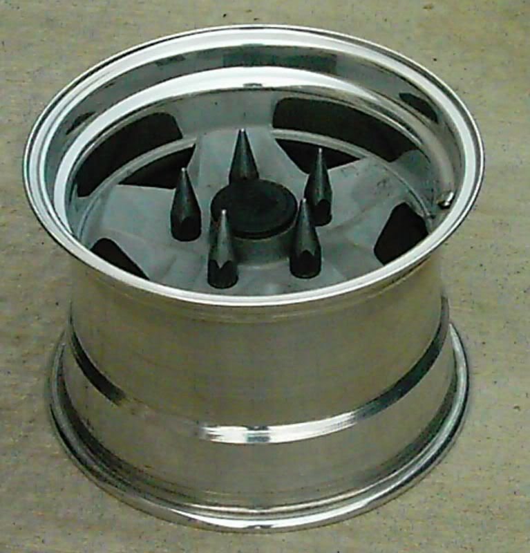

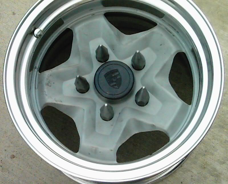

Hi, going wider tires for a IRS is not that big of a problem. If you are willing to shorten the axel, then why not use wider fender? I will be running 10 rims by using wider fenders. If its just to get the tires under the fenders, use wider ones. These are 10 cookie cutter;
See they fit, with three inch wider Fiber glass fenders.

DORIGTT April 15th 2008 22:12
Where did 10" cookie cutters come from?:confused:
effvee April 16th 2008 10:14
10 Cookies
Hello, the cookies were 6". But there is a person here in Southern California, that mods, welds, and repair Alum rims. He lathed out the center section of the cookies cutters, added a 10" blank. From the out side you can't tell anything was done. On the inside there is a complete automated weld, very professionally done.
