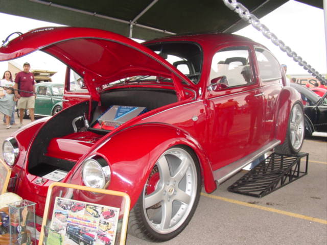

Hi,
I'm looking at to fit under the fenders of my 54 oval GL other rim's thant "simple 17 inch.."
but is that possible.. I'm rather thinking to get in 8x19" rim's... (18 inch is too simple to get in. )
Has somebody already seen's that?? or got the solution..??
model is a 54 standard, chassis 67 automatic with 944 atmo brakes on front has a narrowed axe or 4cm..
if you have any informations about a oval or an other 1200 with 19"... let me know.. just to see if that's possible...
thanks a lot
david

almost any diameter rim should fit under a beetle fender and still be able to turn.
remember that a stock tire (165 sr 15) has a diameter of 25.5"
as you increase the size of your rim, you can decrease the size (aspect ratio) of your tire and this should accomodate the increased rim size.
For example:
205/60/15 = 24.7" diameter
205/50/16 = 24.1" diameter
204/40/17 = 23.5" diameter
215/35/18 = 23.9" diameter
225/35/19 = 25.2" diameter
So you see, any of these tires can be fitted under a beetle's fenders. Alot has to do with how low you make the car and how wide your wheels are & what offset they have.

I saw a set of 17 in rims with 145s on them at a show. They looked sharp, but any taller and you may run out of room for rubber or much of it anyway. The ride really decreases as the rubber gets shorter. I would think the handling would decrease to as you would have to keep them fairly hard to keep the rims from hitting the ground on a big bump. A 19 in rim with 25 inch tires would probably fit nicely and still give you the best of both worlds with about 3 inches of sidewall height. A seven inch rim with an eight inch wide tire should fit if you don't lower it much and have it offset properly. Just my observation.

okey, thanks for these informations.. we will se haw it goes...car wont be a low rider... I need to use it on the roads.. and road here in the country side are not as flat and large as US motorway's.. it's rather small road around here.. se that why in need bit rim's.....
9x19 goes easy at the rear.. hope to find 8x19 from front.. but need to see as said vujade the offset.
to be continued..
dave

For the wheel, you could find easily 8*19, and, on these type of wheel, you can put 215/35/19 tyre.....
for example :
front : 8*19 + 215/35/19 tyre
rear : 9*19 or 8.5*19 with 225/35/19
