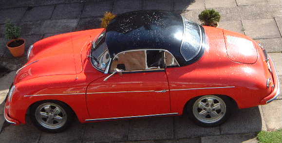

My old speedster replica was quite GL:
944 brakes
coil-over front suspension
915 gearbox
subaru EJ20t engine
16" fully polished fuchs
replica Glaspar hardtop
Rich

I see you have a suby in that - how hard was it to keep it cool without anything that resembles a grill on the front for a rad? Is it in the rear , or is it up front ? I am curious , because that engine is one I am really tempted to use in an upcoming project ( not sure what - maybe a 356!!only time will tell ).Very cool car!!!

The radiator was up front and it cooled OK, although it could have been better. I am helping a friend build another similar car and the radiator will be improved, his car will be black and we will be slimming down the lower centre section of the front bumper and spending a lot of time on a smooth flowing scoop. You should hardly notice it at all, if you look carefully the silver PGO car has something similar in the pic above.
