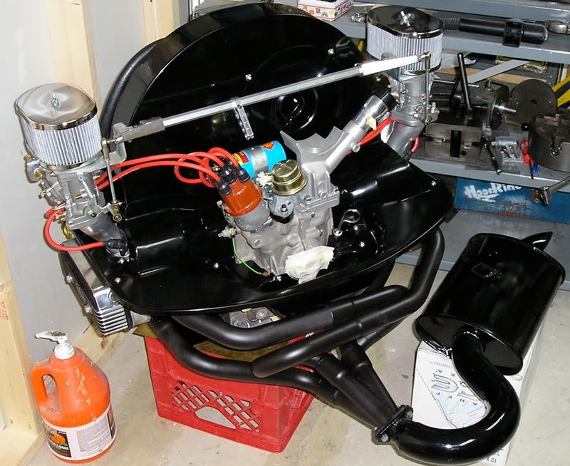

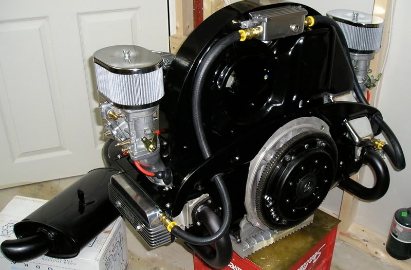

Hey guys,
I'll definitely be there, and we'l throw my bug up on the rollers. let's get a little bench racing going on; what do you think my new motor will make?
1956cc
Rimco preped case, clearanced/full flowed
76mm 4340 crank
90.5 mahle P/C
stock rods (balanced)
042 heads with mild P&P (40X35 stainless with HD springs)
Stock rockers
web 120 camshaft
chromoly pushrods
Weber 44 IDF's on matched manifolds
009 Distributer
1 1/2 merged exhaust with phatboy muff
Pint on me for whoever guesses the closest! we'll have to wait untill after the dyno day for results tho

To the wheels, my guess: 95HP 105TQ
What's the compression ratio?

1. I will guess 105HP, 119TQ to the wheels for Alex's 1956cc

Pete can't believe i forgot to put that!
it's 9.1

In fact here are pics i just took after getting the tin back from powdercoating

Looks good. :agree: When is it going in?

Thanks Pete,
I wanted to keep it simple, but all business too. Well I've got the car up on jack stands, tail in the air. 1600 is out, so is the tranny. So I think I'm gonna be waiting on a tranny (i decided now that it would be best to upgrade the drivedrain..... ) so as soon as thats all sorted, we're ready to go. I've got lots to keep me busy though, cleaning the engine compartment, re-bushing the pedal cluster, wiring, paint my calipers etc.......
