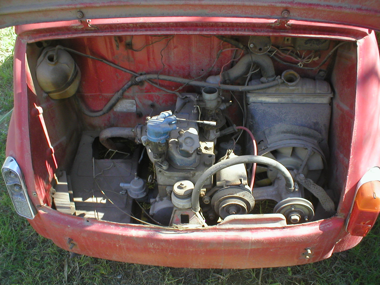

For example, the Fiat 850 used a radiator mounted in the engine bay next to the engine! It had a really interesting fan / scoop arrangement. Have a look.
http://farm5.static.flickr.com/4053/...32a76f25_z.jpg
http://3.bp.blogspot.com/_fvl-y7h6TF...+850tc+021.JPG
http://4.bp.blogspot.com/_fvl-y7h6TF...965+NY+007.JPG

Yes, but the fast Abarth version of the 600 (same engine I think) eventually had the radiator up front.
See: http://www.supercars.net/cars/200.html
No HP loss on the fan anymore, and better weight distribution.
But it will probably work nicely, a shaft driven fan.
