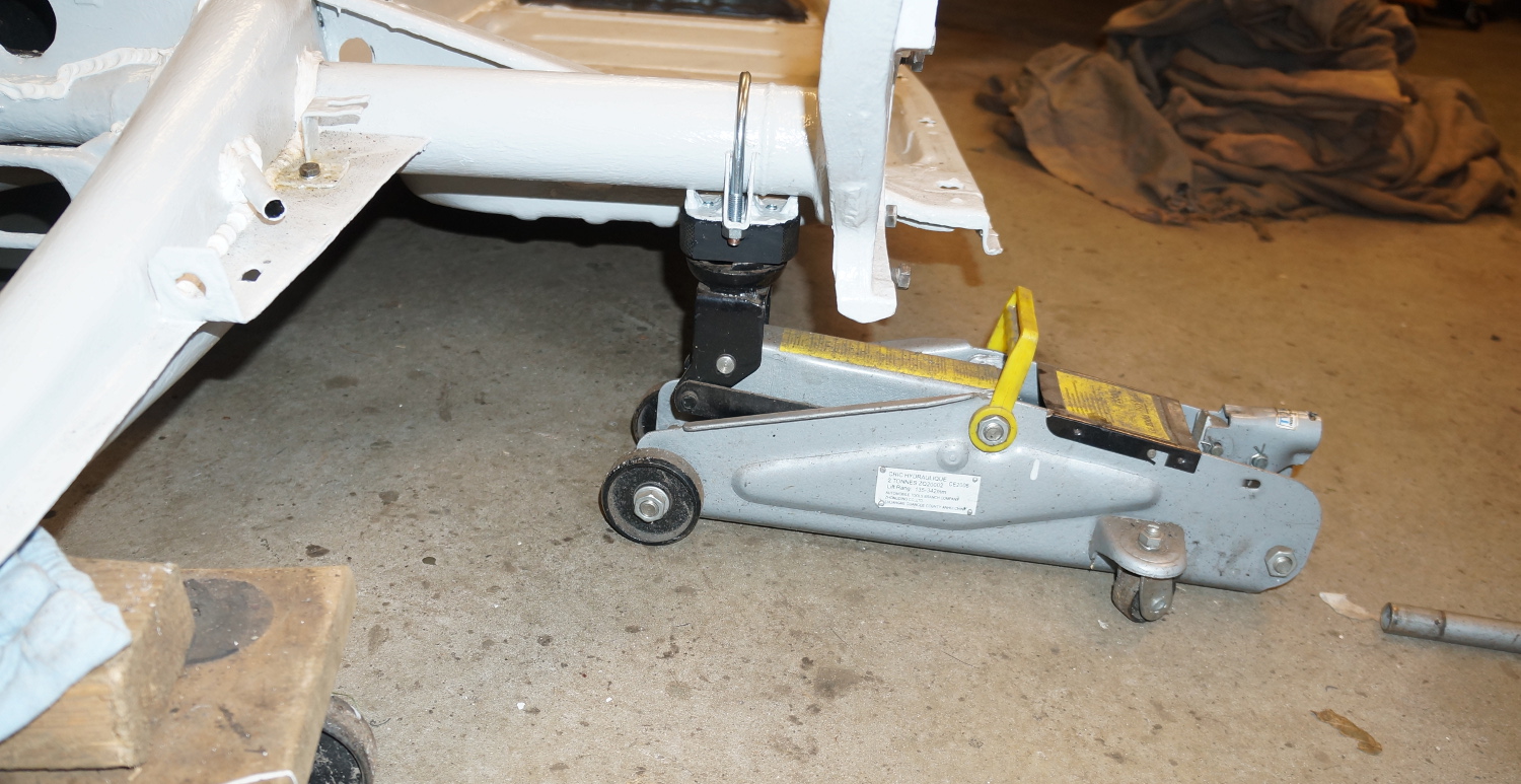

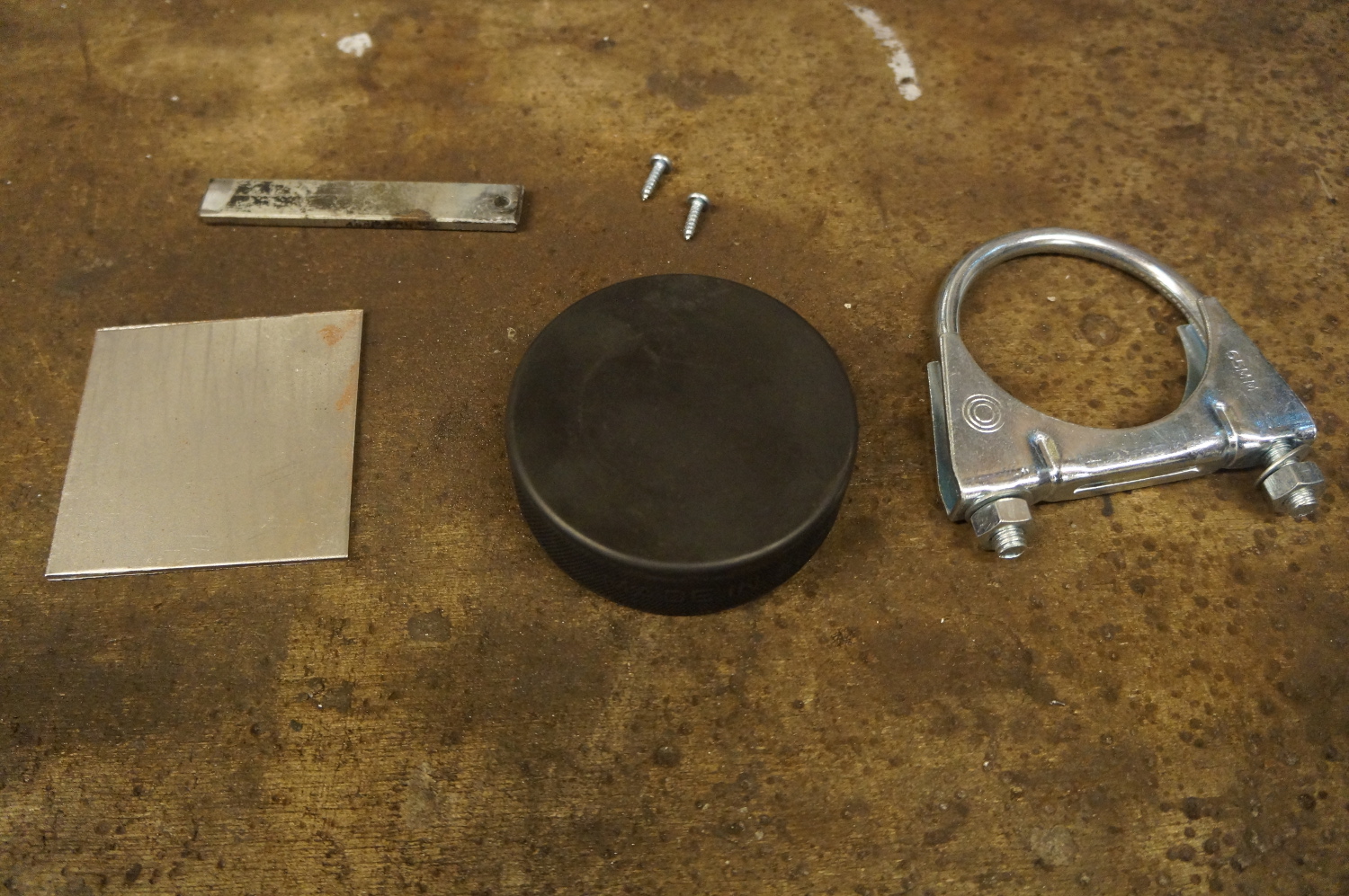

I've made jacking points out of a hockey puck and an exhaust clamp:
I removed the standard jacking pionts, because they are worthless and prone to rust. So I had to have an alternative.
This method might be a bit more difficult if you beetle is equiped with a rear swaybar.
