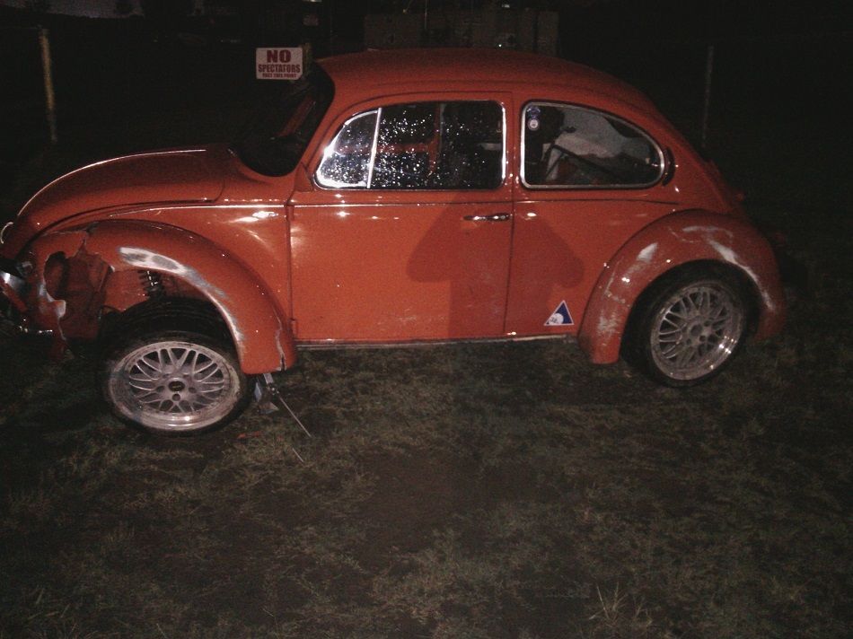

A few photos,

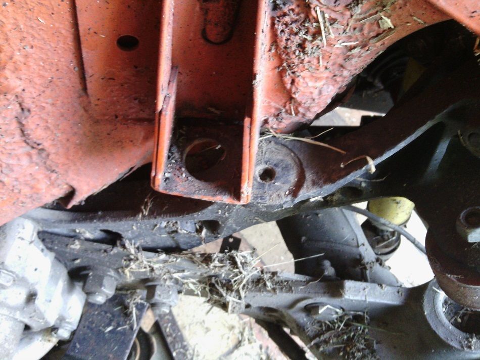

the impact moved the torsion bar housing back a bit

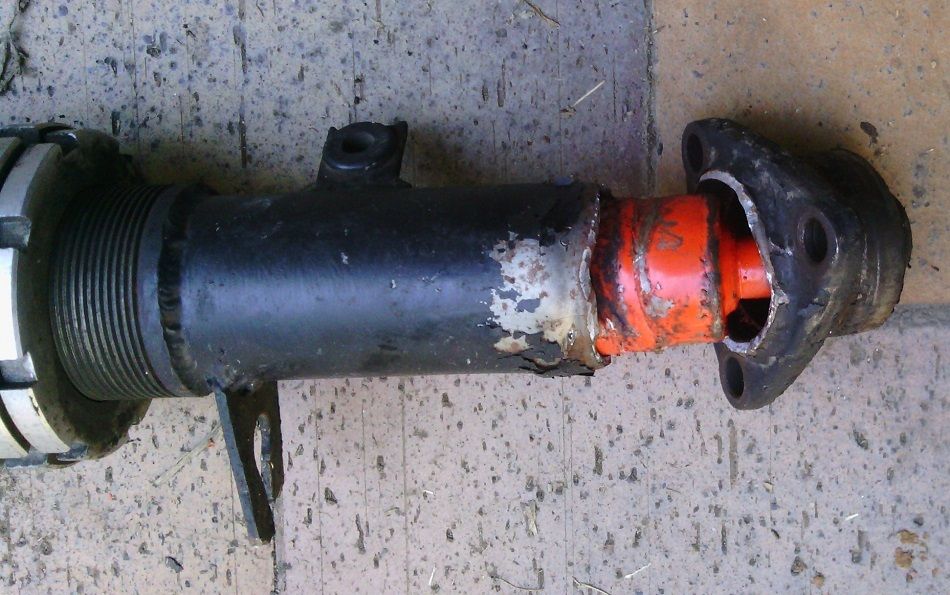

broke a brand new Koni
side view

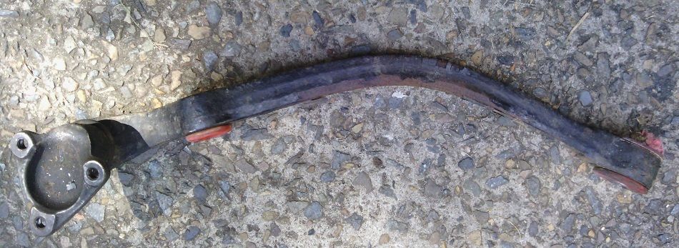

bent LCA

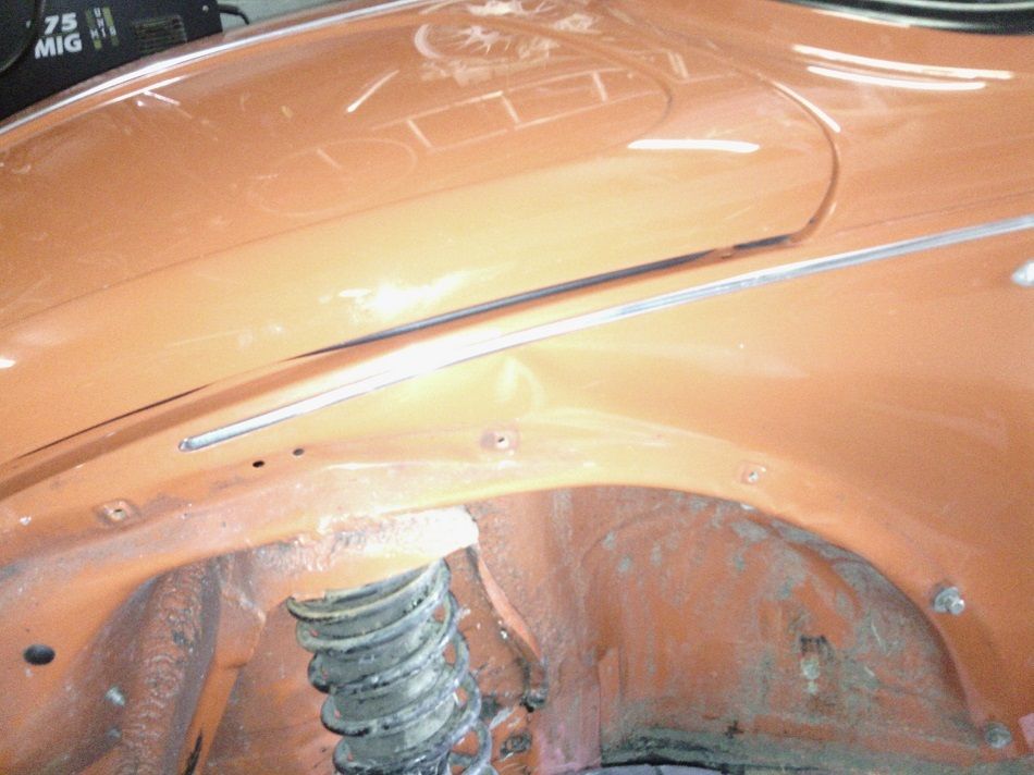

damage to front 1/4

damn this really sucks to see. best of luck with the repairs

Wow, that LCA is really bent.

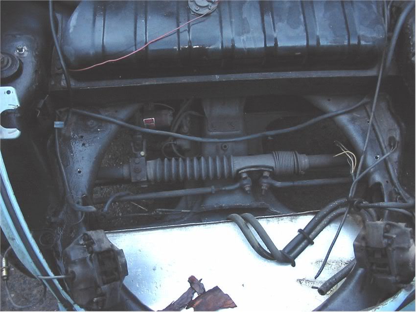

I was getting toe in when the car was jacked up and if I pushed the car up and down you could see the toe changing, so I refitted a tie rod re locater as seen in this picture and also unflipped my tie rod ends, it was perfect after I did this

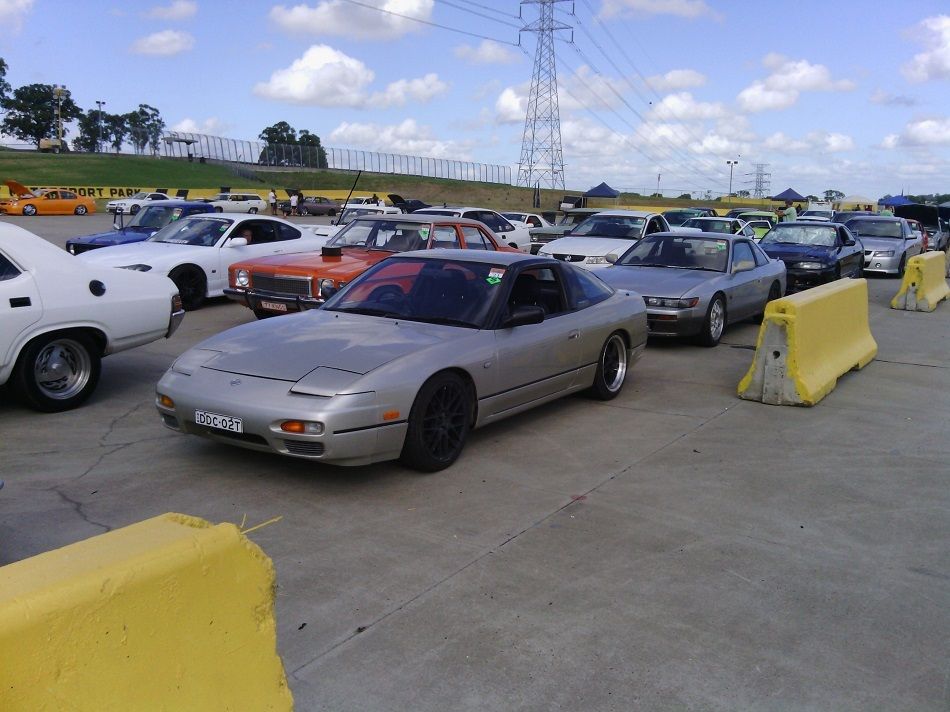

Powercruise was on this weekend in Sydney, I was going to take my Beetle to it but that wasn't going to happen, so my son found this little beauty for me, a Nissan 180 SX, came with a healthy SR20DET, 3 inch turbo back exhaust, two sets of wheels, new coil overs etc.
Fixed a few little issues, rego on Friday, did several cruise sessions and my son did about 3 hours of drifting with it and it didn't have any problems, its a bit gutless after my Beetle but its a really nice car to drive.
I plan to do a few speed events in it and my son is going to help me learn to drift

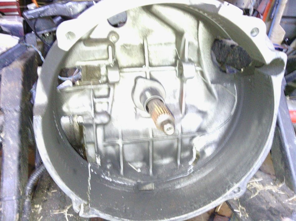

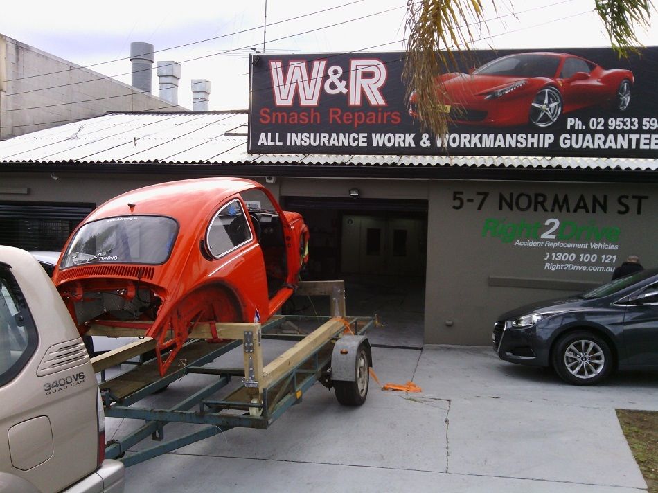

Car is at the panel shop now, working on the new chassis but I found another problem, the G50 bell housing is cracked very badly, anybody know anybody that might have one?
sorry about the crappy phone pics
  #270
Old May 23rd 2016, 05:15
The G50 bellhousing is not a seperate part like it is on a T2 transmission, so you basically need the total gearstack housing casing.
I'd say thats usually another tranny as the new Porsche part for that will surely be expensive. Maybe search for a G50 with an internal problem?
Very sorry to see the damage is more then sheetmetal :-(
