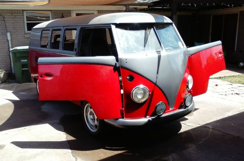

The front glass and seats back in. Cleaned up the front end with a good scrub and some clay treatment.

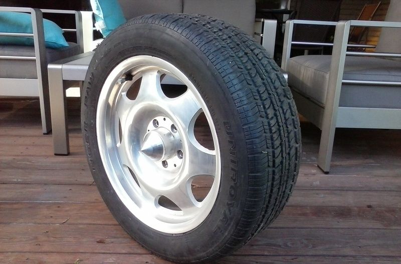

Anyhoo, got another center cap cut, polished up the wheel and mounted it.

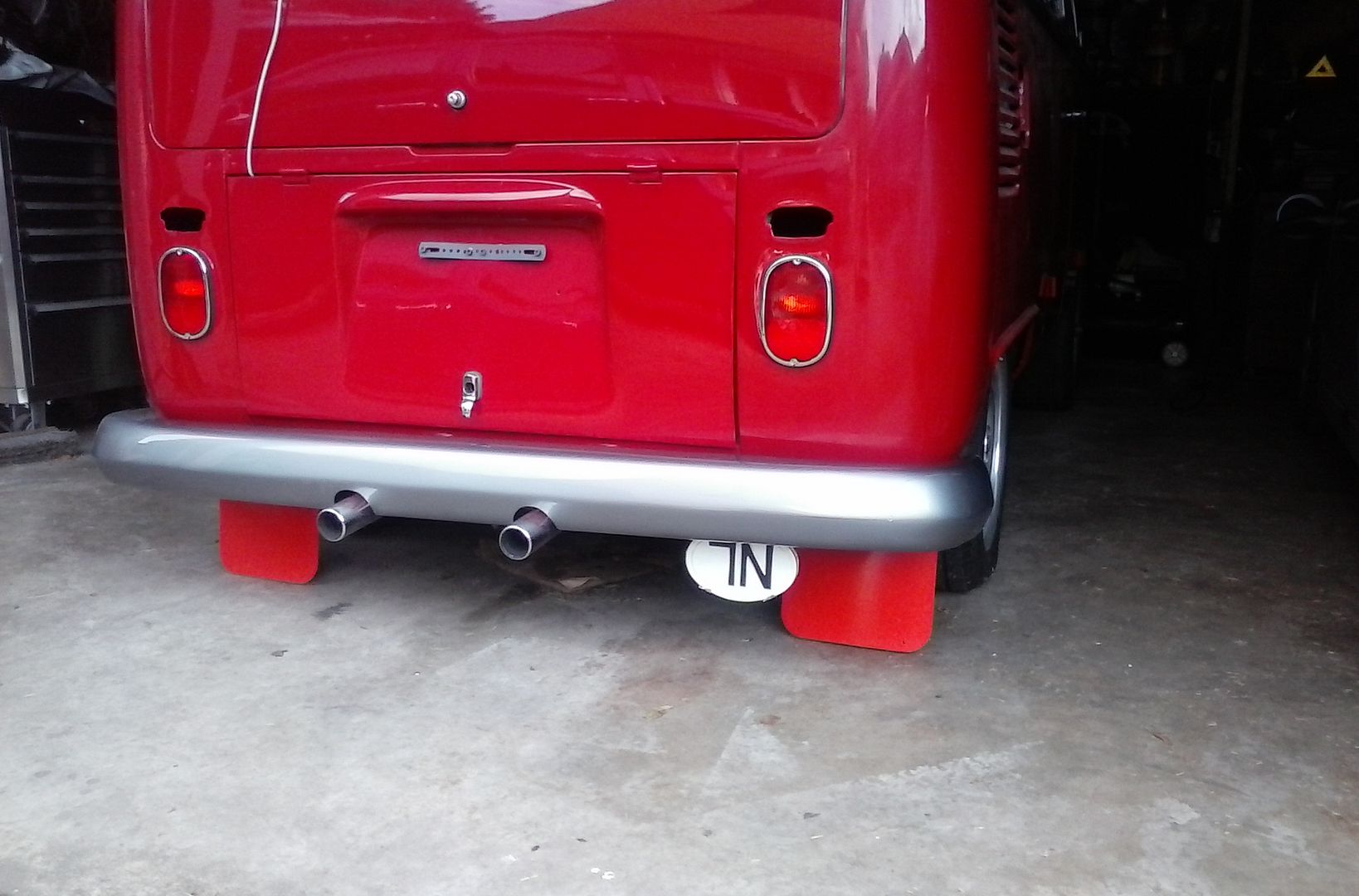

Putting all the parts and pieces back on her still. Got the bumper on and I had to adjust it four times. When I did the IRS swap it shifts the engine down and to the drivers' side about 10mm. I didn't think much of it until the tailpipes didn't line up with the cutouts (those were cut back when it was S/A).
Anyhoo, several "adjustments" to the brackets shifted everything over to where the pipes lined up.
Looking more like the old rally support vehicle she was (which she was twice back in 2001 for a Pro GT team in Arizona!).

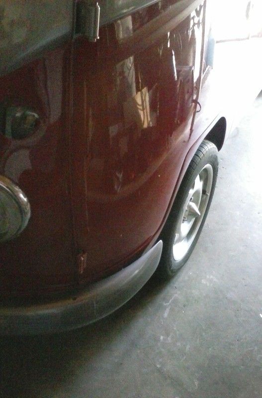

I lowered the front end a little. And by a little, I mean 5mm. I know this sounds tiny, but I'm not trying to slam it just make it level with the rear end. It's almost there I just need to do another 5mm. Also finished the last spike cap. I tried a different approach with the cutter and the finish turned out a lot smoother.
