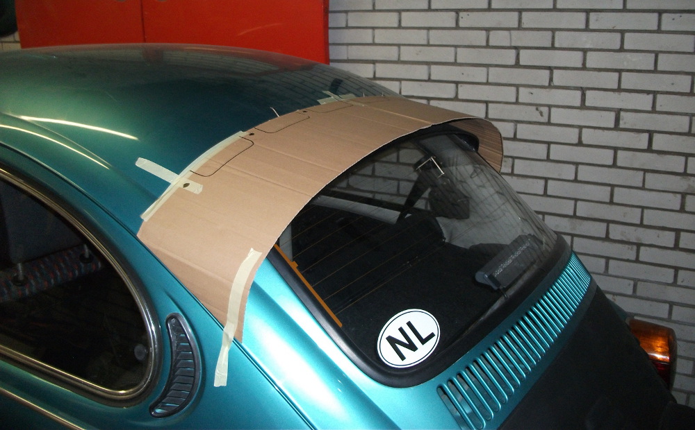

I took some measurements from pictures (mainly the one above), and scaled them to the right size. That gave me the rough measurements.
I used it to cut out a piece of cardboard and test fit the spoiler to my car. I had to trim the carboard several times to make it fit right.
But this was the result:

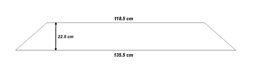

And these are the final measurements:

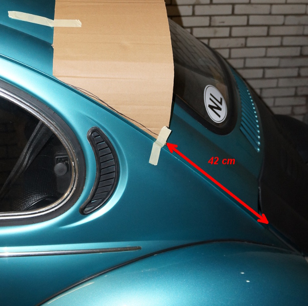

So, if you want to create your own, cut out a piece of cardboard with those measurements and test fit it to your car.
IMPORTANT: The distance between the end of the spoiler to the end of the raingutter is 42 cm. Like this:

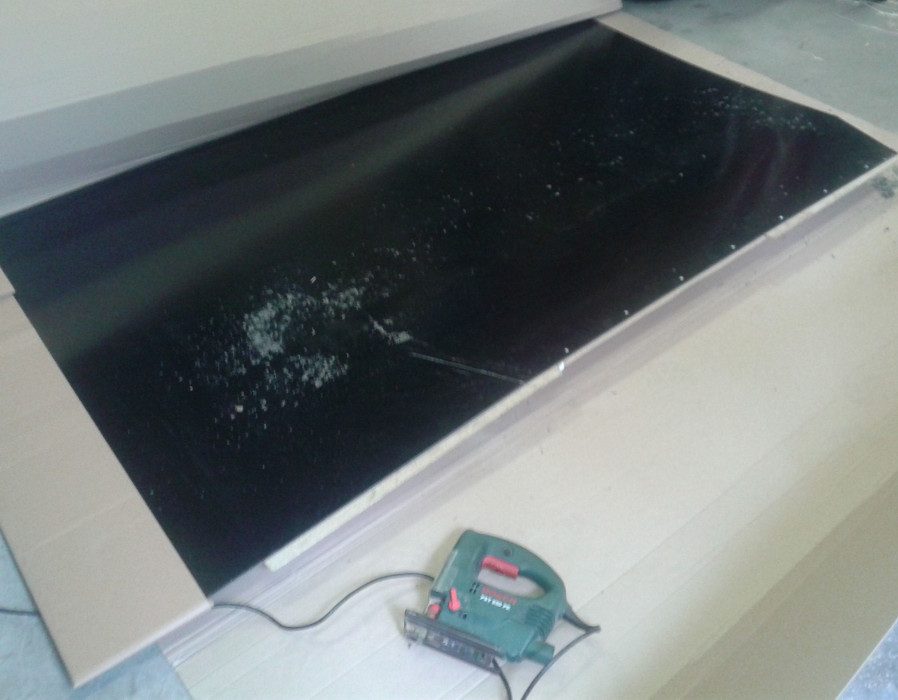

Then I orderd a huge sheet of plastic, it's 2000 by 1200 cm and 0.3 cm thick made of polystyreen.
I used the piece of cardboard as a template and marked where I had to cut it.
Because the plastic sheet is quite thin, it is difficult to cut. So I pre-drilled the mounting holes in the spoiler. These holes will be
where the spoiler is screwed to the roof. But now I use them to attach the sheet to a piece of chipboard wood I had lying around.
(crappy cellphone picture..)
You can see the 7 screws I used to screw the sheet to the chipboard.

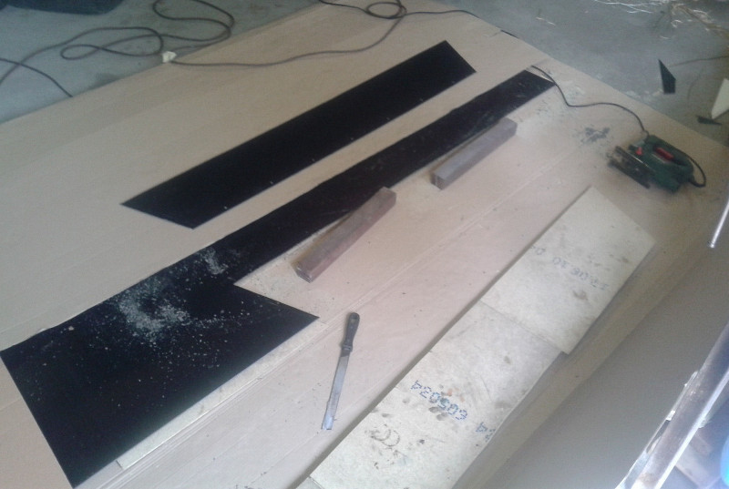

After that I sawed the sheet together with the chipboard with a jig saw.
A tip: if the plastic compagny can deliver the sheet pre-cut, order it in pieces of 22,5 cm. It will save you a lot of time.
(another crappy cellphone picture..)

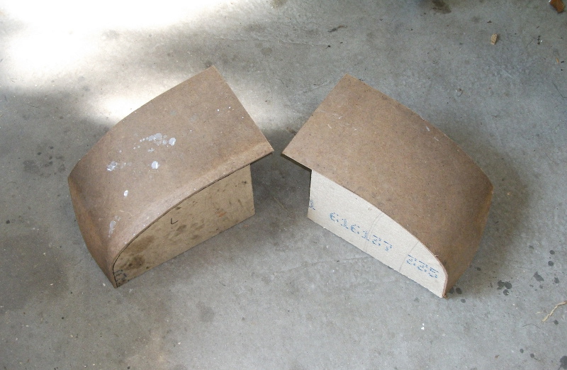

Then I copied the shape of the left en rear corner of the spoiler, using the cardboard (the template) version of the spoiler mounted with tape on the car.
I copied the roof (front) side and the rear (above rear window) side. I used another piece of cardboard on which I traced the shape with a marker on the rear.
On the front I cut a piece of cardboard to match the shape of the roof.
With that I made two molds that represented the shape of the spoiler ends.
Because the plastic sheet is 0.3 cm, I made them 0.3 cm "smaller".
Then I clamped one end of the cut out plastic to one of the molds and used a hot air gun to soften the plastic.
This takes some patience, the plastic gets soft at around 100 degrees Celcius, so slowly move the hot air gun over the plastic staring at the top.
Move it over the width of the spoiler until it falls into the shape and then proceed downwards until the plastic has the shape of the mold.

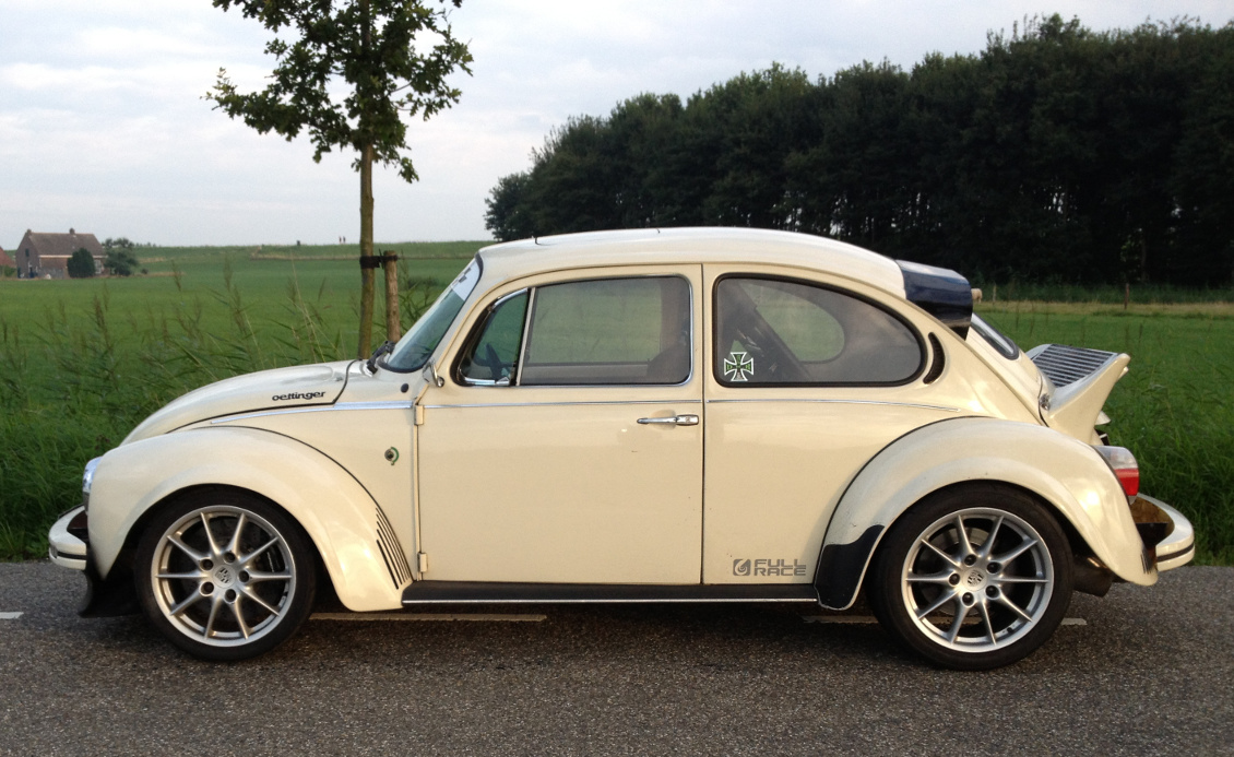

Now the spoiler can be mounted with screws through the roof in the front. But you will also have to fabricate some kind of brackets to hold the spoiler to the car at the rear, near the raingutters left and right.
This is the finished spoiler mounted to Wally's car:
