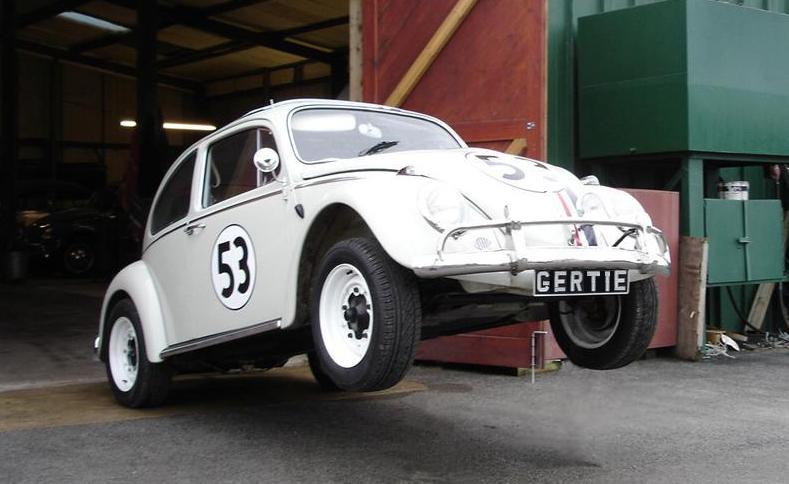

Old November 16th 2005, 22:44
thelazerviking's Avatar
thelazerviking thelazerviking is offline
Join Date: Oct 2005
Location: north jersey
Posts: 97
Red face
This plus this = this.

Old November 17th 2005, 13:14
oasis's Avatar
oasis oasis is offline
Location: timonium, md usa
Posts: 1,290
Gertie?
Aren't 92mm cylinders more risky than 90.5mm as vujade suggested?
