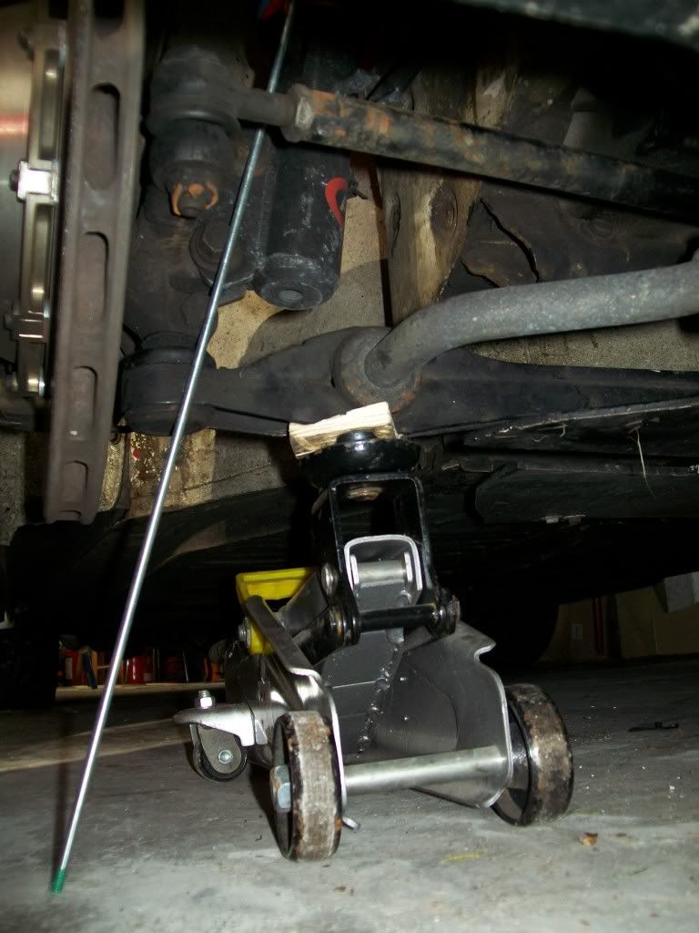

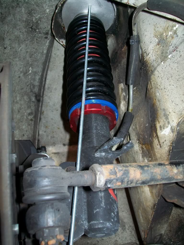

I actually did already indeed Rich, just like you described, but think I got the wrong points connected...

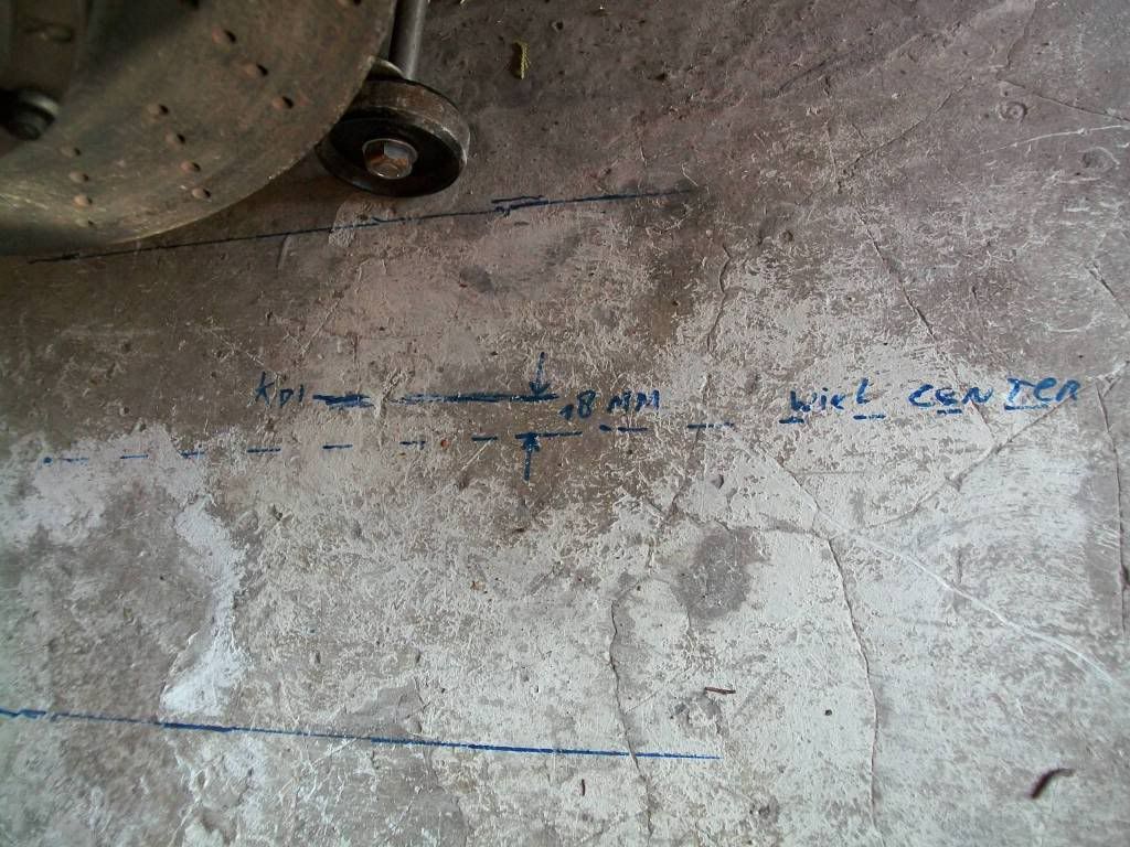

![]() With your answer I am a little confused even more what KPI and scrub radius is. MotoIQ had a great article about it the other day, using tie rod(?) and the lower ball joint of our Mc Pherson suspension system. Or is that just the upper and lower suspension point in the picture? Thought the upper one was the tie rod of the steering in the schematic? ![]() However, I took the line through the upper Mc Pherson strut connection with the body and the lower ball joint. Thought afterwards I did it wrong and it needed be through the tie rod and lower ball joint. Maybe I did it correct after all? Anyways, that gave me a scrub distance of +18mm. Still not sure now if that was correctly measured or not... Mike specified a distance between 3/4" and 3". With 18mm I am right at the lower bandwidth of that.. a bit more might help. I have a little room in the wheel arch, but I think 17" might be better for track driving anyways, mostly because of wheelweight you feel the negative effect of it most on the front. 7x17" is half an inch less wide and with a few mm more spacer, might just give that added scrub we're after? Tire centerline above is right against the rim contact path, which is somewhat confusing too. It doesn't seem to be the exact tire centerline..? I'll post some of the pics I took of that tonight. Last edited by Wally; October 24th 2011 at 11:00. |

Wally: you did it correctly for a strut front end, however that image you just posted is how to measure on a double wishbnoe front end (ie the tie rod/steering arm is not shown).
one thing to note also, just in case: you need to draw the line through the centres of the actual ball joints, not the centre at the base as this can throw the measurement out quite a bit (probably just how you have the bar leaning in the picture). From what I've read -ve scrub gives more of a stabilising effect with a bit less feedback. The problem with going too close to zero is that it can flip between +ve and -ve depending on caster and the dynamic effects of the suspension giving very unstable feeling...

Thanks Rich; yeah, the double wishbone suspension must have confused me
![]() The rod was held through the imaginary center of the lower ball-joint, but my wide angle lens doesn't picture everything -in line- so to say. The lower pic was taken with the front high, afterwards for the actual measurement, I have taken the nose to the cars normal height of course. So, its either much more positive or very negative scrub for better steering stability?? I though that 'some' positive scrub was the goal? |

The 'norm' for RWD is +ve scrub, I'd guess 10-30mm or so? Too much gives to much kick back through the steering. I equate it to +ve giving an 'oversteer-like' kick back through and -ve as an understeer kick through the car during disturbances (ie safe). Like many of these things, it's finding a set-up that works for you as there are so many variables!
