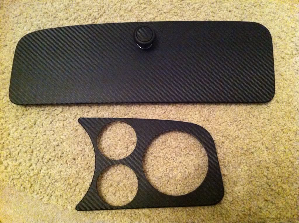

Alright - I couldn't leave it for the evening, but since it's cold in the garage, and I dislocated my thumb at the weekend (don't ask...!) so can't wield a spanner, what better way to spend the evening than in the kitchen with some Carbon Wrap...

looks good. hey, even with a non-working thumb your getting something done still. may not be a lot, but progress IS progress.

Very nice, reminds me of the interior on my old E46 ZHP package 330..
Very cool
