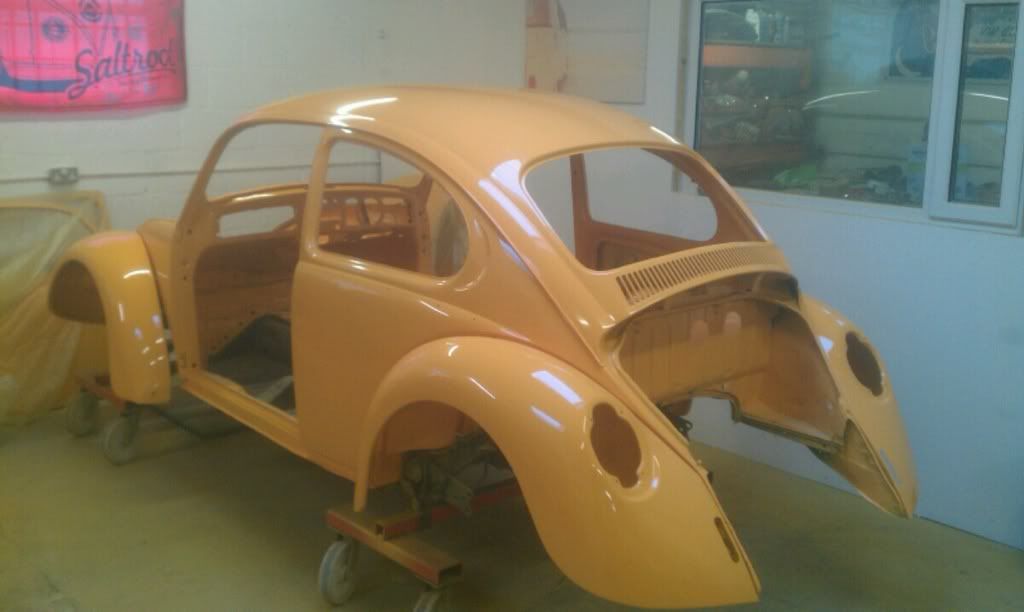

Just got a pic from the paint shop :-)

So, today was THE DAY to go and collect the shell from the paintshop - boy was I excited. So dropped the kids off at school and shot into town to pick up the trailer. Off up the motorway in the Passat with a very rumbly wheel bearing (must fix that...) and I pulled in to the yard - there it was, resplendent in its new shiny yellow paint! Outside, inside, and underneath!
The WRONG Yellow...
Remember, i am the second owner, having bought it in completely unadulterated condition in 1986. I gave it a exterior respray in original colour myself in 1993 - i consider I am pretty hot on knowing L16M at a glance, and this was wrong. In the boot of the Passat I had one of the original bonnet hinges that had never been re-painted, and it's quite a different colour to what is now on the shell.
Bugger...
I can see how it happened - since the regulations changed about paint formulation a few years ago, not all the old colours have been re-formulated into the new mixing systems, especially those that were limited usage, and a one-year-only special edition colour falls squarely in the rare camp. Plugging L16M Tunis Yellow into the paint systems draws a blank on both ICI and Sikkens. It seems the paint supplier cross-referenced it against another mix to get the fourmula, and somehow it went wrong - too Yellow, not Mustardy enough.
So that was an expensive day - trailer hire & 150 miles of fuel, and a day off work, all for nothing.
He is totally mortified and embarrassed & unhesitatingly said he will sort it out. We just need to sort the mix. I tried another paint supplier on the way home and they found it on their system but no formula listed - looks like we will end up getting it matched to the inside of the glove-box lid which is original paint and not sun-bleached. I think some places can scan the paint, while another says they have a "Resident Genius of Colour" - time to pay him a visit I think...
Oh well, these things happen...

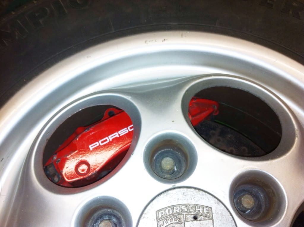

So with a little bit of work the 996 calipers fit BoxsterS rear discs on Steel 944 rear arms inside the 6x15" Teledial
The mounts I made ages ago for standard 944 rear discs have been spaced & flipped - I may make new adapters or just run with these spaced. This is with a 10mm wheels spacer - hopefully that will clear the bodywork. I'll wait until I have tried it all in the chassis/shell before giving it all a good clean and repaint. I need to do something to centre the BoxsterS disc properly as the centre of the Boxster disc is larger than the 944 disc, so at the moment it just locates on the wheel studs so can move a couple of mm each time I have it apart. I think a centring ring between the two should do it and then drill/tap the hub to use the retaining screw hole in the disc
