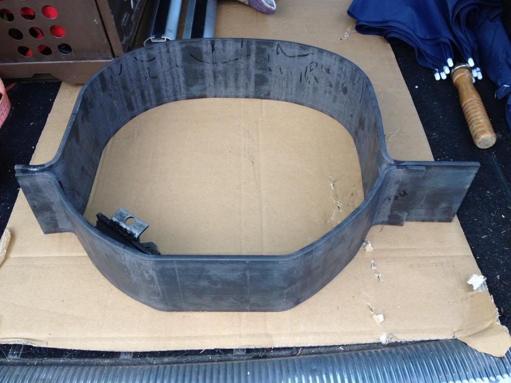

For most tracks, these trans straps are gonna be mandatory. We just made one from 6mm steel, 4 inches wide...

Walter, is your's a clutch scatter shield?

Spanner: yeah, scatter shield for clutch or flywheel retention is the correct term
