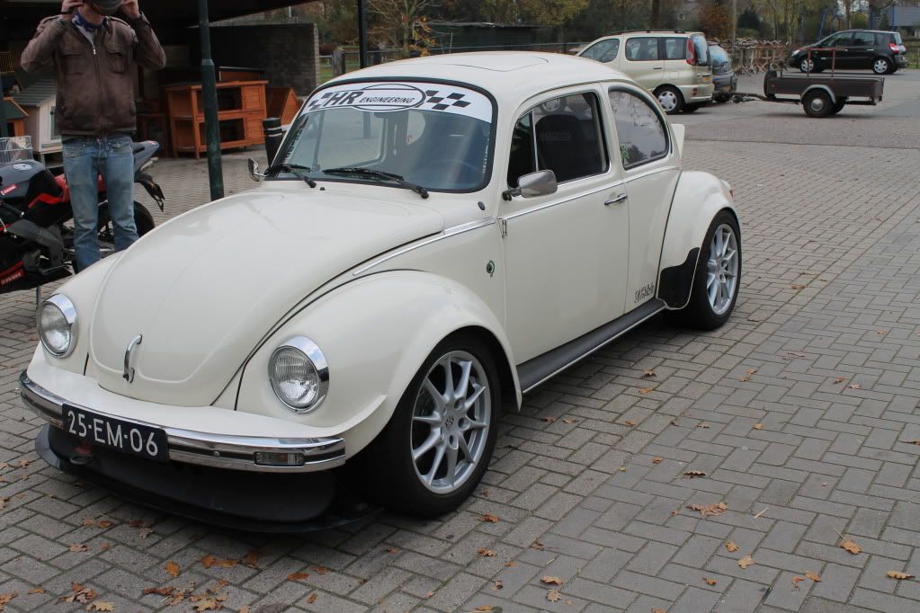

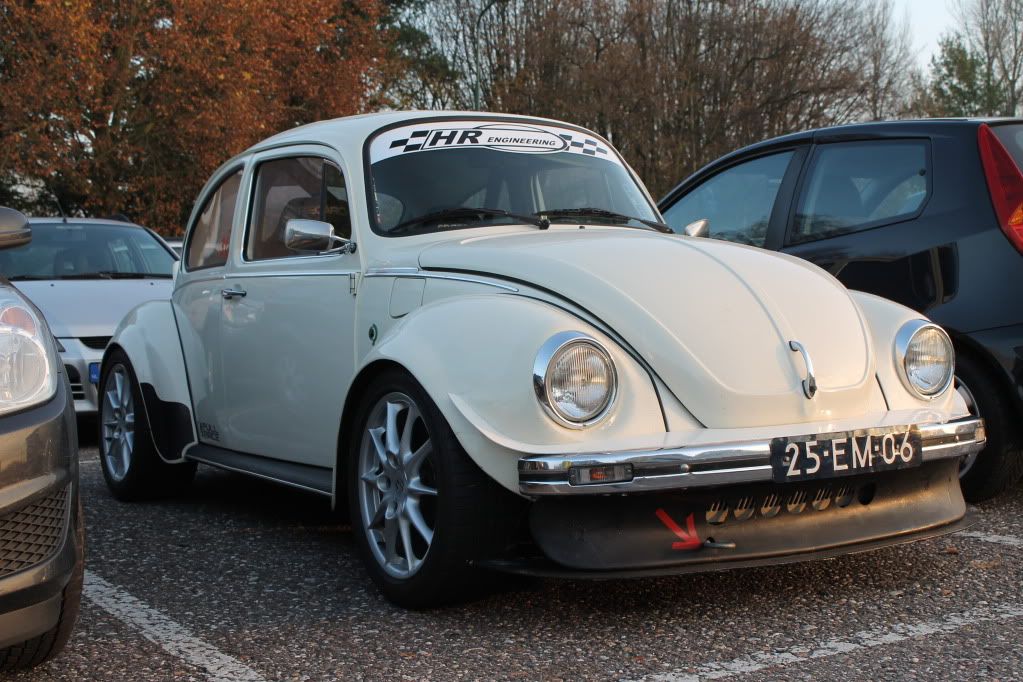

Picked up a set of 9Jx17 / 7Jx17 with 205/50/17 M+S on the front.
These front wheels weighted 3,7 kg less per wheel then my current front wheels (!!).
  #1028
Old November 11th 2011, 13:20
Some pics of the new wheels, still with snow tires, 50 series even in front
Yes, its definitely function over form: the gold wheels looked much more spectacular, but I think these will drive better and that what counts for me.
Went for a drive with my girl today to do some groceries, which was quality time times two

Great pics Wally ! The bumper cover mod looks very subtle .. I didin't even notice it the first time I looked
You car looks much more "tame" with the new wheels , looking forward to the race reports.
  #1030
Old November 11th 2011, 13:57
Yeah and thats not necessarily a bad thing when you also drive on the road imo.
But no worries, I think a 40-series front tire lateron and maybe a little turning down of the strut will give it even more aero benefit and probably also a little less 'tame' look .

Good choice of wheels. Your car will be more agile with these wheels and I agree it makes the car look tame, a tweek with the suspension and tyres will get back that agressive look (those goldies did look good though but it is not all about looks when you are out on the track).
